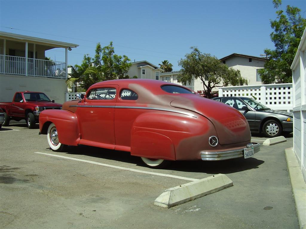

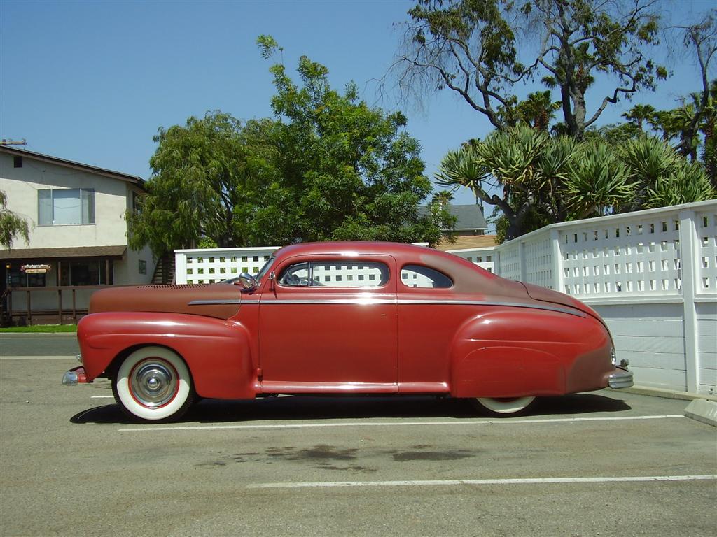

    I liked the stance of that one. It came from the east coast. I had it only for a few month, because I was too deep into my 41 Plymouth project, so it went to Europe.

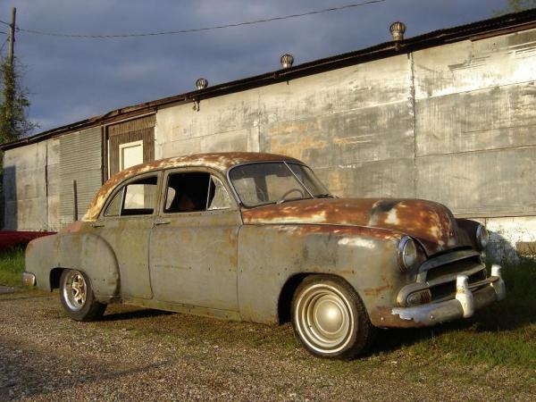

    Here are some old pics of my 51 Chevy(she's been on hold for about a year). Chopped 4 inches, step notched rear rails with de-arched leafs/blocks, cut coils/stepped lower control arms, stock drivetrain, 52 Olds bumper/grill,.........soon to have molded merc style grill shell, slightly stretched quarters(not sure on the tail lights yet), 52 olds rear bumper, shaved handles, some sort of side trim, etc..........trying to keep all major components pre 55.

    :eek:MORE PLEASE......

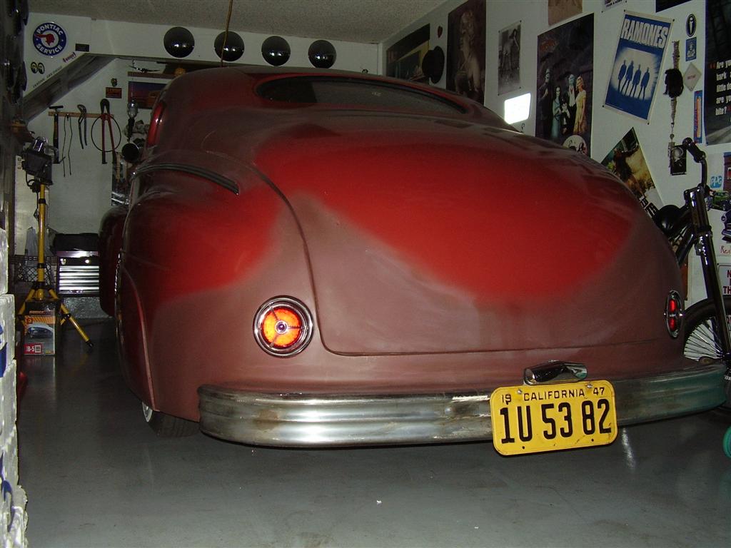

    This is just stunning right here,I love this car from what I can see of the pictures.Any rear shots of this one ? So it went to Europe:(?? The car just flat out has the look.

    I think this chop is as good as it gets.Not many getting done these days with this look......so gorgeous.What is the history of this car,when was it built?

    My friend Trader Joe here in San Diego bought it from a guy at the eastcoast.I only know the seller put a lot of time and love into that 47. It had an early 283 small block with manual trans. It had some parts like the alternator that were not really all the way trad., but overall the car had soul and went the right direction. Fun to drive while looking through the chopped windshield. It had working wipers, you wouldn't find that here in So Cal...
    I'm not the biggest fan of the 50 Lincoln taillights on that specific car, not too bad tho. I reupholstered the seats in Tijuana, hard to see in the pics.
    After it got to Germany the buyer went broke, put it on Ebay without reserve and had to let it go for like nothing... A friend from Germany mailed me a pic. It's flat black... I don't know... anyway, I think its in good hands.
    That red paintjob was kinda cool, it was single stage with just a few fine metallics in it, weird, but neat. Maybe the seller is on the Hamb and can tell more.
