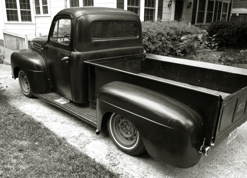

  6. Mine has the stock front axle, de-arched front springs and some leafs removed in back.
