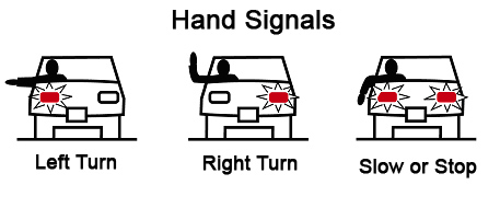

    They're not internationally universal, though. I believe in the Commonwealth tradition - mostly right-hand drive - it's right hand extended for right turn, right hand raised for stop, and right hand downwards and "stirring the pot" counterclockwise for left turn. So few people nowadays know what the hand signals mean at all, never mind what they mean in the specific country they're in.
