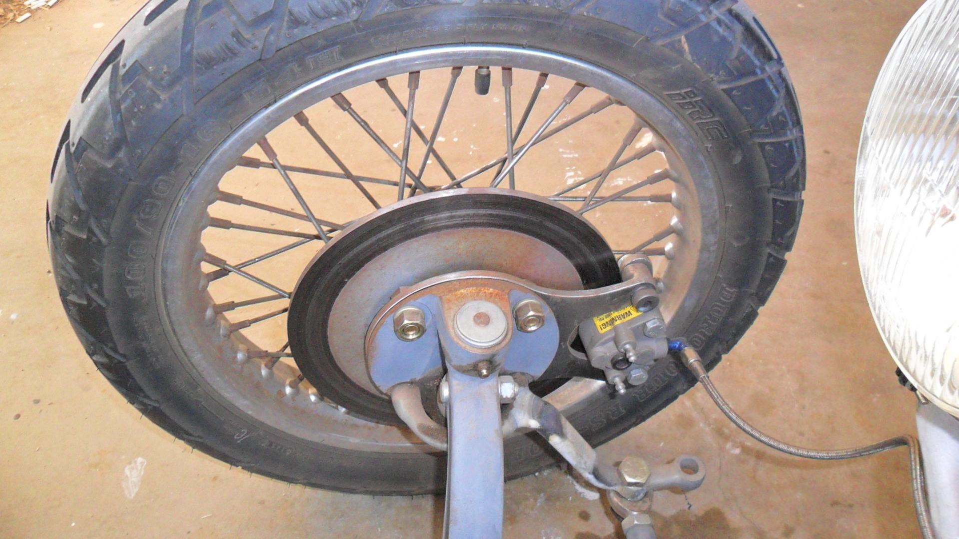

    "Those without sin cast the first stone". Yes Whip that is an alternator on a middle '60s Mustang engine in my roadster. Like I said I've been spending 30+ years trying to take the ugly and maybe the '60s out of my roadster. I like most, built my roadster on a shoestring and the Mustang engine was a gift. That's the engine I put the most milage on. It wasn't until the turn of the century that I decided to go all '50s and close up those "ugly gaps" between the engine and firewall and radiator. I guess I just have it in for disk brakes and independent front suspension on a fenderless hot rod.

    With the solid rotors and such, if ya squint and hold your tongue just right you could almost claim they were roundy round stuff from the early sixties as long as the calipers weren't too modern looking. There were a few Gas Cl*** drag cars out of the era that ran discs up front too. Ohio George Montgomery's Willys is the first to come to mind. Hurst/Airheart was making their "175" caliper by about that time, and it is ideal for cycle spoke type wheels. The Bantam that I posted on my thread yesterday has a pair of 175s on small solid rotors on brackets I made earlier this year and the thing stops on a dime. Oh, and by the way, AirHeart has reissued their 175 calipers in magnesium! These are a brand new pair.

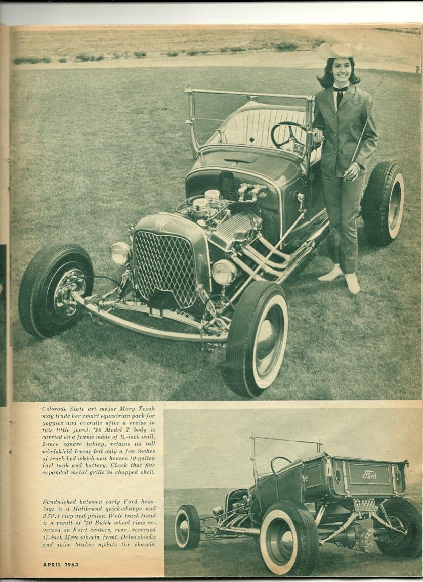

    If I was more tech savy I'd do it myself, but can somebody scan a pic of Bob Moore's T in the April '63 HRM please. (one of the first color pics in HRM) It was one of the the cars that got me so excited I couldn't think about anything else, and I've been afflicted for about 50 years now. Just talked to him yesterday, and yes, he is still building T's and is as talented as anybody I've ever met.

    Here ya go! Sorry, been a hectic week.

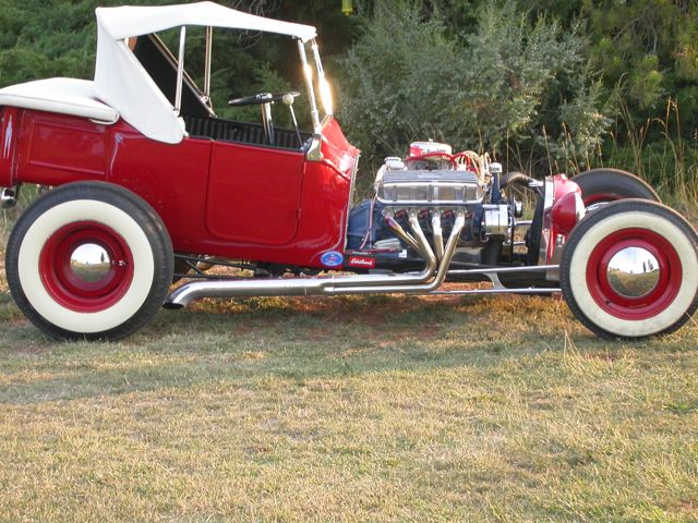

    That is an awesome looking T and to me it is not only traditional but a family tradition! Enjoy the car and if you have a thread here I need to look for on this bucket. I love the back story on it and the hunt you both went through twice.
    Louvers question on the steering of the car. I see the side exit for steering. Can you tell me why this is done on a lot of T's?
    I like the looks of it on this bucket but would like to know more about the setup and why they are done this way.

    That's cowl steering, RT. Yes, it's a very cool way of steering and frees up a whole lot of foot room. Not seen on a lot of T Buckets and I can't explain why. I imagine the bracing to hold the box would take up a little room, but could it be that much? Someone will chime in I'm sure.

    t bucket front end.jpg guys the picture of the front end on this T bucket.... i am correct by thinking that the spring hanger is a original from a wishbone cut off, smoothed out and put on backwards to create the spring behind set up right? I have been doing a ton of homework lately for my up coming T project and i think this is something i want to do.

    Yes, you are right! That's a really good way to do it as long as you keep it close to the wishbone's seem between the forging and the tubular section. If ya go too far back, things get to weak too quick, and even worse start looking "Rat Roddy". This deal sets you up though so you can have nice stance and not need a dropped axle.

    Thanks louvers!
    Is that a traditional-enough T for you guys? This was built in '61-'62, before many 'gl*** bodies if any were available. Real Henry steel, built by a 18-19 year old in a very tight 1 car garage with minimum tools. Brand new 409 bought in a crate. It's still in Pueblo, Co. but now unrecognizable.

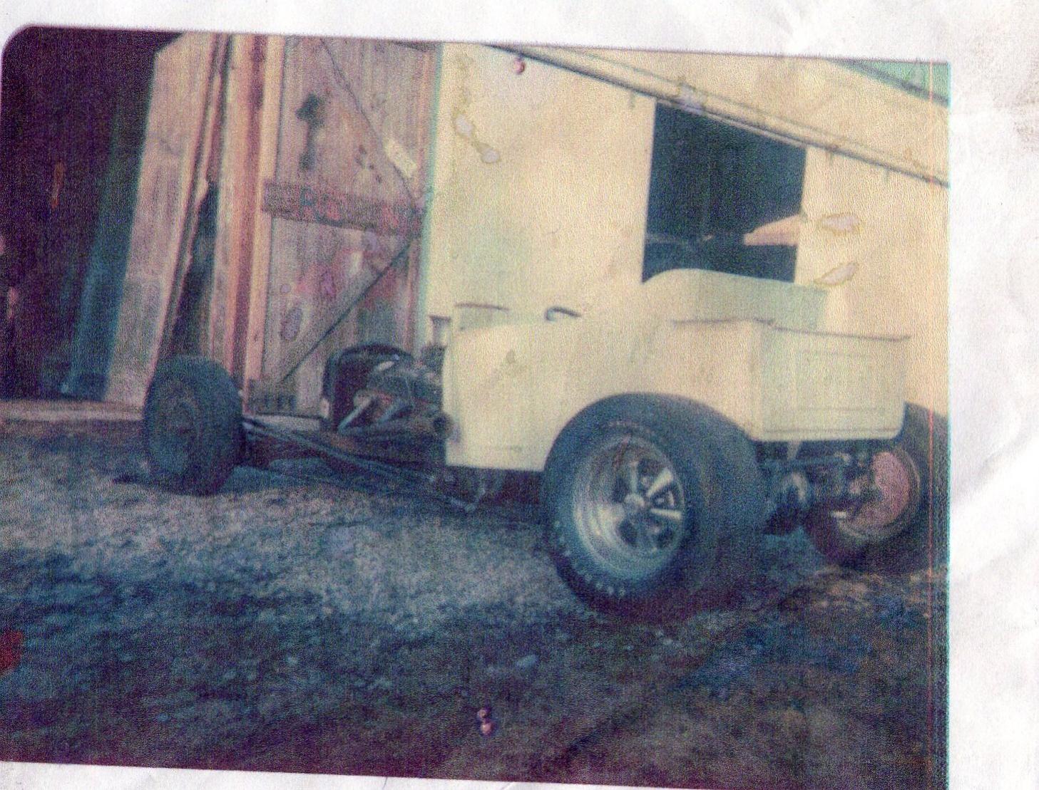

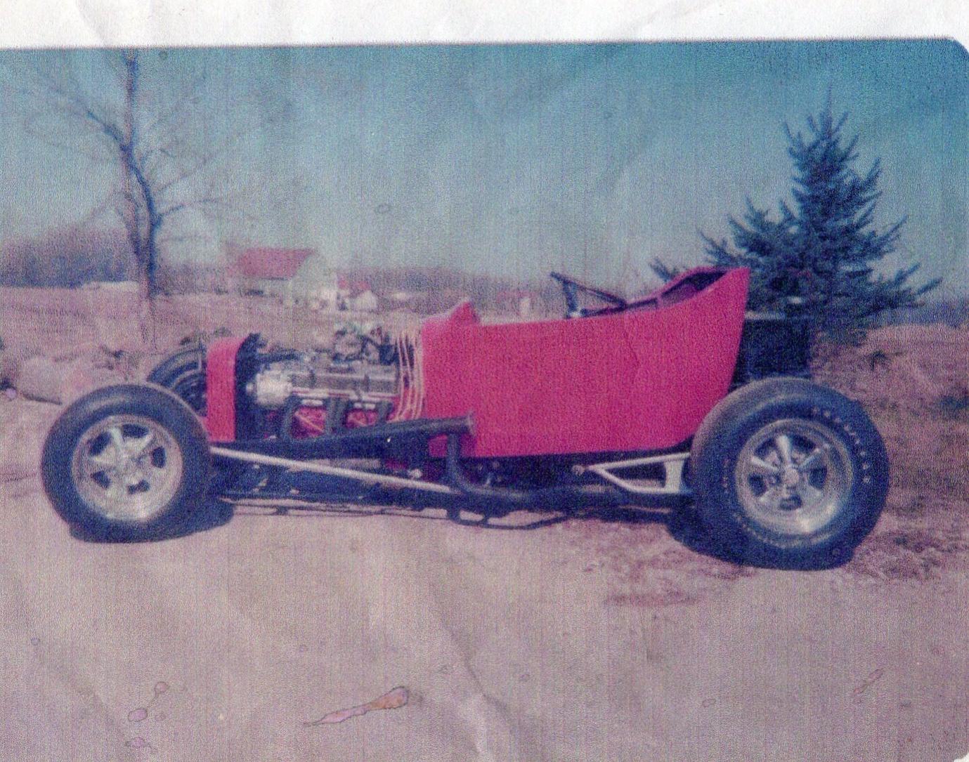

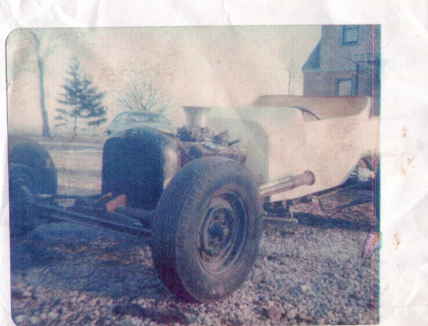

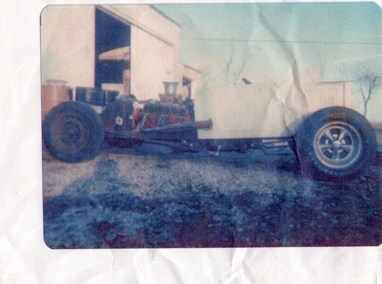

    here are some very early build pics of my T bucket and its story that i told you guys above... dig that kooky roll bar and are those Ford falcon tail lights? ill have to ask my dad.... I just found these pics in a old book, i havent seen them in years..

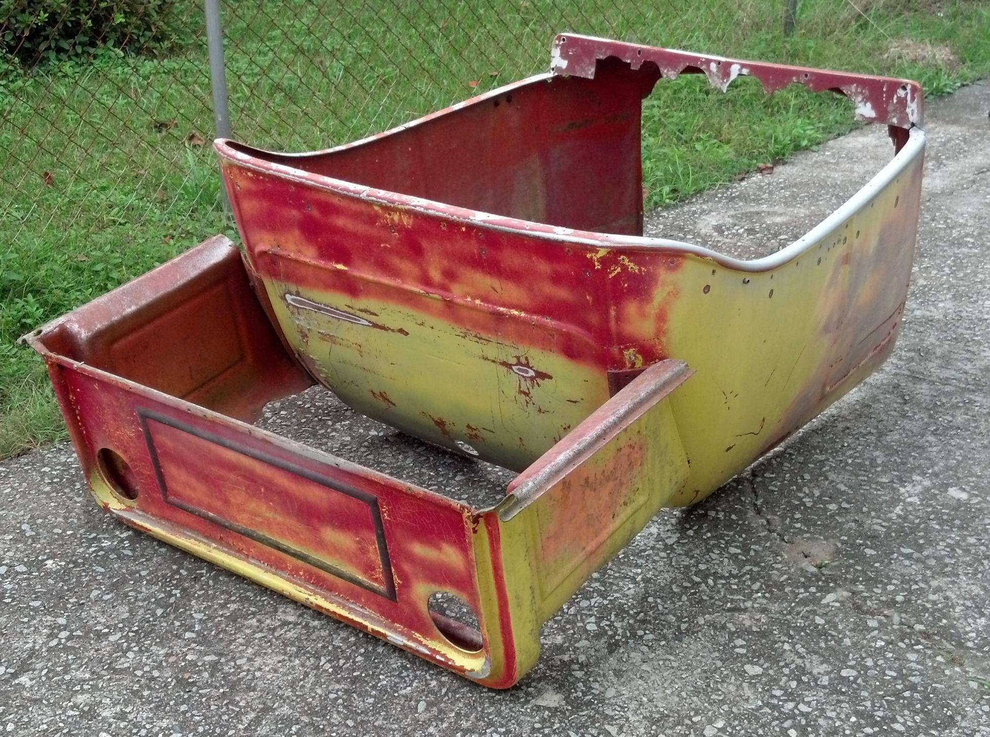

    I had one of the first Total Performance T buckets....about '75? and it was a blast. I'm 6-2" and had no problems with it. Just got this body for 200. It's been hacked on and multiple paint jobs, but anyone recognize the maker? Seems like the holes for the taillights were factory cut for maybe Pontiac tail lights.

    I'd vote for a Total Performance body, before he opened Total ,Mickey Lauria built and supplied bodies for the Bird Engineering kits.
