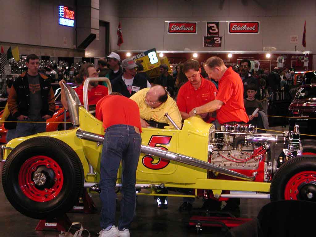

    Joined: Nov 5, 2005
    Posts: 528
    jalopy45
    The #5 car was ***embled at the 2001 Portland Roadster Show and driven out sunday.
