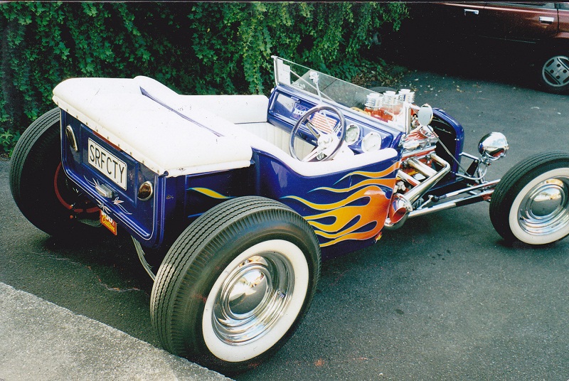

  14. Surf City
    Joined: Mar 5, 2012
    Posts: 469
    Surf City
    Here's mine, from New Zealand.
    Inspired by a tiny black and white pic of Dan Collins' bucket in a Custom Rodder around the mid 90's, (This thread is the only other pics I've ever seen of it), and obviously greatly influenced by Norm's and Tommy's.
    Mine's on a 90 inch wheelbase so everything is fairly compact.
    It's been sitting in storage at my folk's place for the past 6 years, but it's coming home soon!:D
    Need to find some better pics...

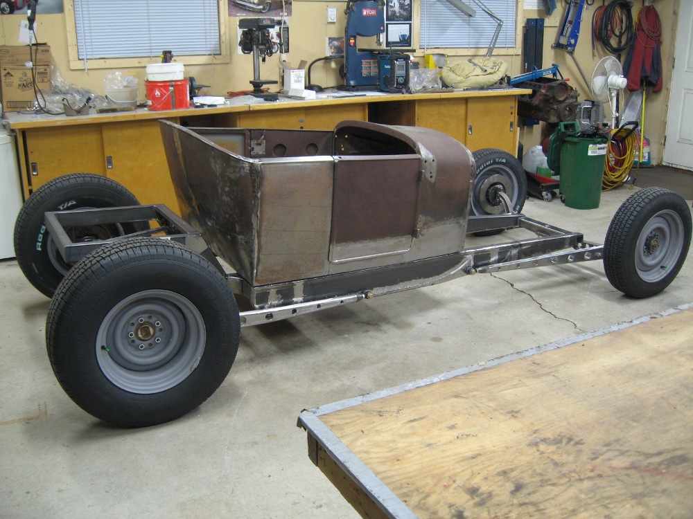

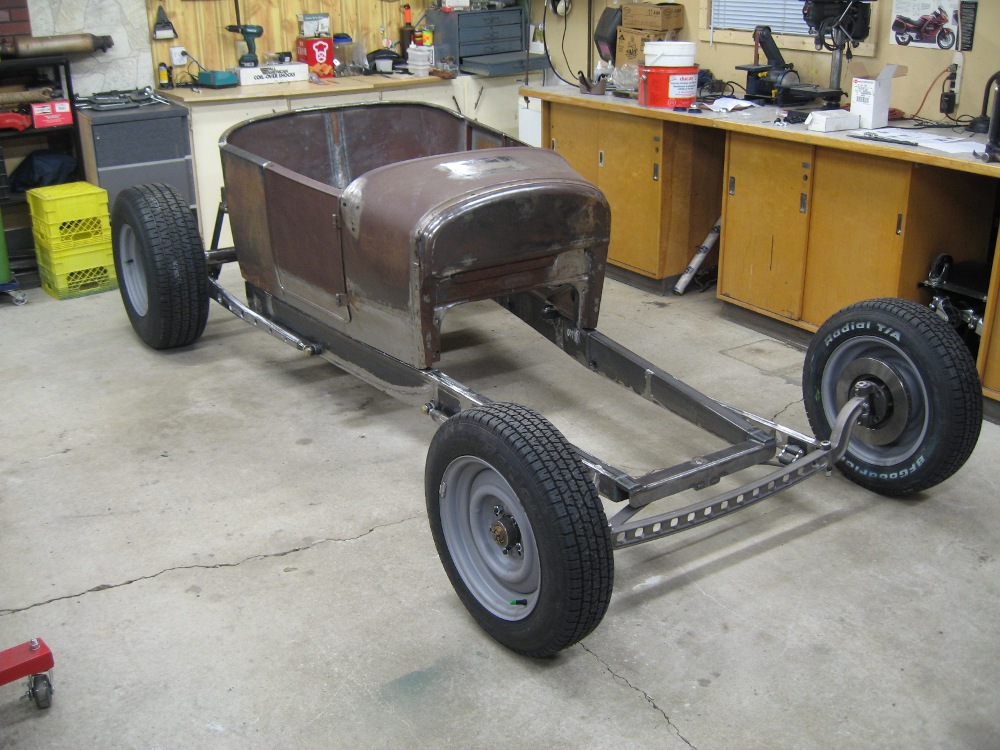

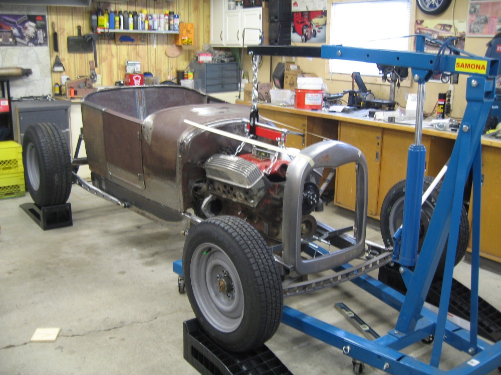

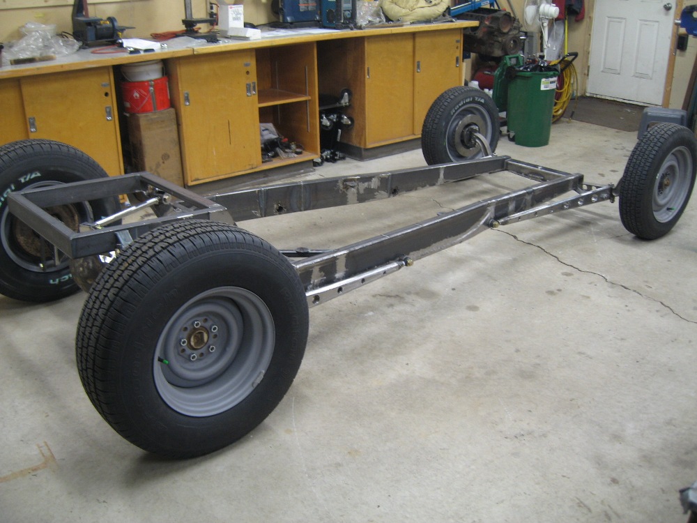

  19. Blue One
    Joined: Feb 6, 2010
    Posts: 11,517
    Blue One
    from Alberta
    Ok, so we have all the experts weighing in on T proportions.
    I took the front of a T touring and stretched it 4" behind the doors.
    I have it mounted hi-boy style on a 32 style ch***is I fabricated that follows the shape of the body.
    The rear of the body is the rear of the touring widened to the outside edges of the body and with the top lip reformed to eliminate the tack strip and match the body sides behind the doors.
    I am going to run about a 36" bed on the rear.
    Here are a few pictures of the project so far in various stages, one with the Y block 312 in place.
    So, did I get it close to right ? I like it :)
