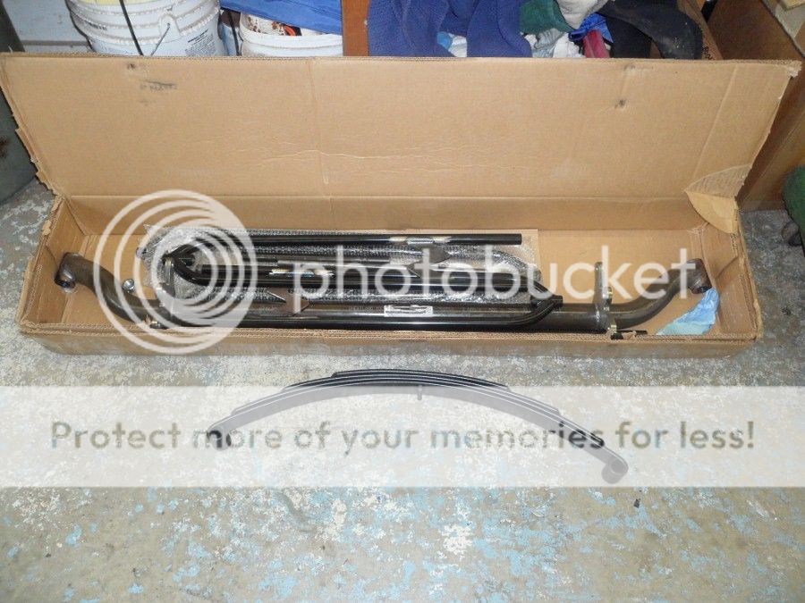

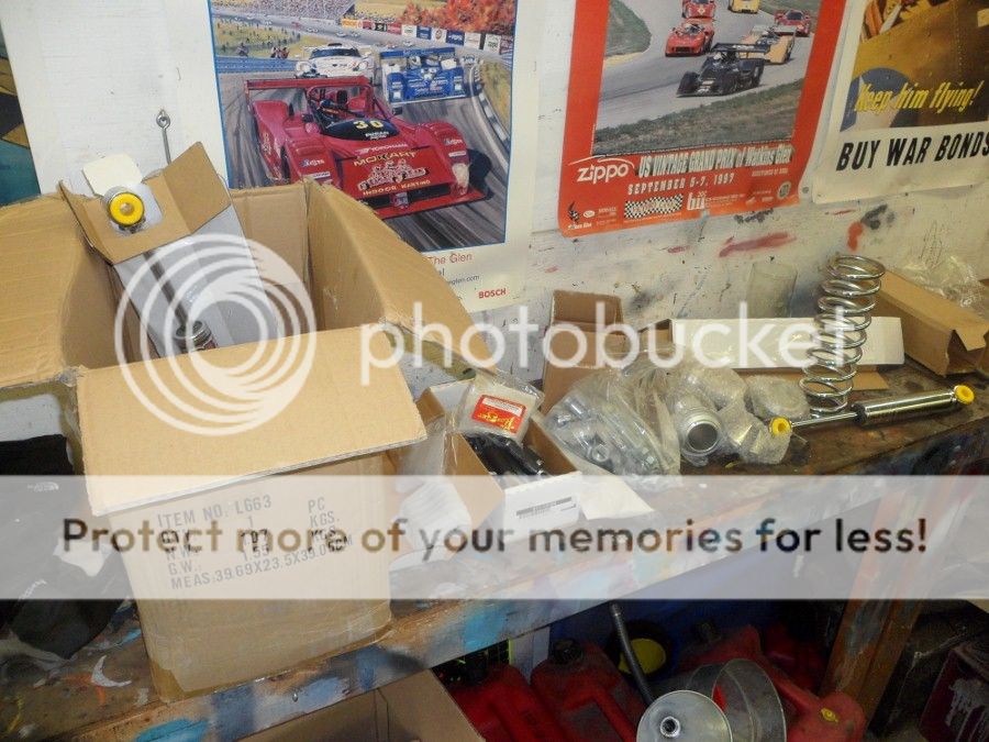

    I ordered from Spirit Industries. I'm also getting stuff from other places, but the bulk of it is coming from them. It's supposed to rain here, so unloading two 300lb. skids without a forklift should be fun! Let the games begin!

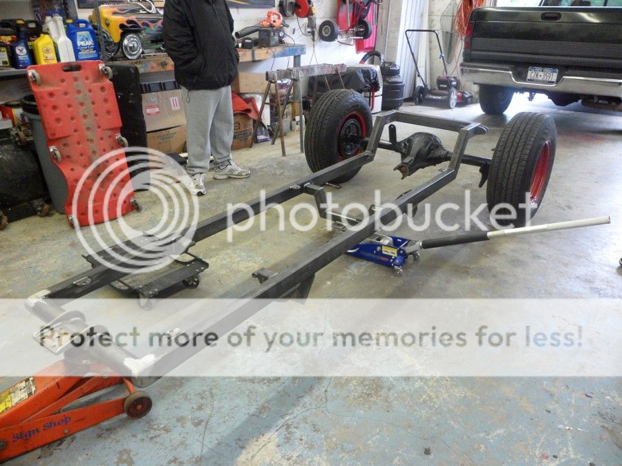

    The parts arrived in good condition and are very nice overall. I started to mock it up to see how it will look. I am waiting on a few more parts to make it a roller. Hopefully within a week or so I should have most of the ch***is components mocked up. I had it made with a 2" drop built in to the front spring perch and rear kick up. I'll start a new build thread soon.

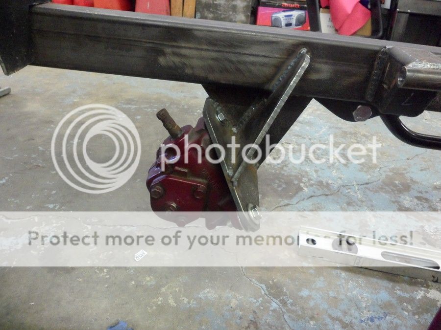

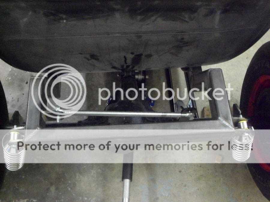

    I made a little more progress. I am continuing to mock up and pre fit things so I can get a feel for how it will go together. There are a few things I will need to modify, but overall I think it will be a relatively easy and fun build.
    New 15x5 front wheels.
    My ebay Vega box fits

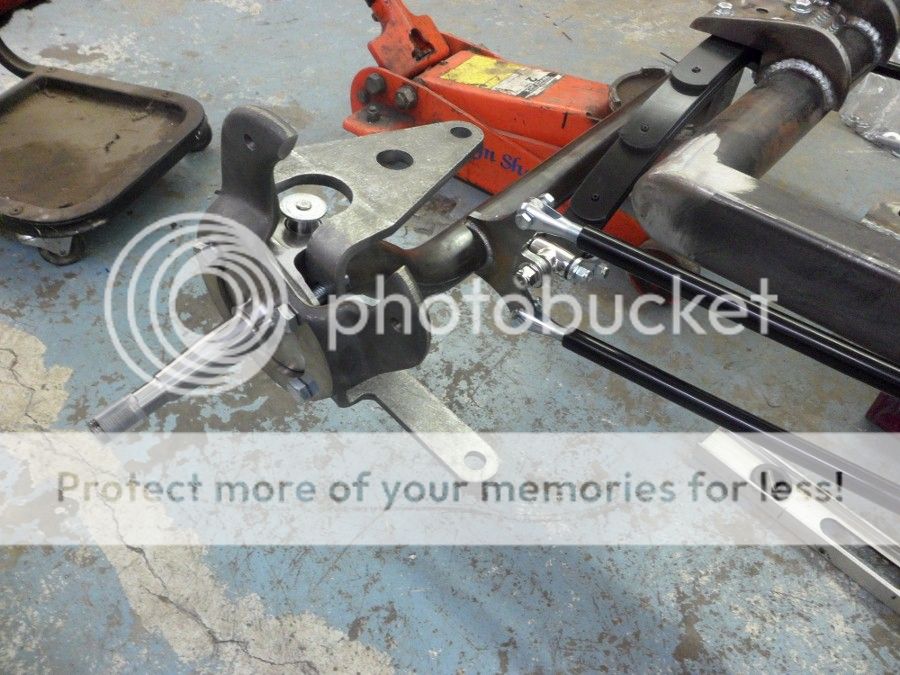

    I won't be able to use this upper steering arm
    Getting a feel for how it will look...

    Just a thought---have you tried turning the steering arm 180* to see if it fits that way???

    Why can't you use the steering arm?
    Also where did you get the wheels? I have been stuck on what to use and get for wheels. I really want that skinny look up front and back.
    I really like the frame and the mock up on it. I need to look for a steering box and I"m seeing a few companies with them and one is using something other then a vega box.
    Keep us posted and the rod looks great man.

    I did, yes thanks. It won't work that way either. It hits the axle. I will have to use one that goes straight out from the mounting holes to get the drag link more level with the hairpins.

    The steering arm is offset too high which makes the drag link not parallel with the hairpins (radius rods), which it needs to be for proper suspension geometry.

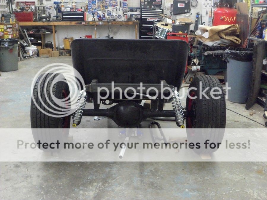

    Hey can you get shots of the rear end?
