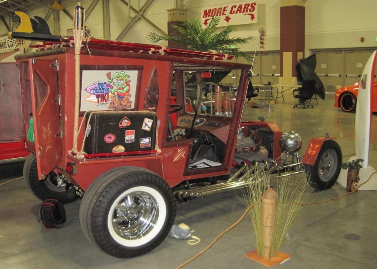

    here is some inspiration
  11. CoronetRTguy
    Joined: Dec 26, 2012
    Posts: 826
    CoronetRTguy
    I'm in love!
    Can we get some details gege? Do you have a thread on it.
  12. GEGE
    Joined: May 18, 2002
    Posts: 212
    GEGE
    I did have a thread "mystery car update".
    It was on the cover of rod and custom in the april issue.
    I will post some other pictures of things you can't see in those pictures.

    gege I was just saying to myself that looks like the car in Rod & Custom. Your car is the one that sent me on the hunt for info on building a T bucket man.
    I have always loved them at car shows and when I started looking at doing a Hot Rod project I thought about a T but wasn't sure and then when I saw that issue and your Bucket I knew I wanted to build one.
    Very cool car and I would love to build one like it!

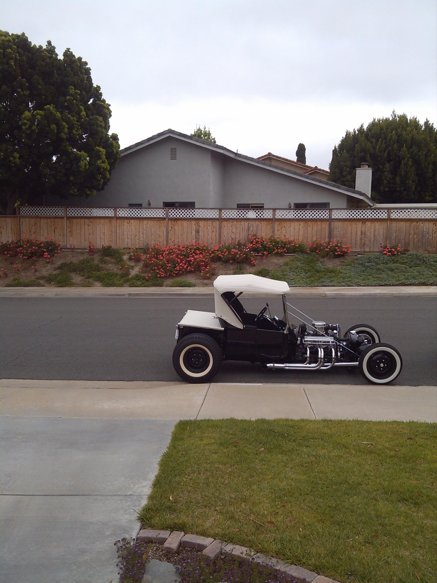

    I built this for under 5 grand. mostly made or scrounged parts.
