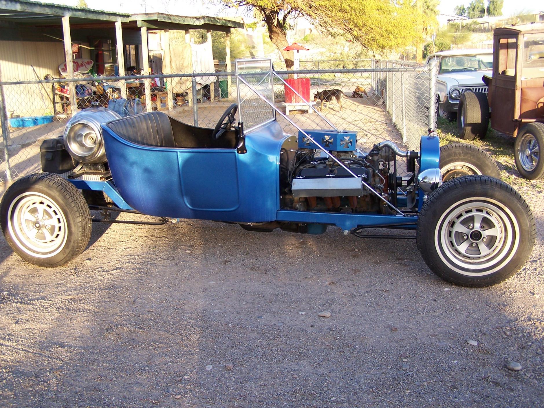

    Wheeling and dealing and making most of it myself, right around $1500 into this, ad actually if you reverse count the money I made off of parting out the parts car I bought for the engine, I have zero dollars into it.

    Proof that a guy can build a damned decent looking car and not break the bank.
    And a guy can wheel and deal a few upgrades as time and opportunity provides.
