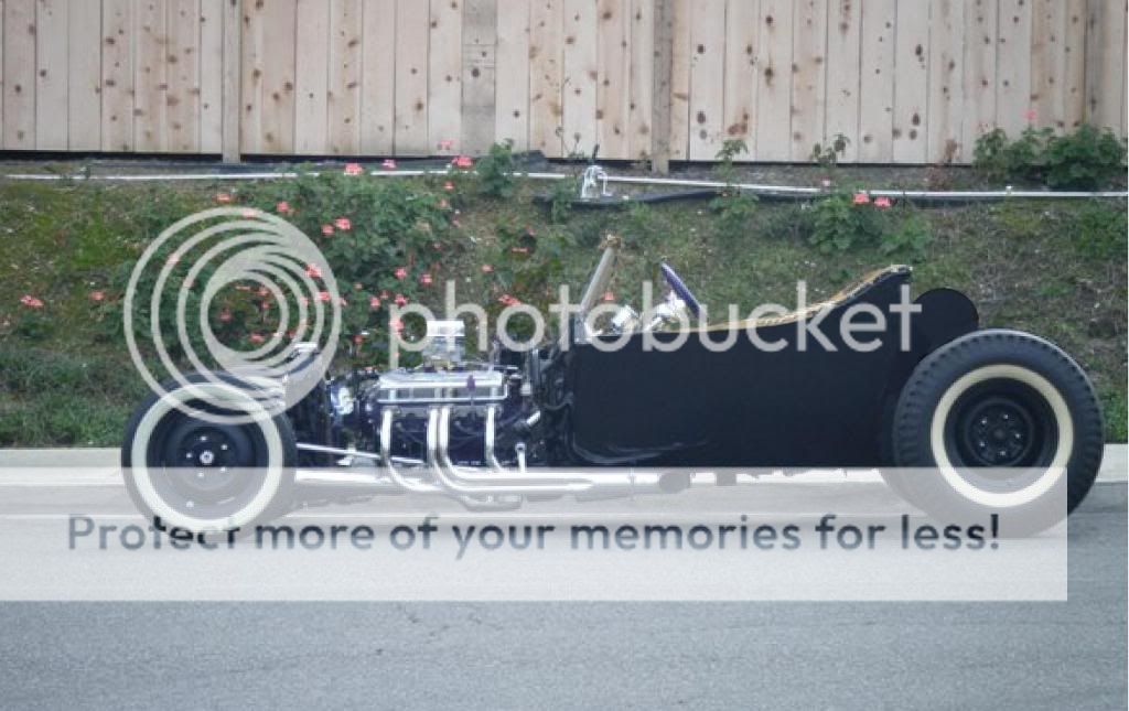

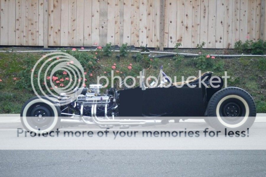

  10. prewarpete
    Joined: Jul 19, 2011
    Posts: 45
    prewarpete
    I built a traditional T for under 5 grand, but you have to do everything yourself and use old parts and score great deals.

    Wow! THAT is killer awesome!! Did you build that frame? That is beautiful!

    I love that car and that is the look I want. Wish finding old bodies where as easy as it used to be.

    pete-love the roadster, looks great! Anymore pics?
