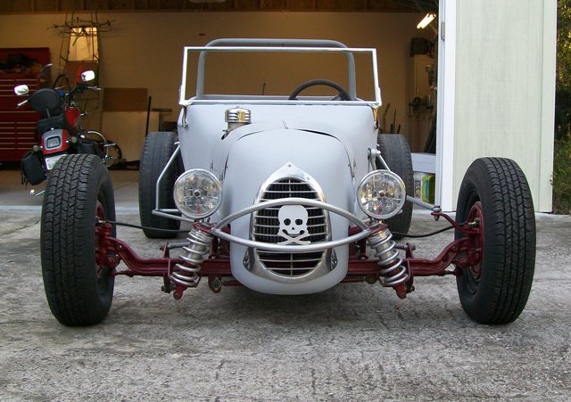

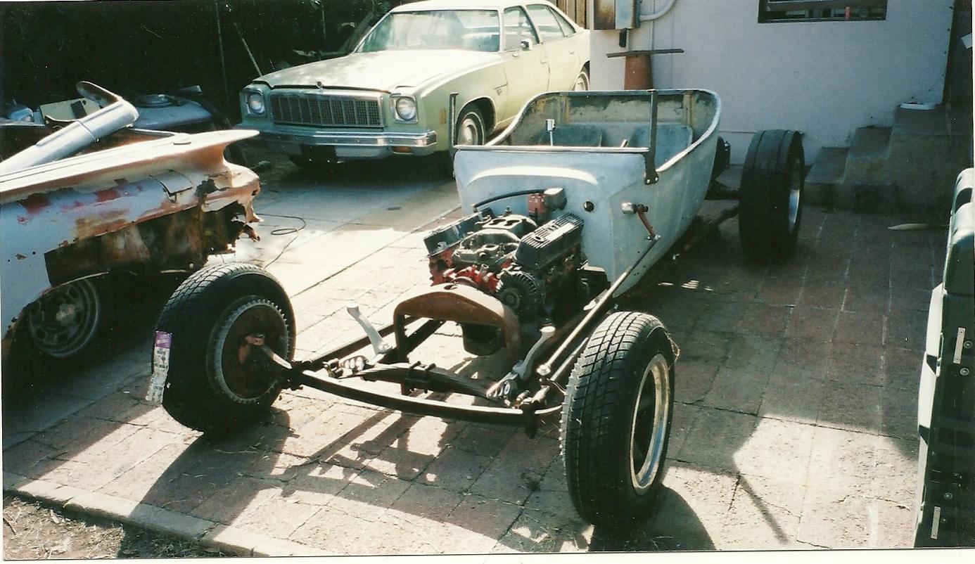

    OK, I just discovered this thread and I'm a little late to the discussion. I built my first T-bucket frame in 1968 out of 4 inch channel iron. Since then I have built over 20 frames for everything from Model-A's to a '48 Anglia and at least 7 T-buckets. All but two of them were built from 2 x 3 or 2 x 4 .120 wall tubing. I enjoy ch***is construction, so I don't buy anything that I can fabricate myself. I am currently building a Track-T with a round tube frame. You can see the step-by-step build thread here: http://www.clubhotrod.com/hot-rod-talk/30400-another-build-thread-yep-my-track-style-t.html. I am using a Dave Koorey body with a 6-inch extended cowl.
    Here's my 2-cents-worth - First, don't get discouraged over the small matter of the rear end. You have options here... You don't need that 4.11 rear end; a T-bucket is so light (typically 1600 - 1800 pounds) you can use just about any gear ratio. Opt for something with a higher ratio which is more common and therefore cheaper. The coupe in my avatar weighs about 2600 pounds and has a 2.79 rear gear (8 inch Ford from a Maverick). It still launches pretty hard and it gets good gas mileage. I got that rear for $100. Take a look at Toyota pickup rears - they come in a bunch of different ratios, many are limited slip, and they have a Ford bolt pattern (5 on 4 1/2). You may be able to yank the engine and trans out of that Camaro and trade the rolling body for a rear end you can use.
    The front axle can be expensive if you have to buy everything new, but here again you may be able to find options. Someone suggested searching swap meets, etc, for a used ***embly. That's good advice and I would try that first, but if you dont have any luck, try thinking "outside the box". I once found a '35 Ford axle under an old wooden trailer and the old guy gave it to me for hauling it away! I s****ped the trailer and used the axle. In my coupe I used the front axle from a '62 Jeep 2-wheel-drive station wagon; the roadster I am building has the axle from a '65 Ford Econoline van. Chevy, Ford, and Dodge pickups and vans all used beam axles in their earlier years, so they are all viable alternatives. None of those are easy to find either, but the price is usually in the $150 range. There are no kits for something like those, so you would have to fabricate all the brackets yourself. The good news is those axles are made of forged steel and can be welded on with no damage to their strength.
    There has been some discussion of proportion here and that is important. There is nothing wrong with stretched bodies and I highly recommend them if you are over 5'8" tall. Also, the extended body may make the car easier to sell in the future if you ever decide to do that. Where proportion really comes into play is in the placement of components in relation to the body. If you have too much space between the firewall and engine, the whole car will look poorly planned. The radiator location and height is a critical piece of the overall look. If there is too much space between radiator and the engine something will seem out of place. If the top of the radiator/grille shell is higher than the cowl it will look like the car is sagging in the middle. Also, the placement of the rear axle is critical. There is some tolerance in the fore and aft location of the rear, but if it is too far aft it will look like the ch***is was built for a bigger car and the body doesn't fit!
    Your photoshopped pictures look cool. Here's some pix of the Track-T I'm building. I should have it finished for just under $4500.

    To me, the stretched cowl looks like a hybrid between the '23 and the '27 cowl. It actually resembles some cowl shapes of other cars like Nash or Dodge and could probably be p***ed off as something other than a Ford if that was desirable.
    If you get a chance to read my build thread, it explains in detail how I built the hairpin radius rods, all the brackets, etc, and tells what materials and tools I used.
    One thing I didn't talk about concerning proportion - the windshield. I have seen a lot of different windshields used on T-buckets; most are pretty cool, but a few of them were just plain stupid looking. Take a close look at a bunch of T-buckets and notice that the good looking Model-T windshields are actually a little bit wider than the cowl, hence the use of the offset lower stanchions. For some reason it makes the proportions right! I have seen some home made windshield frames that aren't wide enough and they just look doofy. The windshield may be one place where you don't want to skimp too much, or, if you build the frame yourself, pay careful attention to the width.
    I've been building hotrods and race cars now for over 40 years and I'm still learning, but I enjoy p***ing my experience on to whoever can use it. If you have any questions along the way, please ask! My last piece of advice: Pick a direction for your build, jump in with both feet and, above all, have fun!

    The windshield is something I've been trying to get more info about. Specifically, how it's held into the stanchions and how it's mounted to the cowl. I want to use a relatively short one that's swept back maybe 10 degrees. I don't want a typical tall one like you see and I would rather not have visible supports. I've been trying to get some detailed info and photos, but have had little luck. I imagine that at speed, there's a lot of force on it, so I want it to be strong...but sleek. Also, where to get the gl***. Would a local gl*** shop be able to cut custom safety gl***?
    Actually, the one on your track T is exactly what I'm looking for. Do you have detailed info/photos? Do you think that's something I can build? A have pretty good metal working skills and a 110 mig welder.
