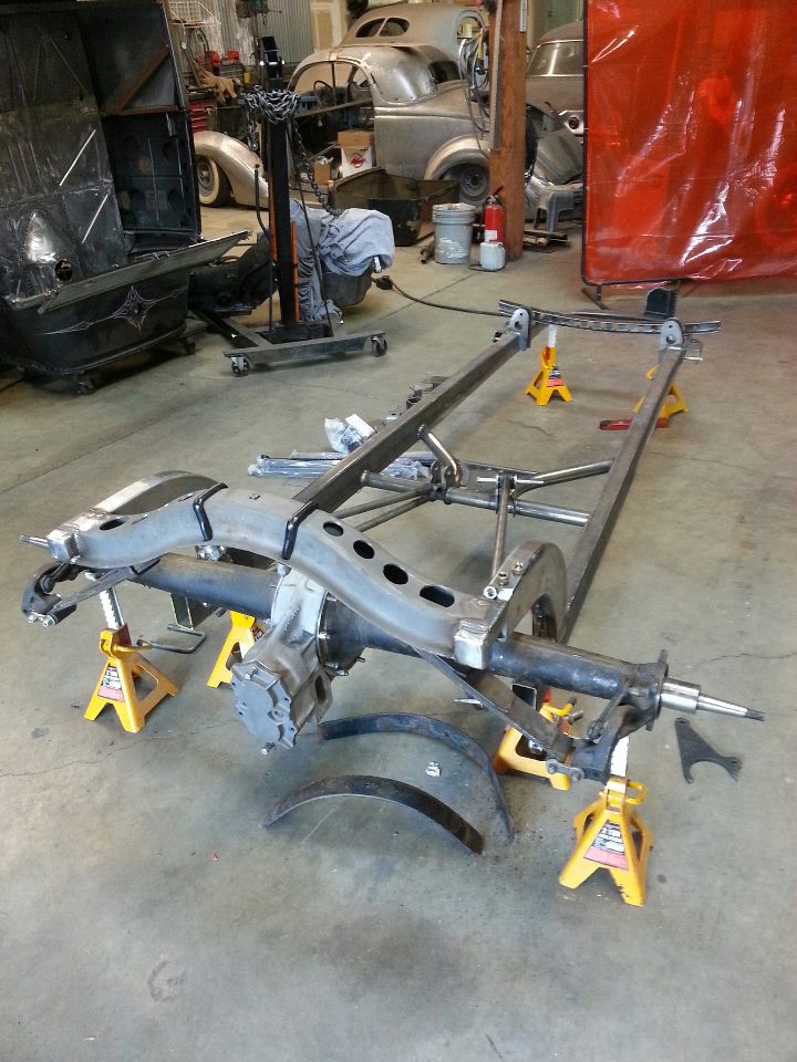

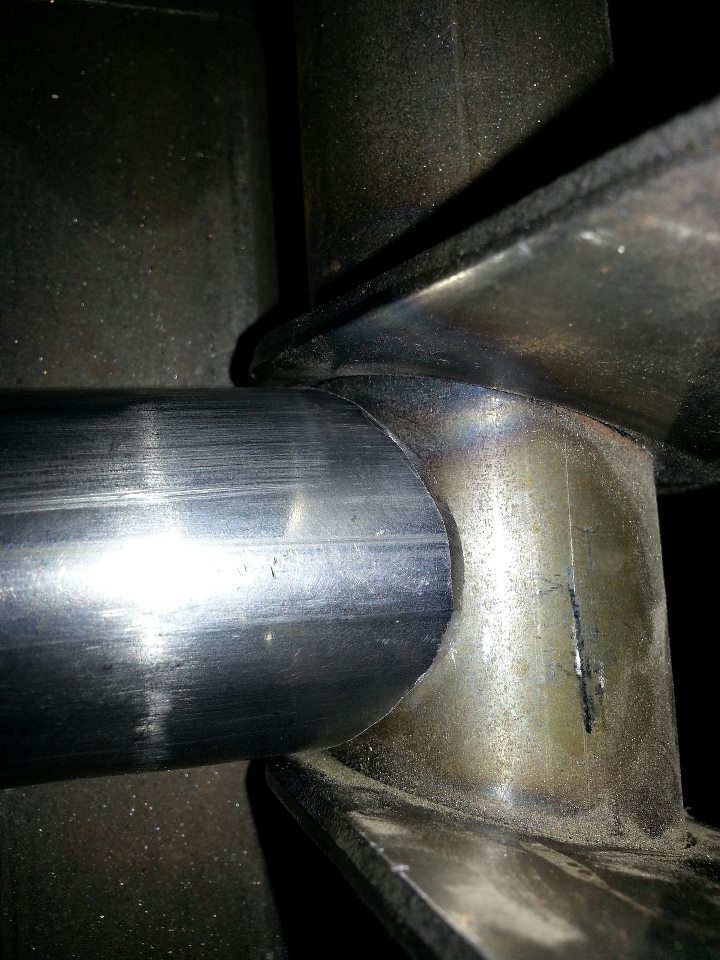

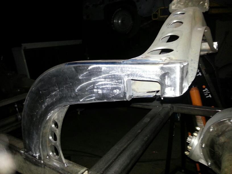

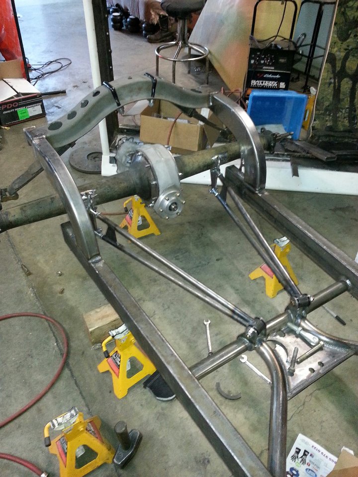

    Here's a little one I'm tossing together. Short wheelbase, quarter-elliptic front, quickie, 270 Red Ram Hemi with 3-deuces, TH350, cowl steering, touring car trunk that folds out into a pickup bed, wide-5's with dirt track tires. You know, the usual stuff:

    I wouldn't call that "usual stuff"...nice work. I like the QC rear! Can I have it? :D

    Prewar-did u have to pinch the model A ch***is for the 27 body??

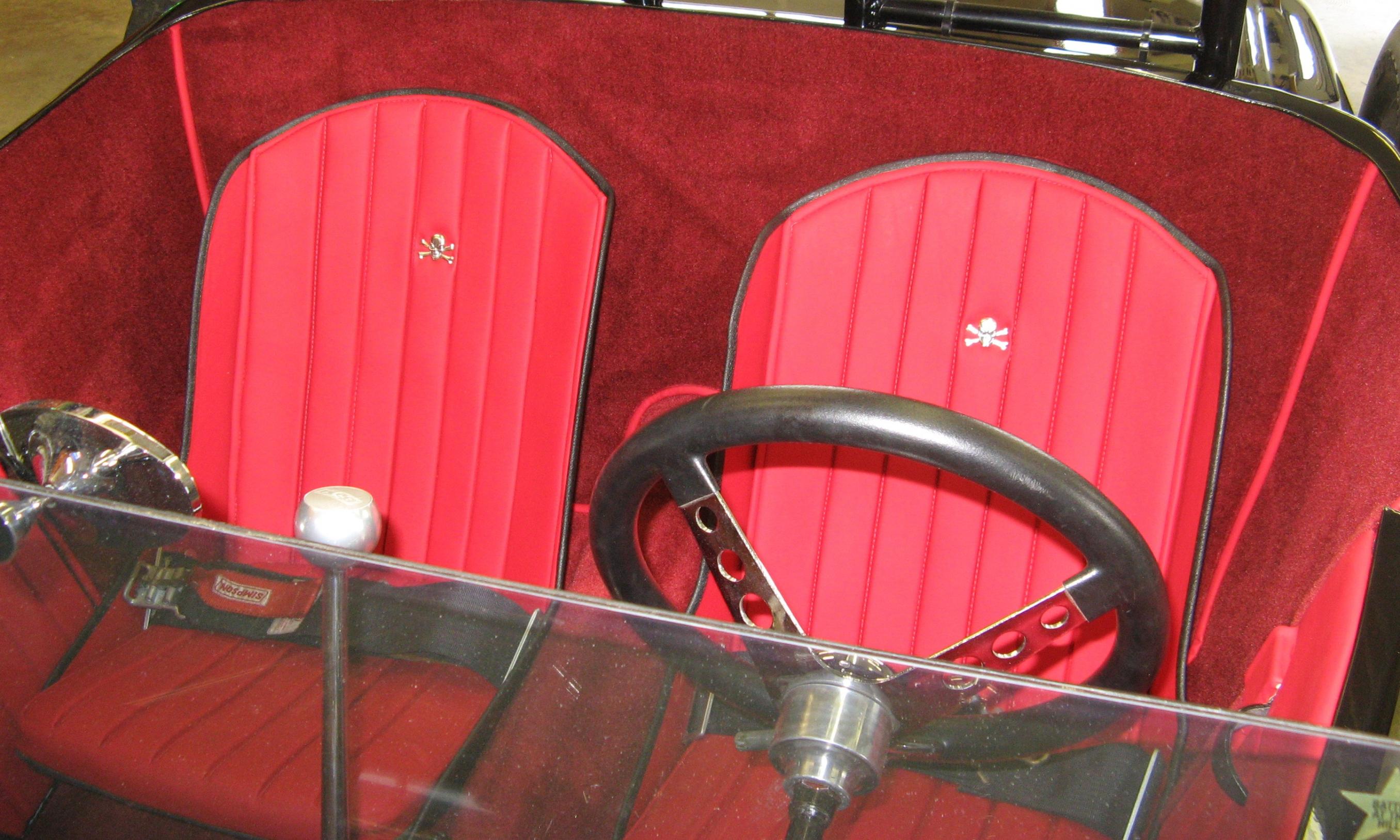

    I prefer the 27 body with turtle deck. I built this all at home. The frame is 2" x 3" and is Z'ed 9" in front and 14" in rear. The bottom of the frame sits 4" off the ground. Oil pan sits 4" from ground. The wheelbase is 118". Has a quickchange rearend and wide five hubs. Body is not channeled. The exhaust hides the frame. With the Z'ed frame and channeled, the trans would have encroached too much on the foot room. The Z's already cut the foot room to a minimum. I used a quick release steering wheel for ease of entry. The body came from Cl*** Gl*** in Maryland. Both doors open. It is built 3" wider than stock. This gives more room for seats, as when Z'ing the frame the drive shaft tunnel comes up into the interior a lot. I had to make my own bomber seats they could only be 16" wide at the bottom. The car is comfortable to drive and is a blast.
    I had about $6K in this until I got carried away with the shinys, the motor, and the interior

    I love that car! I really would like to know more about the Z'd frames in the front. I'm leaning this way when and if I build one to keep my leg room.

    Very nice car. That interior is gorgeous! Nice work!
