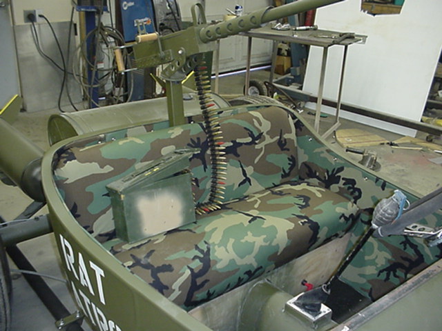

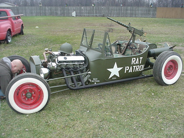

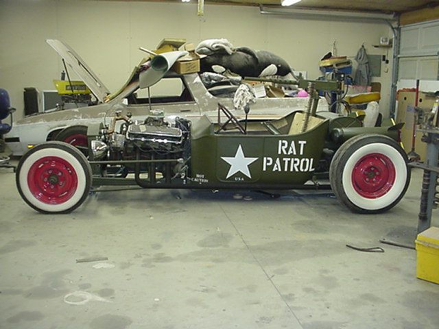

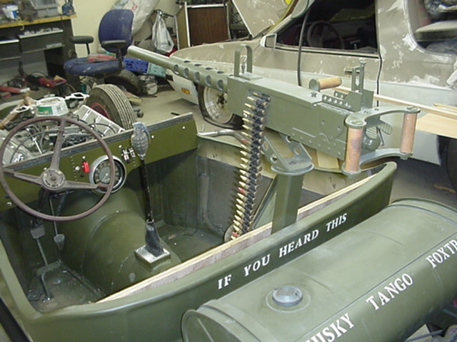

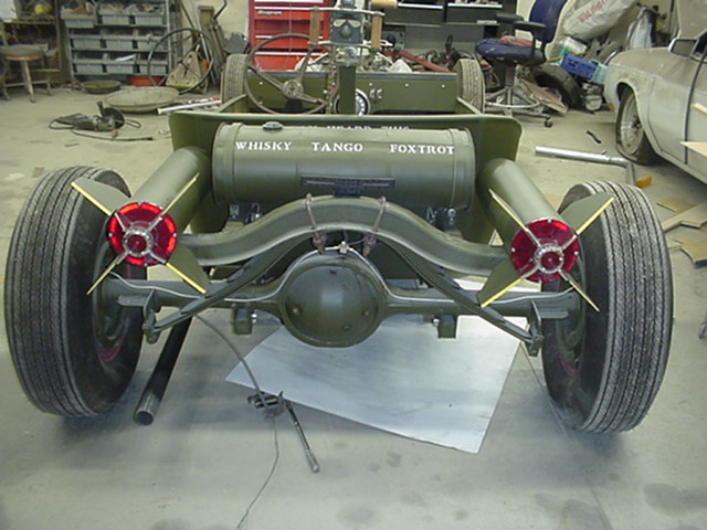

    Well, here goes. When I built this thing I knew it was gonna be cheap. However, I hate the "rat rod" moniker, and I don't think it fits the rat thing anyway. It isn't built to look like ****, just a different look. It ain't all rust and cobbled, just different. If it offends someone, they gotta have thin skin. A couple of guys asked for pictures, so here they are. Just before it was finished I was asked to deliver it to a Veterans day celebration. Went over well, guys had a lot of fun. Norm

    Oh man Norm I have to say I LOVE IT!!!!!!!! That is what I'm talking about.
    I don't see it as being a Rat Rod at all. I see it as being very creative and a tribute to all those who serve. I love this T man.
    I need to really look at the pictures in detail and see what all is going on.
    Tell me where did you put the battery?
    I thought about taking some ammo cans from the surplus shop and cutting them in half and welding them back up to fit a battery in.
    The OD green and red wheel with white walls! I love it that is a *****en ride.
    What window frame did you use? I like that look, it has the swept back look to it.
    Did you do a youtube video of it? I saw an OD T bucket but not sure if it has those wheels.
    Thanks for shairing and if you have more photos or a link please share. I love it.

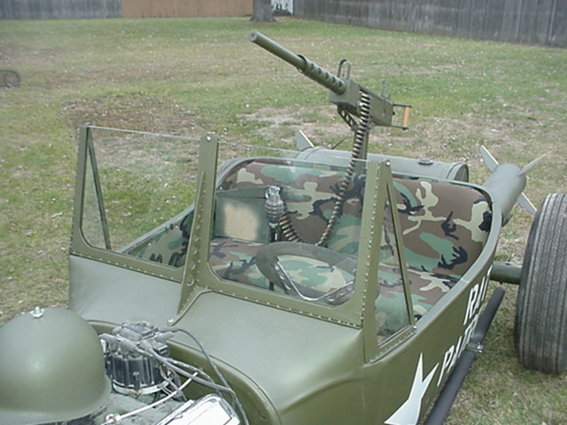

    Battery is under the seat on the p***enger side, next to the driveshaft. Car sets so low the driveshaft is above the floor. Has a couple of loops around it just in case. Had to build the windshield frame. Kinda wanted a fighter plane look. There was about 15 peices welded together. After it was tack welded I was gonna take it off, finish welding, and smooth it all up. Then I got looking at the tack welds and decided to give it a ****load of tacks and leave it be. Kinda looks like rivits. There is a heavy steel structure under the cowl that the frame bolts to. I had a windshied collapse on me about 40 years ago due to insuffecient support, and I didn't wanna repeat this. Windshield sets a little higher than I wanted, but the wind still hits me in the face. I'm over 6' and theres little space to cram my big ***. This is my first build with an automatic and I hate it. However there isn't a lot of room for a bunch of pedals. No, it ain't been on u-tube, but I think I saw one something like it. Hard to believe that the engine has 403 cubic inches and about a hunnert and sixty tire shreddin' horsepower. But due to the lightweight vehicle and a 3.50 gear, it gets right up and goes. Only thing I'm not happy with is the bump steer problem. I thought the pivot of the hairpin placement was close enough to the pittman arm, but evidently not. It's not terrible, but when it catches you off guard, it scares you. I'm gonna try a panhard bar to see if that helps. This has been my first paralell drag link build in a long time, so I guess I'm a little out of it. Cross steer is so much better. I've got some ideas for the looks of the engine, but haven't had the time yet to do it. Gona pull the chrome off it and replace the covers with something just a little bit "different". But that's down the line. I just wanna get it out and drive it as soon as this Michigan spring springs.

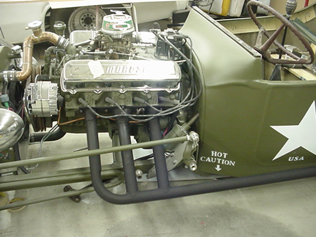

    The way you mounted the rear spring to axle brackets [not far enough apart ,no tension on shackles] is part of the reason your car would wander !!
    dave
  20. need louvers ?
    Joined: Nov 20, 2008
    Posts: 12,901
    need louvers ?
    No offense COOP, but your steering geometery is way off and that is the root of your bump steer problem. When running a paralell drag link like that, unless your running a four bar system with equal length links, you want your pitman arm pointed down, and the drag link roughly bisecting the rear radius rods pivot on it's way to the spindle. That way you are forming complimentary arcs as the suspension runs through it's movement.
    I do have to take exception to your remark that cross steering is much better. It's apples to apples when both are set up correctly. I'm not a huge fan of cross steering on a t-bucket application with a suicide perch and a spring behind type front end because of the angle the drag link has to conform to to connect the spindle. Most I have seen have a real sharp turning radius one dirrection and real shallow the other.

    Yep, yer right on the arc. Problem is, it's a mustang gear and the pittman arm has to aim up. This is the first time I've used one (and last) so I was kinda in the dark on the arc thing. I thought if it was close to the hairpin pivot it would work. Wrong...... well they call it a learning process, and believe me I'm still learning. Thanx, Norm

    Need Louvers..... Yep, yer right. This is the first time that I have used a Mustang box. (and last) The Mustang pittman has to aim up, and I completly missed the arc that you mentioned. I guess this is one of the things that you have to watch out for when you are getting things free or cheap. Guess I was a little out of my element with this one. Have done many ch***is' in the past with either the old F1 box or Vega. I guess they call this a learning process for things like this. Thanx for your info. Norm
