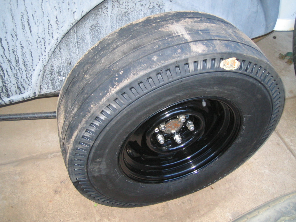

  18. bobs66440
    Joined: Sep 7, 2010
    Posts: 183
    bobs66440
    from New York
    I like the look of the painted smoothie wheels...
    http://www.truespoke.net/Smoothie.html
    But, due to the budget constraints, I will probably end up with plain junk yard steel wheels with chrome trim rings and lug nuts. 15x7s for the rear will be easy to find but I want to use 5" wide on the front. I have a feeling that they will be much harder to find.
    The good news is my $52 Vega steering box arrived in great condition and my buddy has two front tires (165sr15) for me for free or near free. He has a buddy with a service station, so should have a couple of rears soon. I think I will go with 225/70 R15s.

  20. RICH B
    Joined: Feb 7, 2007
    Posts: 6,003
    RICH B
    Those tires might look kinda short on the rear, at least try to find some 235/75 R15's.
  21. bobs66440
    Joined: Sep 7, 2010
    Posts: 183
    bobs66440
    from New York
    Hmmm, now that you mention it, I agree. Let me see what I can find...
