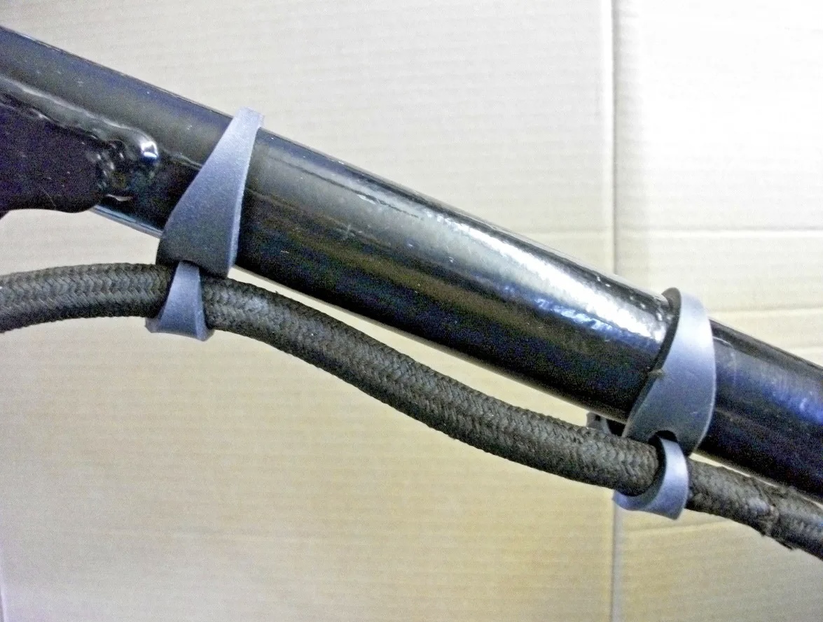

    John Bull rubber cable ties as used on old British bikes. KTM still use something similar too
