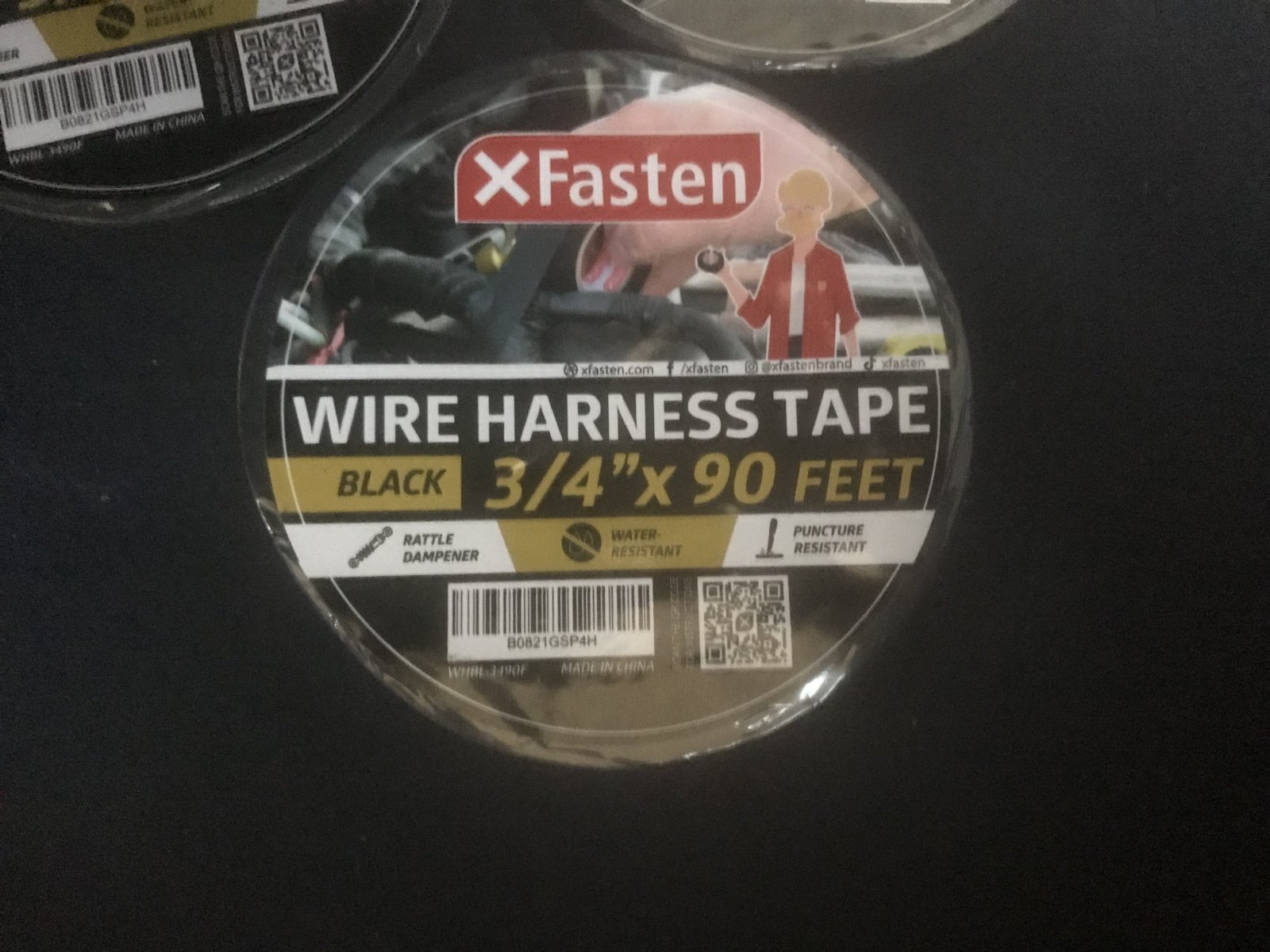

    Someone early on mentioned friction tape. I remember that stuff from my dad’s toolbox. Anyway, I decided to see what was offered. As usual, Amazon had everything…..including wiring harness tape.
    Who knew ?

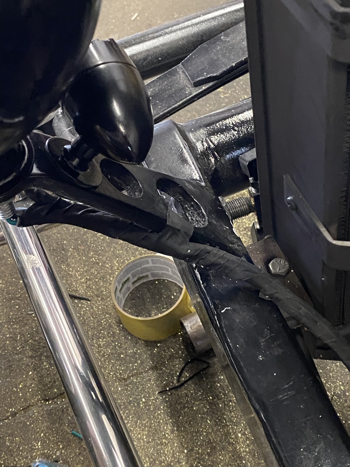

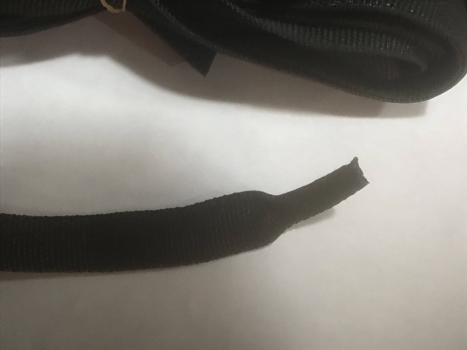

    I had a few minutes at the garage this morning so I tried out the wire harness tape. Feels like the old friction tape but is not sticky on the top. Wraps very well. Looks great. How great you ask.

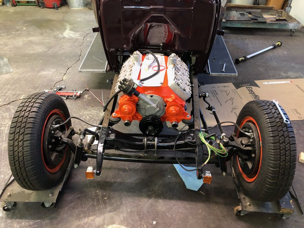

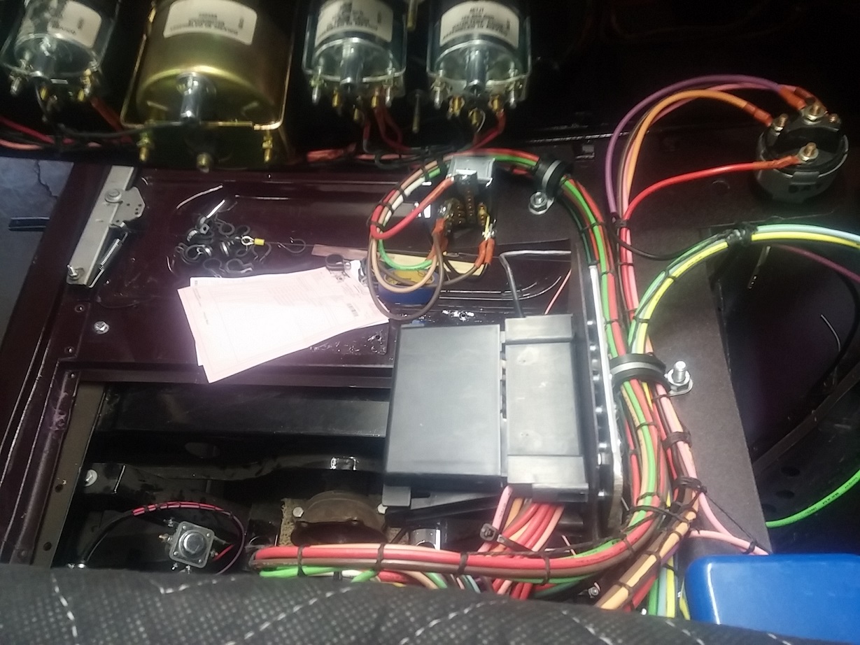

    I never liked the taped up wire looms, makes it a ***** to trouble shoot. When I built my coupe I string tied it like they used to do in aircraft and then used the split mesh wire loom. The loom is hard to see but this is the best picture I could find, the distributor wiring is on the engine and the headlight wiring is by the left shock. Not traditional but looks good and fairly easy to work on.

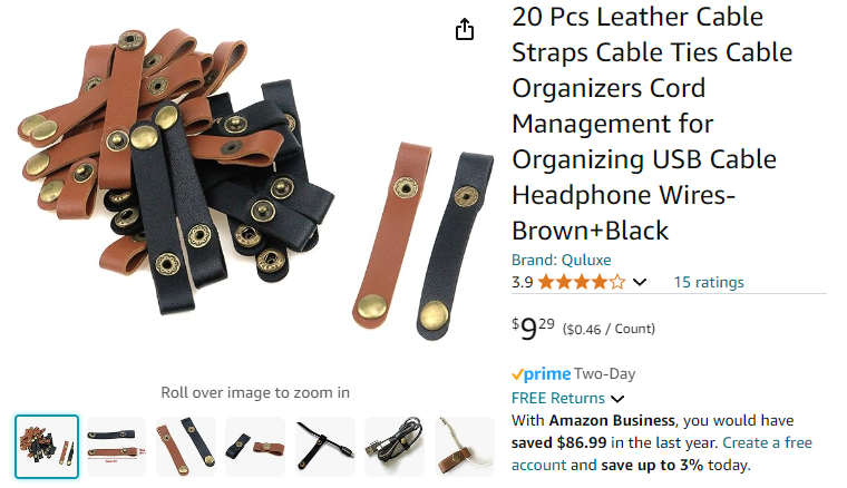

    I found these on Amazon, 20 leather wire ties with a snap. You can order just brown or mixed black/brown. They are 2.91" long which equates to about .95" diameter. I will let you know how they look when I get them tomorrow.

    I was going to step up to the plate and order some until I saw the TEMU logo. Just read a few articles about TEMU. Don’t want my name or credit card number in their files. Be careful guys !!!
    EDIT !!!!
    found it on Amazon and bought some. I will let you know how it goes

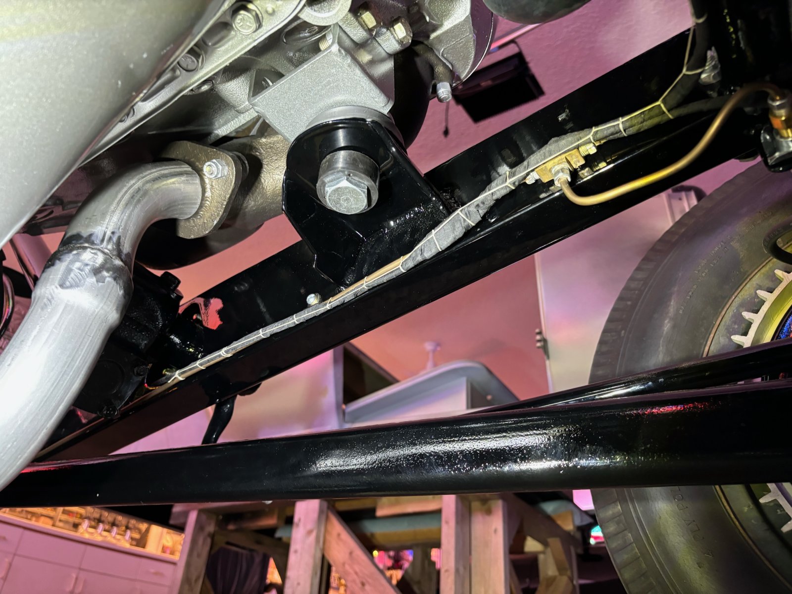

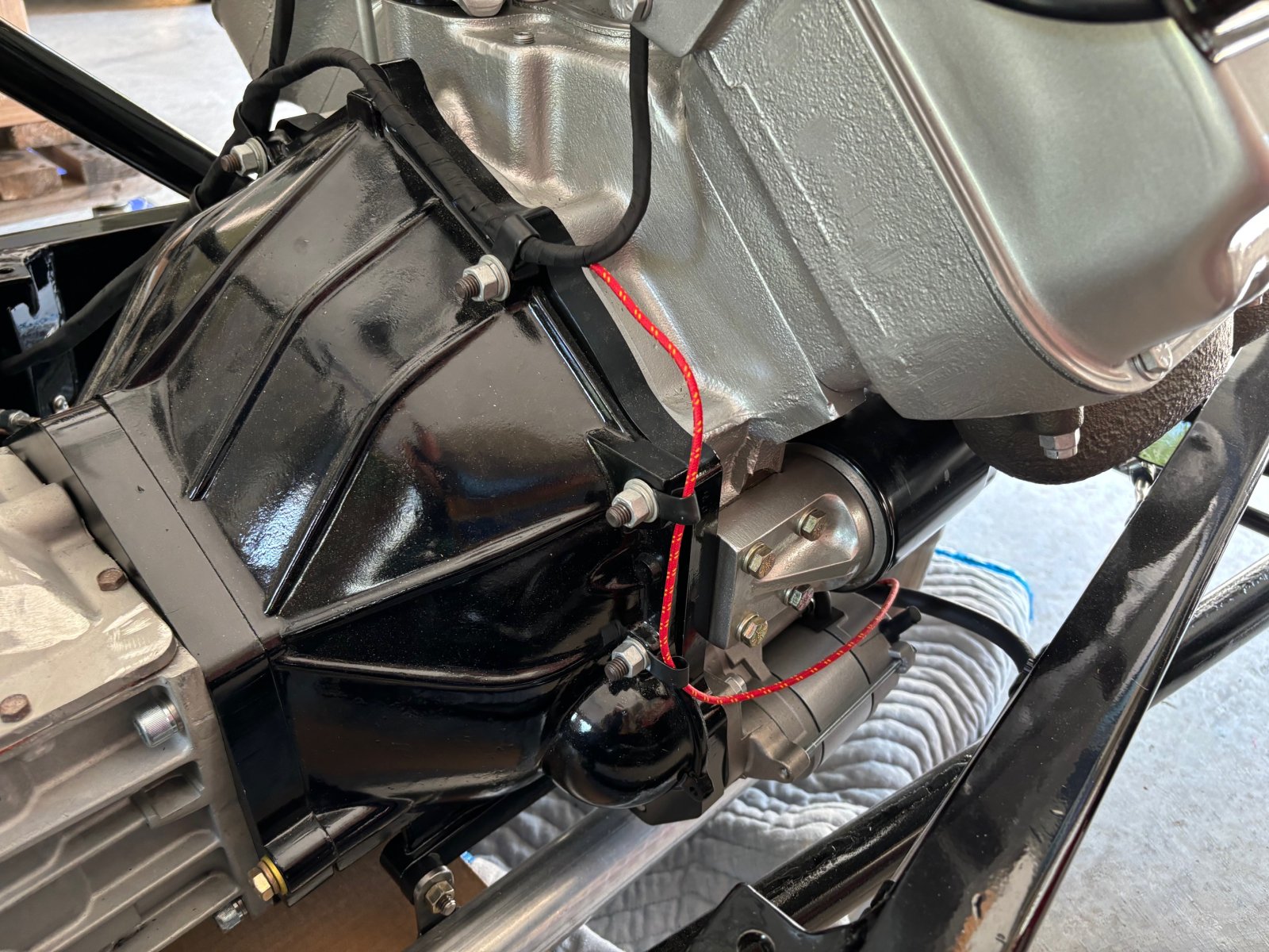

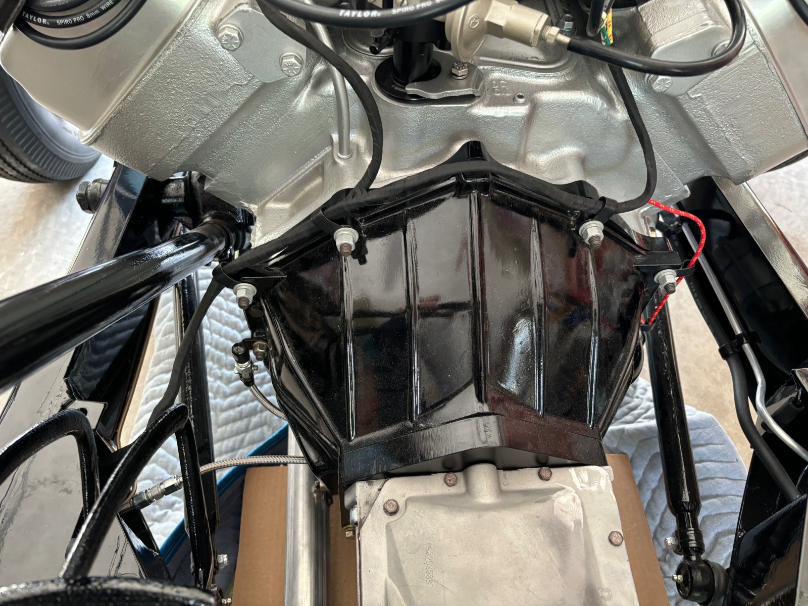

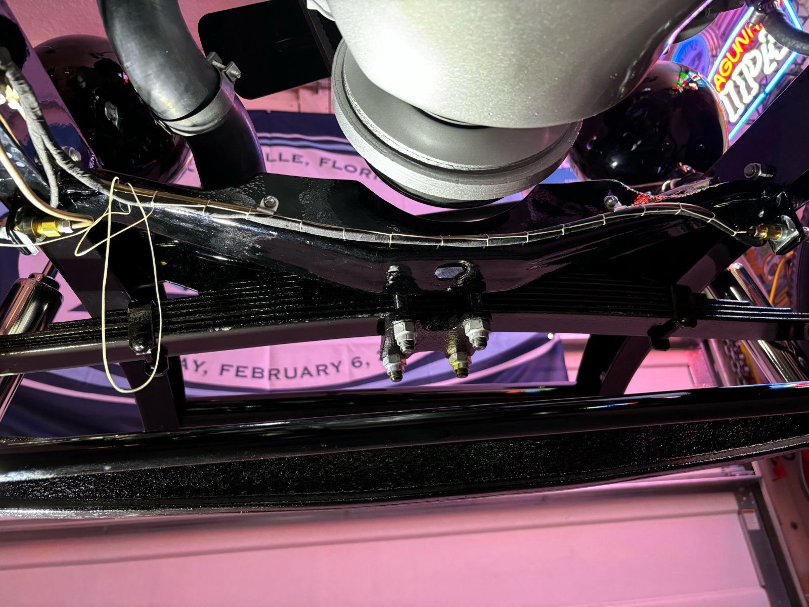

    I am going with a vintage vibe for my roadster project. I found the correct cloth electrical wiring tape and waxed aircraft lacing cord. I'm very happy with the look, it's different than everyone else and has a vintage look. I made my own metal "J" clips and dipped them in black plasti dip that bolt on to hold the taped bundle.

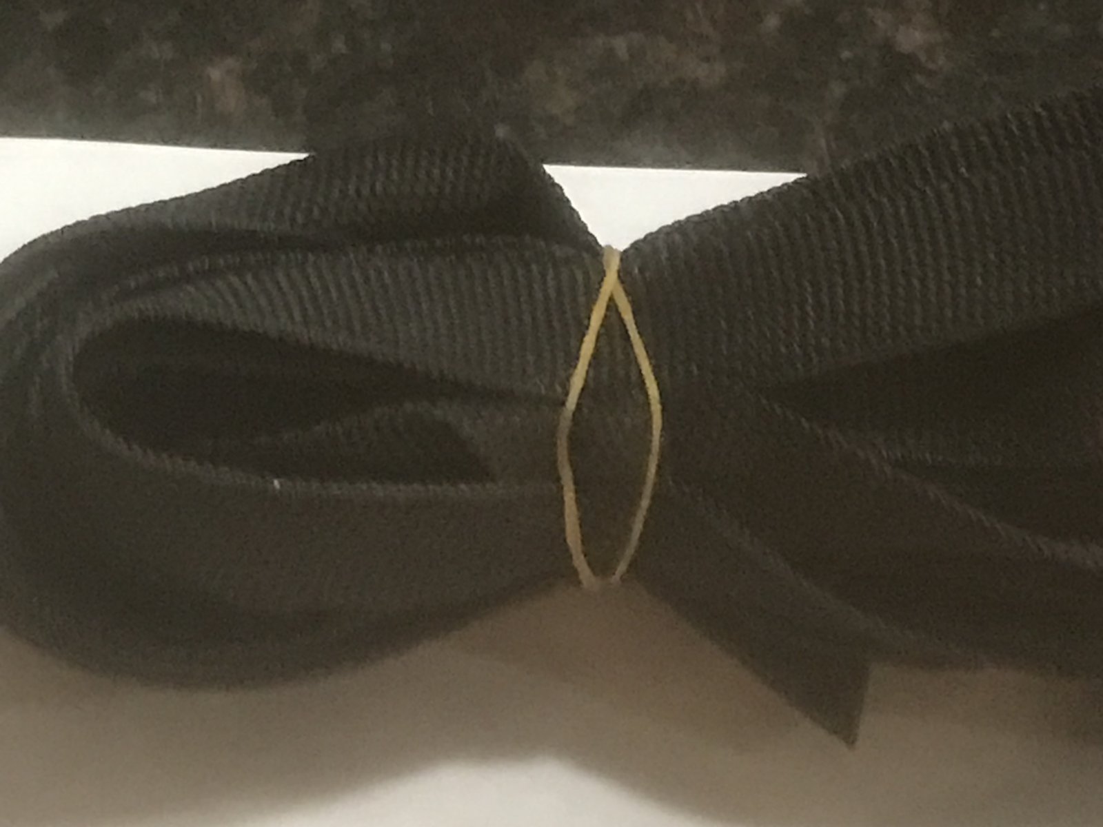

    My order showed up. I finally got a minute to play with the stuff. This order was 3/8 inch size. The is not a split loom product so plan accordingly. I cut a small piece just to see what it does. This product is delivered flat. You will need something to open the tube. No mess or fuss on my hands and fingers.
    I hit the small piece with a lighter for about 7 seconds. It shrinks the same if not a little better than regular shrink tubing.
    I’m hoping to get to my garage in the next couple of weeks for a better test.
    OPINION : $17 for 22 feet seems kind of expensive.

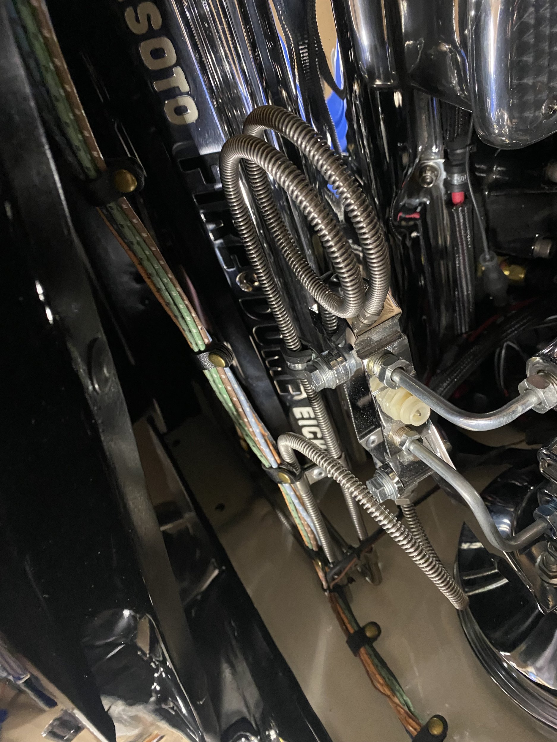

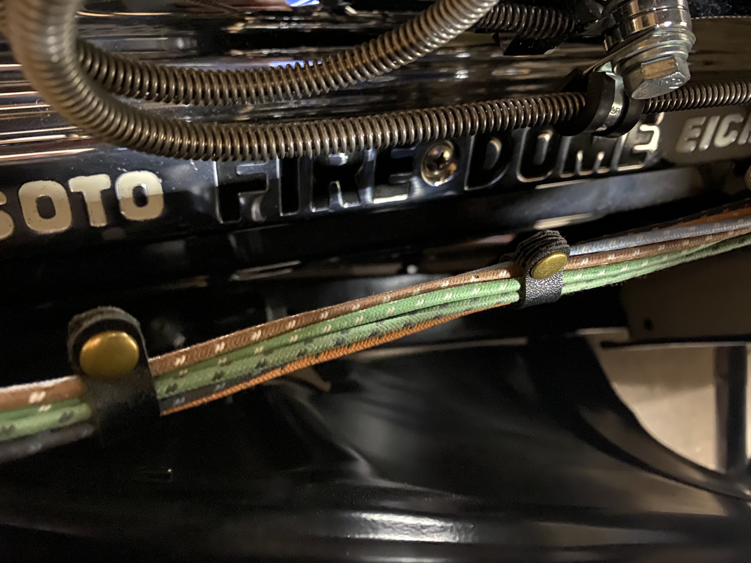

    Don’t ya hate when someone ghosts you like that? Sorry, forgot until I was playing with them on the truck today.
    There was a loop on the end, maybe to attach them to something? I don’t know but I cut them off. Black leather with a br*** snap. Looks better than zip ties. I think.

    Yeah, I figured you just forgot about it :p
    They look pretty nice on there, much better than zippy ties! Thanx for the pics :cool:

    Nice Billy. Great look, I might get some of these and play around with them.
