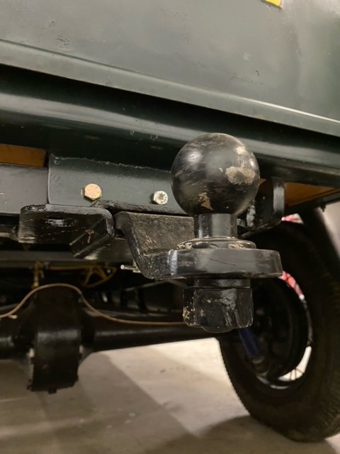

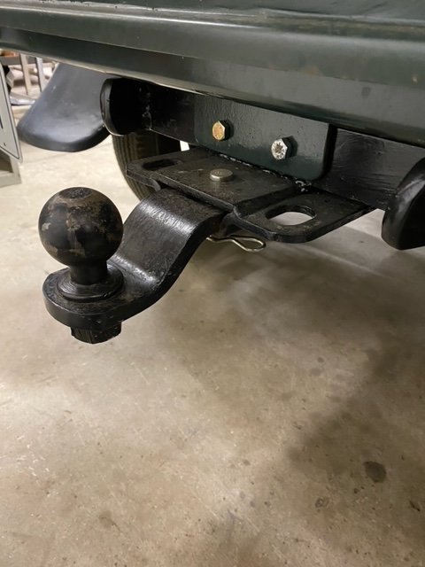

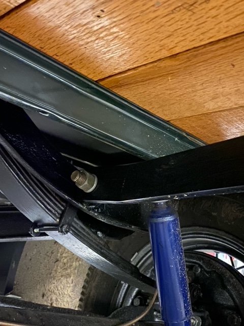

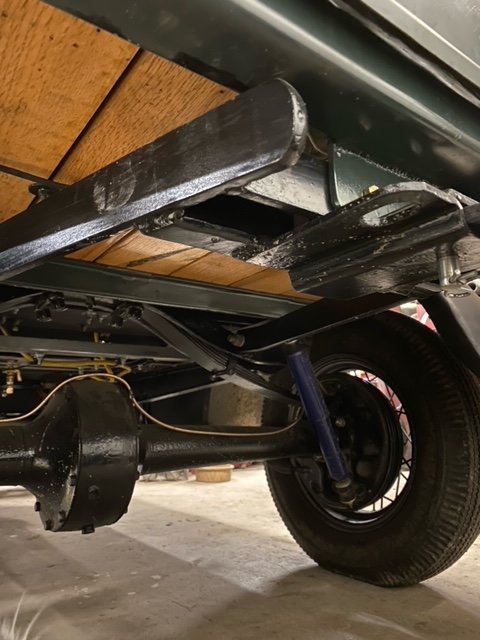

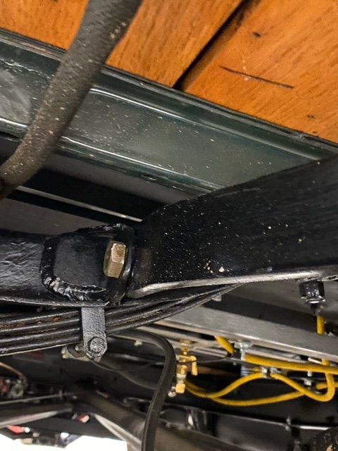

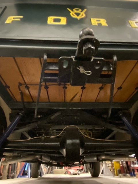

  6. BobF
    Joined: Dec 30, 2004
    Posts: 232
    BobF
    from Poway, CA
  7. brading
    Joined: Sep 9, 2019
    Posts: 807
    brading
