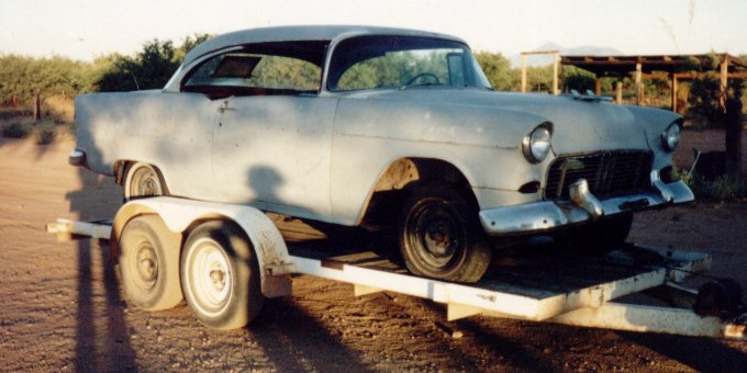

    here's my trailer long ago....it's a really flimsy piece of **** I got in exchange for putting a head gasket on a car for a guy. I put a heavy duty cast iron boat winch on it (you can see it if you squint), which is really nice compared to using a come-along, and the battery never dies like my friends who has an electric winch.
    how about some tie-down and safety chain info? I know I've been doing it wrong for years, although it's never bit me....yet....

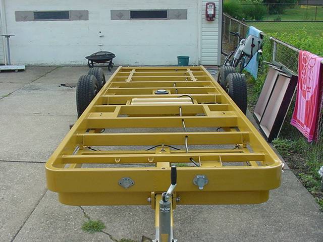

    This was built specifically to haul my digger. I have a very narrow drive so I had to keep it on the narrow side as well.
    The wiring is modular. The winch drops into a socket built in to the trailer and then plugs into the trailer's battery via the plug on the front.
    I also used a semi truck "curly" cord for wiring from the truck to trialer- it is a tad overkill, but it's also bullet proof as well.
    The tongue collaspes for storage in my garage and it tilts for easier unloading of the digger. Virtually no ground clearance - so it's an issue mad emuch easier by tilting things.

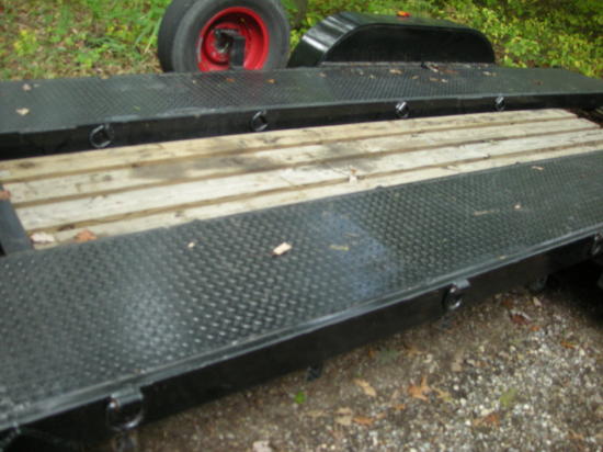

    Another fwiw, I added four more HD car folding tie-down rings to the floor of my enclosed car trailer - complete with reinforcing plates and tied to the crossmembers - as well as added a bunch of medium duty folding tie downs in the floor and some 1/2" bolt on eyes in the fenderwells and a couple other places on the floor.
    A big help when moving the 750# drill-mill.
    The lathe proper was partially dis-***embled and screwed to the floor with lag screws to prevent it walking around.
