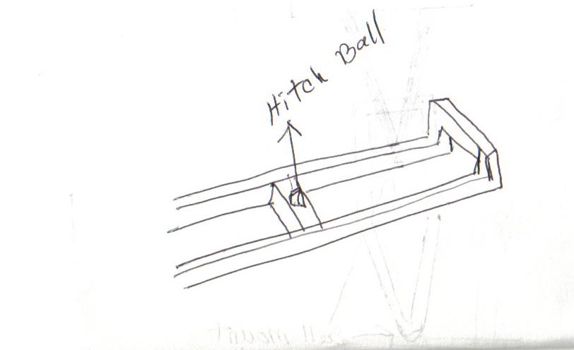

  1. The drawing is what I had in mind for an extension.
    The trailer is 6" x 3" (I think) rectangular tubing although I was thinking 4-6 half inch bolts in crush tubes for the back end bolt on and a trailer ball connecting to the original trailer hitch as you've drawn.
    I do have several feet fore or aft to move the roadsters for balancing purposes.
    Back to your regularly scheduled program....:D

    C9 the leverage keeps it in place. Maybe I didn't show it clear enough but the extension goes over the top of the tongue at the rear, then down and forward. That's why you really only need the bolts to hold it up when unhitched. I know it's still another crude drawing but maybe this will help show what I mean
