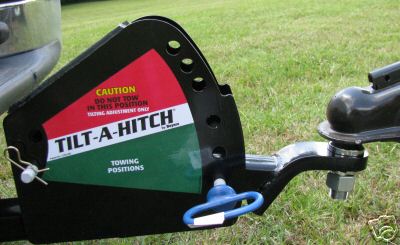

    2). Tilt-A-Hitch - best used with an electric tongue jack but will work with hand crank type. Basically it turns any trailer into a tilt trailer - just great for really lowered cars - yep and even those with failed airbaggies.
    Both of these items are usually available on EvilBay.

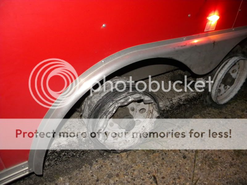

    Lots of good info here. As stated in my earlier post back on the first page, carry two spares for your dual axles. I used to wonder how people could ruin rims but now I know. I think the front tire on this side was the tire that was the twin to the one shown in the post with the separated belt. I'm convinced this one separated a belt and blew taking out both tires. And rims, wrapping tire wired all up in the drums. I got to pull both drums, unwind the wire from the shoes. Upside the bearings got inspected and repacked. The boy thought it was fun. I guess. I told him that was because we had the right tools, the right spare parts and the knowledge to fix what was wrong. Wouldn't have been near as 'fun' without these three things.
