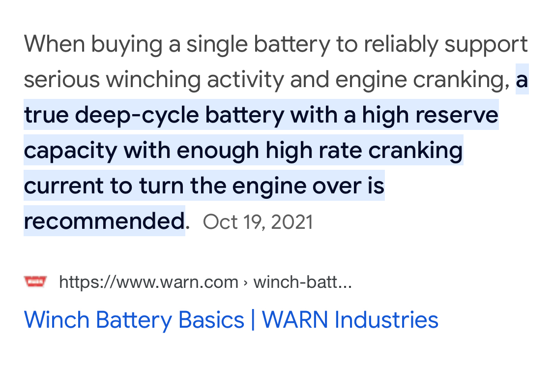

  30. Read what the winch manufacturer
    recommends - which is to place
    the battery as close as possible
    to the winch:
    I have been transporting vehicles
    year round since 2006 and no one
    I know runs cable from their
    truck battery(s} to their trailer winch.
    They buy a deep cycle or marine
    battery and put it in or on the
    trailer in a battery box and it charges
    from the 12VDC power supply
    run thru the 7 way towing cord
    from the dedicated lead on
    the tow vehicle.
    If you do not use your 12VDC winch
    daily - you can remove the battery
    for storage and theft prevention.
    Look at any 12VDC Charger …
    The AC inverter has a short cord.
    The 12VDC leads are not 20 feet long.
    Look under the hood of your tow vehicle.
    The alternator/generator is not 20 feet
    from the battery.
    Your tow vehicle has a 12VDC
    charging system engineered
    and designed to keep the battery
    charged during normal operation.
    A properly equipped tow vehicle
    has a dedicated 12VDC charge
    line as part of the OEM wiring
    harness ran to the rear of the
    vehicle to a 7 way male outlet.
    This dedicated 12VDC circuit
    is intended to charge a
    separate 12VDC battery
    that feeds required loads
    like an electric trailer jack
    or trailer interior lighting
    or an electric winch.
