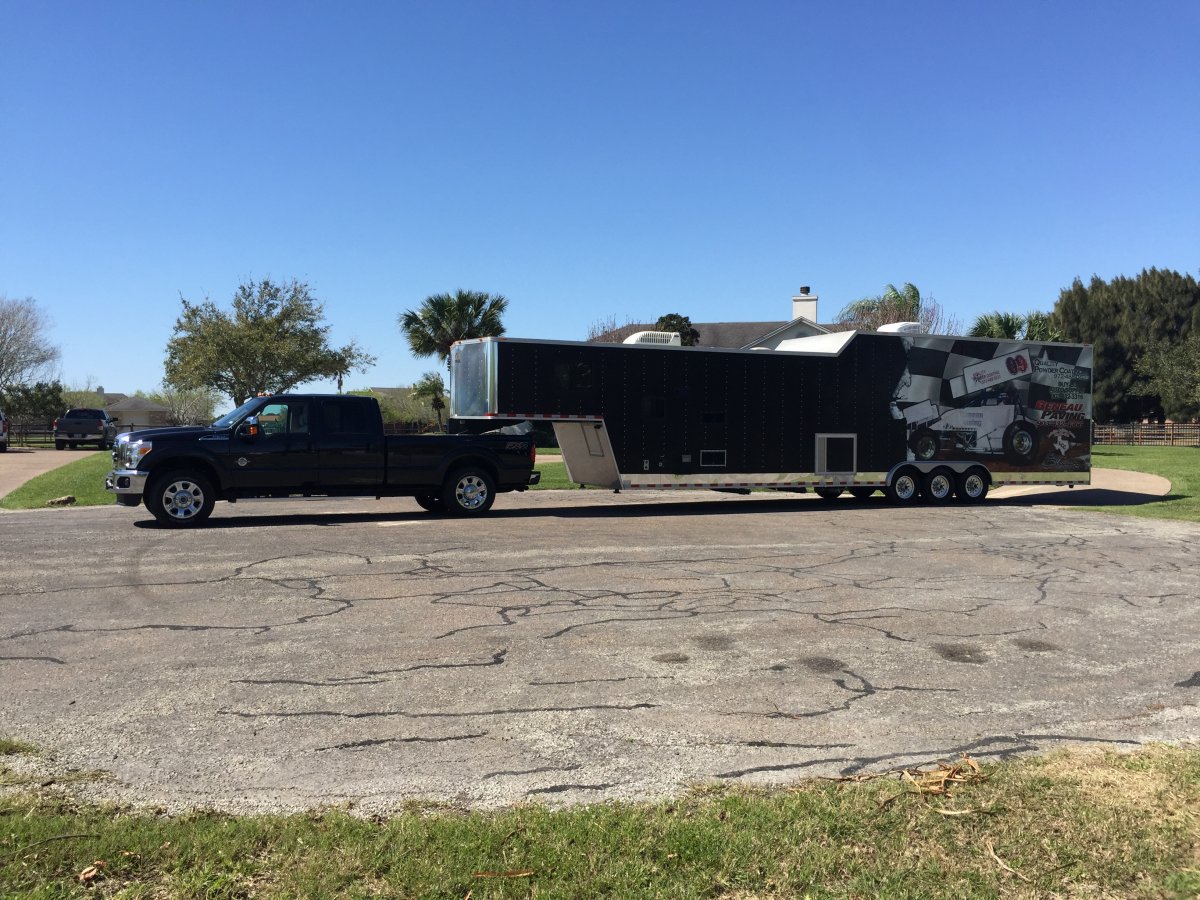

    004 (3).JPG 006 (4).JPG 525.JPG Here is mine. I live in it while away at work and carry the ch***is I am building with me so I can work on it in the evenings during the week. It has 20' of living quarters and 24' of shop. Home away from home. 004 (3).JPG 006 (4).JPG View attachment 3697872

    That's gorgeous. Very nice work! I'm considering going that route or buying and altering one. M***achusetts is a real PITA with trailers apparently (and they're apparently cracking down on Maine tags), particularly with used ones from out of state that aren't ***led, it seems. And homebuilts here seem iffy as well, but I'm going to explore it further.
    Wow, that sounds like a pretty great way of life! Are you an oil man?

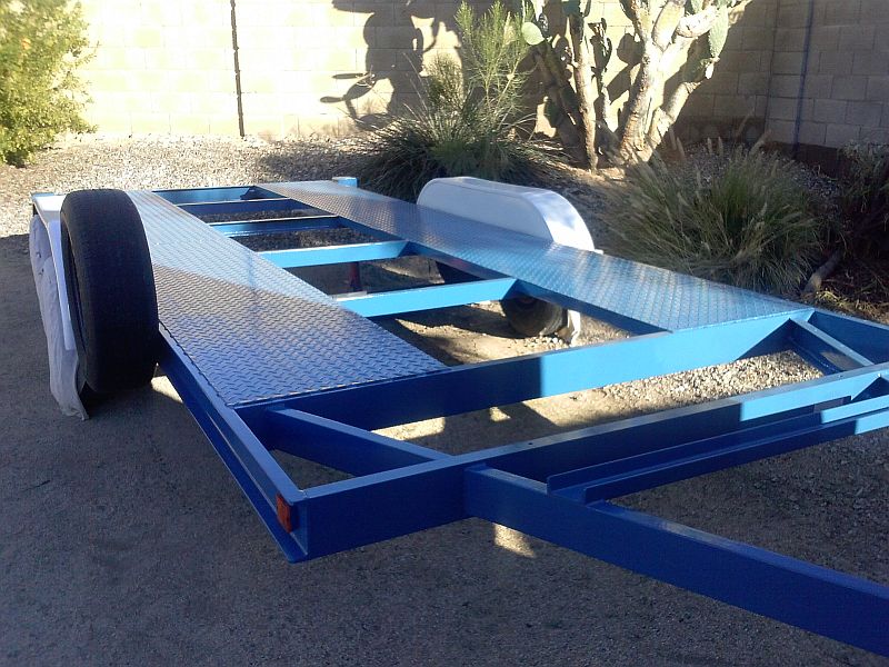

    I built my latest trailer with an open centre deck so only a car can go on it. I can also crawl under the trailer and inspect the underside of my race car.
    The trailer has slide-out ramps [with a height limiting chock attached] The Ramps cannot be removed from the trailer and lost.
    It has tilt deck, AND dovetail, AND ramps so I can load a low height race car. The deck and the ramps automatically latch in [like slamming a door]
    Now here is the best part......The tongue has separate caster wheels on it, I can simply unplug the wiring harness with a plug near the pivot and unbolt the 2 pivot bolts and roll the tongue underneath the trailer with my race car still on it [it will fit inside a normal residential garage away from thieving eyes]
    excuse the OT car on it

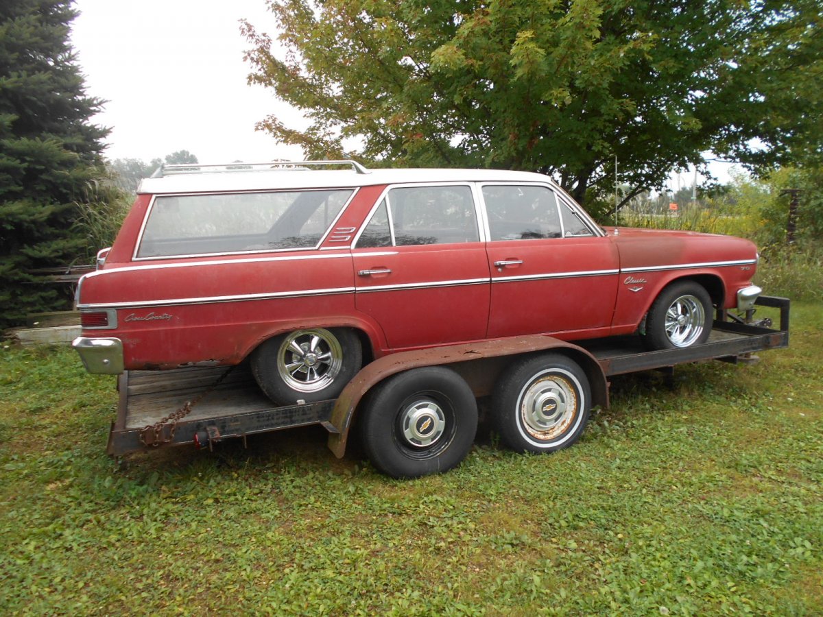

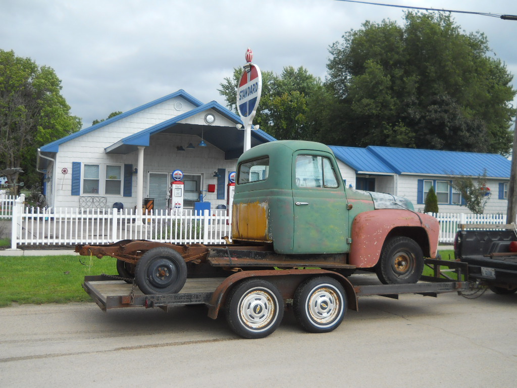

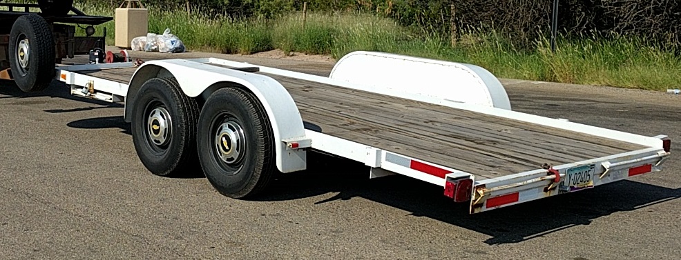

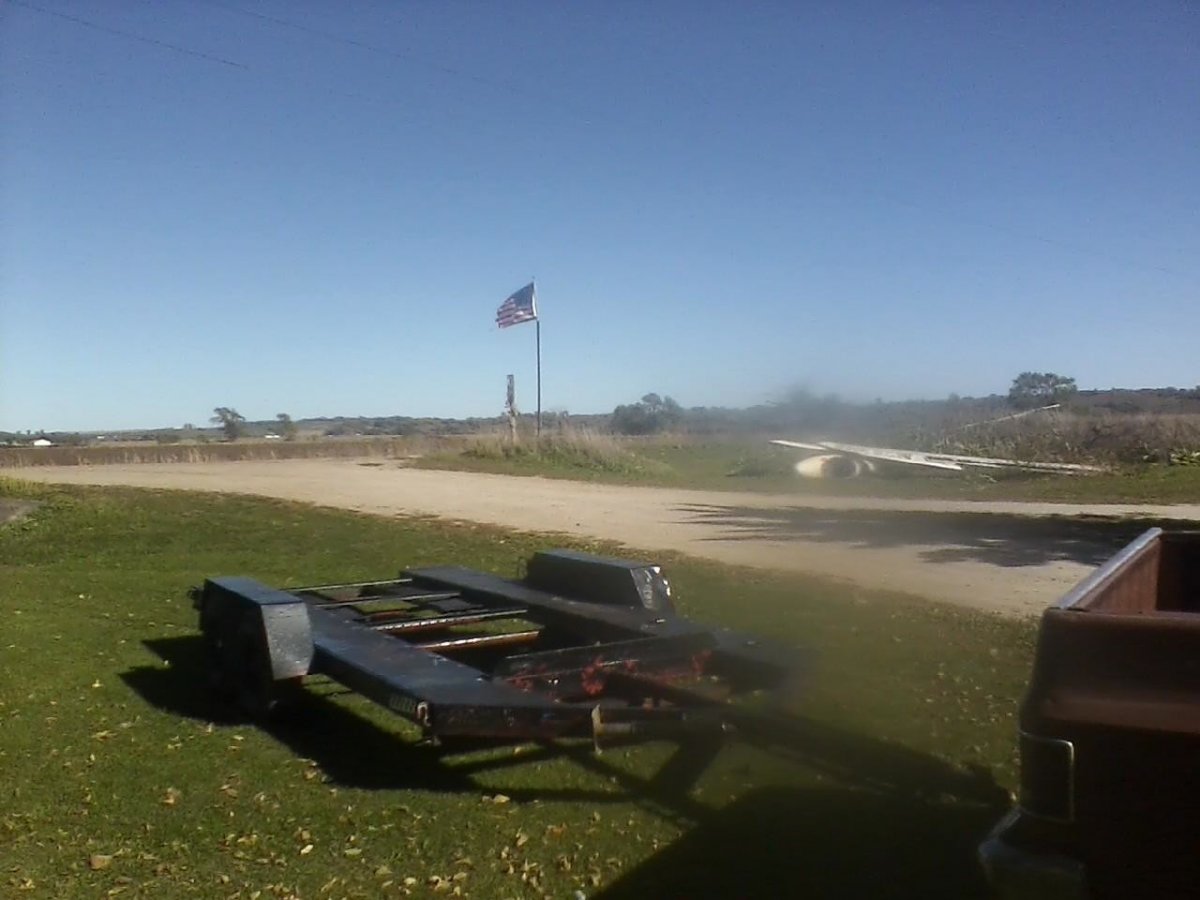

    ...interesting thread, it's neat seeing all the stuff you guys haul...mines a cheapy, angle iron frame, wood deck,...I like that it sits fairly low.
    ...I went to Iowa to buy this then new trailer in 1988, on my way back to Illinois I loaded up a nice original 36 Chevy tudor I'd bought the week before,...sold that car and with the profit, I could've bought 3 trailers like mine,..it's paid for itself many times over,..once you have one you won't be without one again, just so handy. My advice is to never let anyone else use your trailer.
    ..mine's currently loaded with this 65 Rambler wagon,..hope to unload the wagon at someone elses home LOL/
    ...here's a few pics...
    65 rambler wagon 8-17-17 034.jpg 55 ih 9-10-14 018.jpg 55 ih 9-10-14 044.jpg 38 cpe 5-18-12 026.jpg
