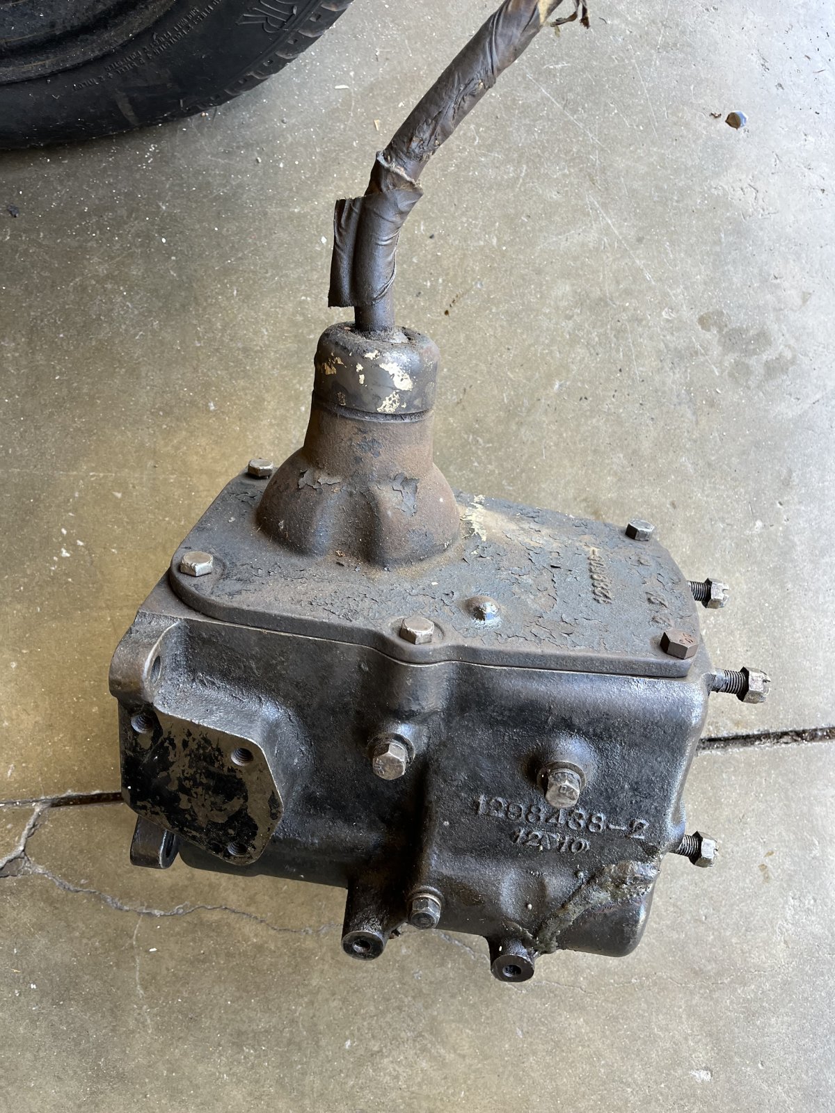

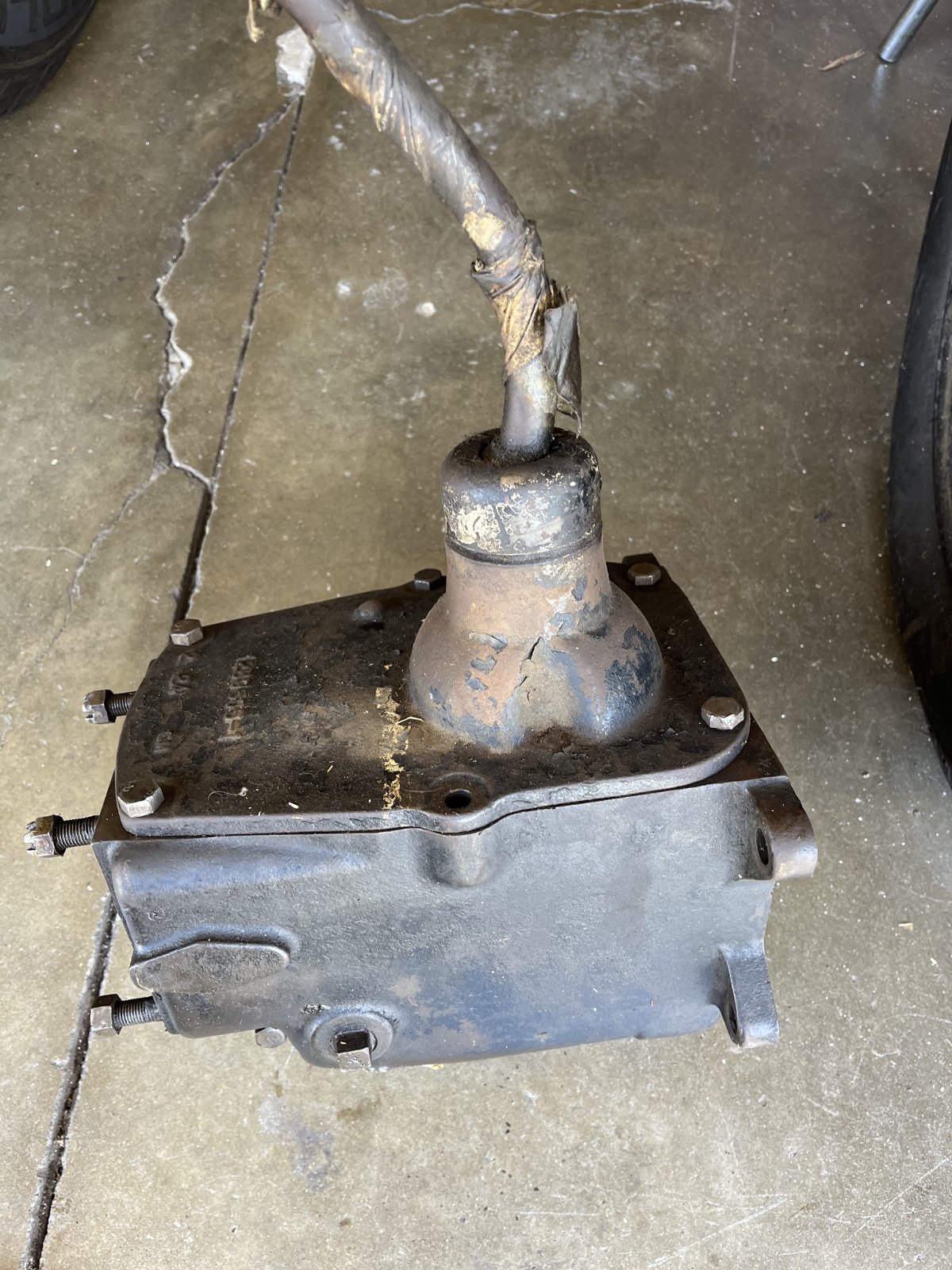

    Trying to identify this top loader trans.

    This claims to be a 1938 Buick Century transmission.

    here's a side by side with your picture

    37-38 Buick Century case. An Olds 51-61 selector gear gut will fit inside it and convert it to open drive making it a very sturdy traditional trans swap.
