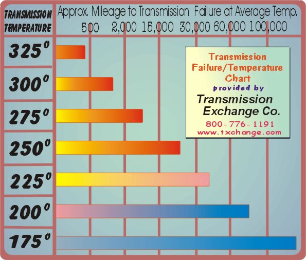

    I'll suggest to junkyardjeff that he also install a fluid temp gauge. ATF breaks down rapidly after 250deg or so.
    On my ot truck the trans fluid is fairly well matched to the coolant temp unless towing some big weights.

    Normal transmission range is between 180F- 250F with pan temperature @ 60mph being 180F. Any more that 20mins @300F and you could need some repairs. When towing a load the temp can easily rise to 250F. Pull a steep hill or grade, tow a trailer and it'll easily rise to 200F+, continue to do things it wasn't designed for and you could easily destroy it by boiling.
