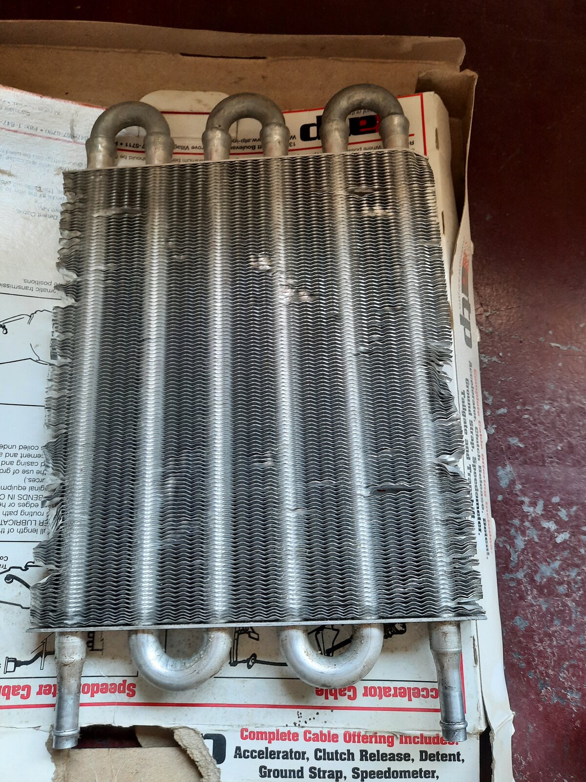

  6. Flat Six Fix
    Joined: Feb 6, 2010
    Posts: 1,268
    Flat Six Fix
    My other external cooler. This type not as good as one I'm using however.
    This was used in a 66 Nova, with T350 trans.
  7. Budget36
    Joined: Nov 29, 2014
    Posts: 15,386
    Budget36
    I think the idea is with the input at the bottom, it eliminates the possibility of an air pocket. In principle I can see that, but in reality for such a short fluid path, I don’t think it’s something to worry about.
    It’s not a some 300 foot pipeline we deal with.
