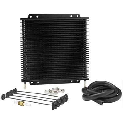

    Hi. I am trying to get a 56 Cadillac road worthy. I am considering using an external cooler for the transmission. The 56 had an external cooler but I don't have one and haven't had any luck finding one. Anybody have an experience installing an external cooler I could use some advice.

    You can put one in front of the radiator or I have installed them on the frame rail giving it enough room to have air flow .
    Most kits have enough hose to complete the job. They also come with instructions and pictures.

    Yep, simple and easy to route in front of radiator.

    Simple and efficient sounds like the way to go. The one for Cadillac mounted near the trans under the flywheel. In 56 It used the radiator fluid to cool the trans. Since I haven't been able to find one I like the idea of an external one in front of the stock radiator.

  7. If you just want a cooler to do an efficient job and not cost a bunch, they are fairly generic and easy to online search to compare size, cost, etc. They are a simple, basic add on and you don't need to work at NASA to know how to put one in.
