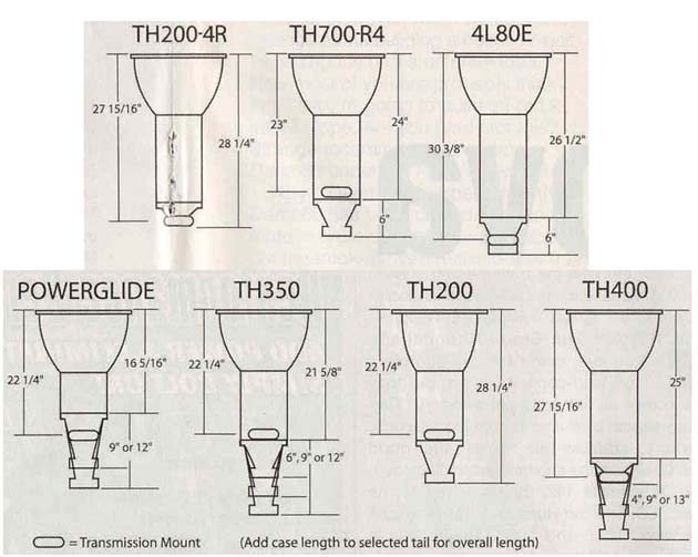

    So I have looked around and for some reason I can't find it I have 350/700r4 combo in my shoebox I need a trans cross member . How are y'all modifying your stock ones. Or is there a good thread that shows how to do it.

    I think that the TH350 mount will fit the 700R4, you will need to move it back in the frame a little. This will require putting spacers under the mounting plates to the frame (frame rails are closer together at the front), and tweaking the parking brake cable setup a little.

    You could always call Jamco and ask them how much drop is in their TH350 one, and then buy a universal one with that drop.

    Shoebox Central has a adapter kit that apparently uses Ford crossmember. There is a difference in length in transmission mounts. Rather than drop drag link to clear sump, use a 66-67 Nova oil pan, pickup tube and oil pump.
    Butches Cool Stuff also has a similar kit
