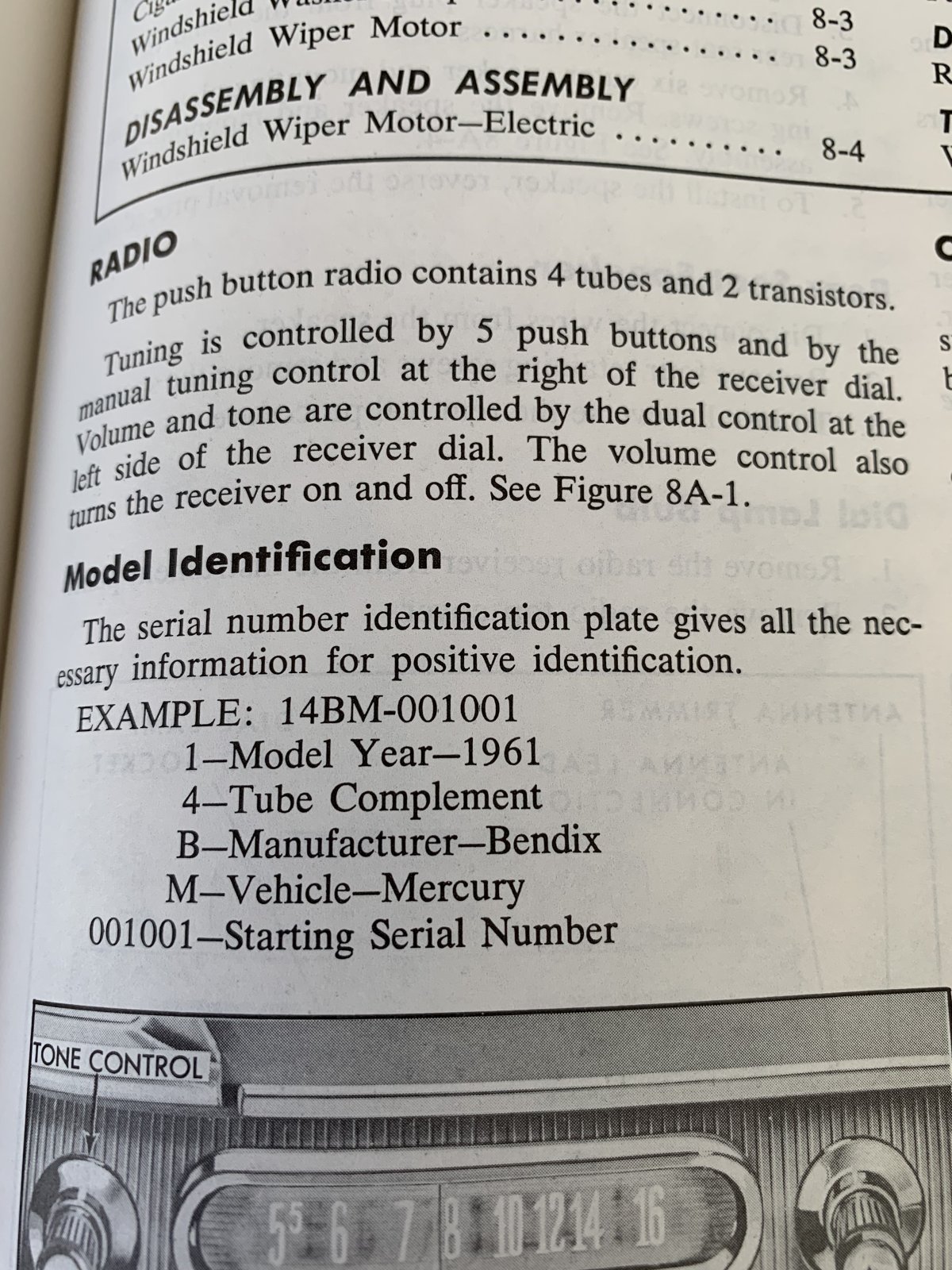

    Apparently it’s tube and transistors
