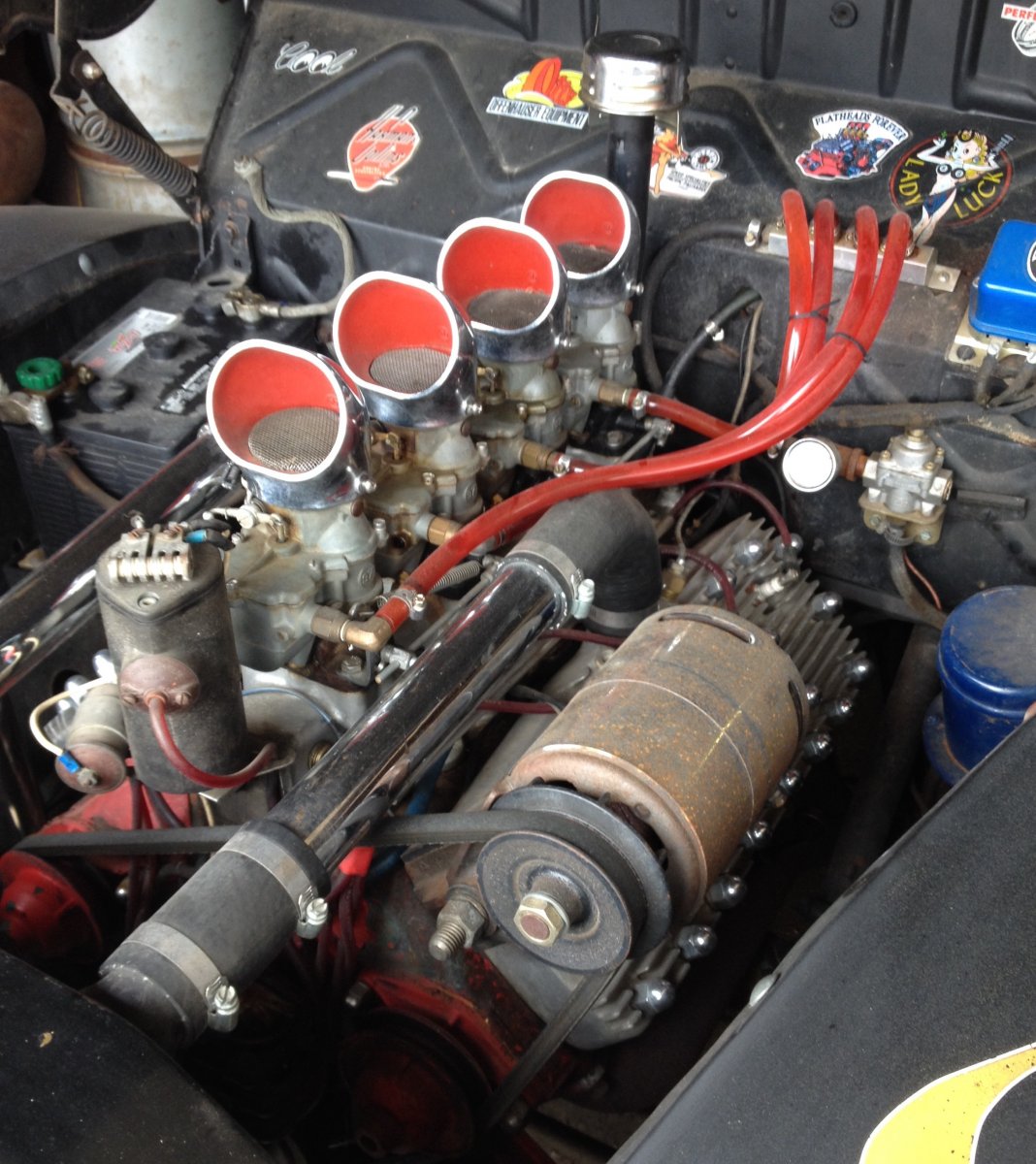

    i am using it, bought from speedway. this is what i found;
    the color within the year has faded to pink.
    i had to remove them off the hose barbs to swop carbs around and had a hell of a time getting them off.
    i have been checking them often and will swop them out at ANY sign of a problem.
    i have had black rubber fuel line go bad in as little as a year on other vehicles so unless you use the super fuel injection stuff i think they all should be checked often. DSCF4212.JPG

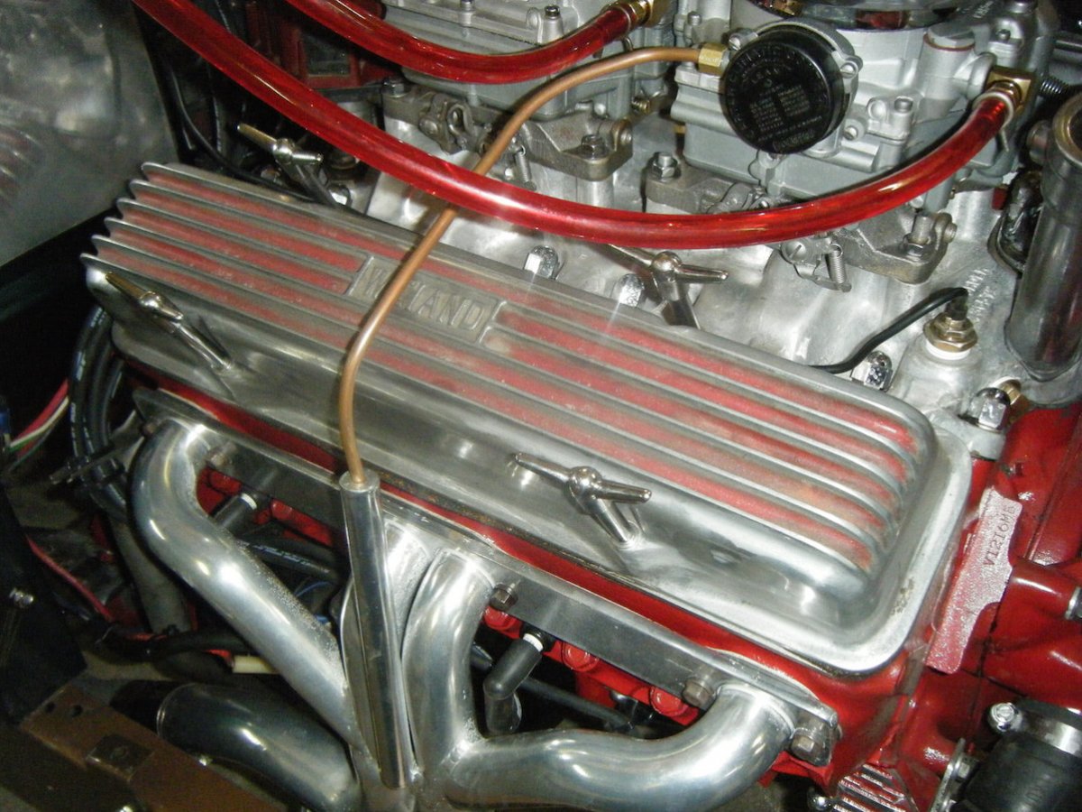

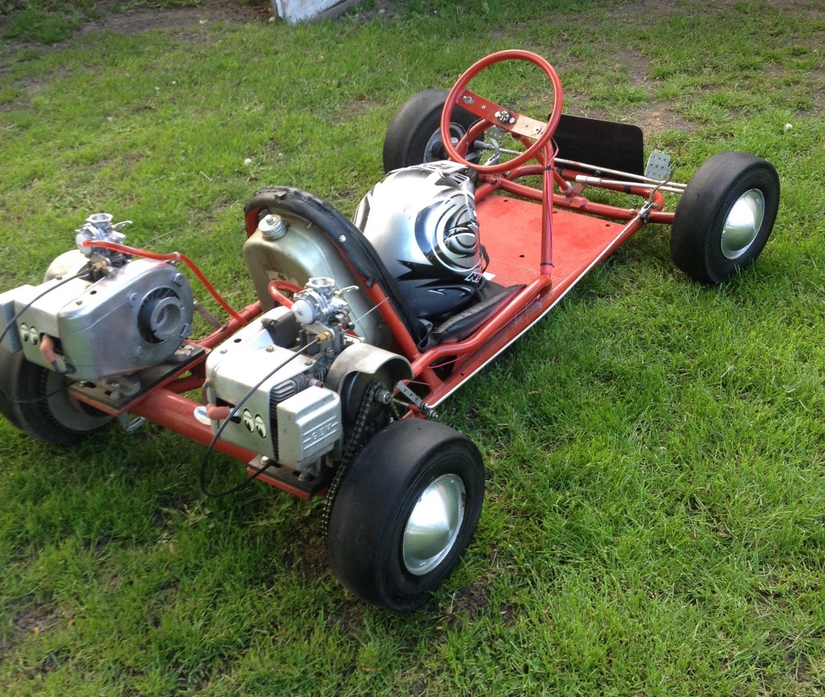

    image.jpeg image.jpeg I have the newer stuff. It's 4 years old also use on my racing twin go kart this new stuff is made for gas or fuel. The older stuff goes bad quick No problems still soft as it came new
