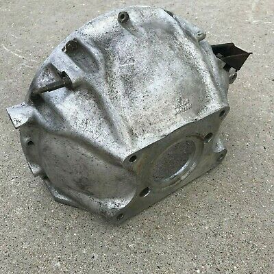

  13. studebakerjoe
    Joined: Jul 7, 2015
    Posts: 1,218
    studebakerjoe
    s-l400 (3).jpg Might have a chance modifying this if you really have to have the Hydramatic. Its a Rolls Royce bellhousing.

  15. squirrel
    Joined: Sep 23, 2004
    Posts: 60,373
    squirrel
    I think he meant to cut up the original Buick bellhousing,a nd the Rolls bellhousing,a nd weld them together?
  16. studebakerjoe
    Joined: Jul 7, 2015
    Posts: 1,218
    studebakerjoe
    Squirrel, Yes something along those lines. First put the bellhousing against the block and see if anything matches up or is close. It may be possible to add some material to allow holes to bill drilled where needed. Or as you say possibly welding part of one to the other.
  17. Mr48chev
    Joined: Dec 28, 2007
    Posts: 36,247
    Mr48chev
    That might be viable but in the long run is it worth it? Op hasn't stated exactly why he wants to run that particular transmission
    The best thing would be input from the guys in the UK who run the Rover version of those in their rods a lot. They may have the best answer.
