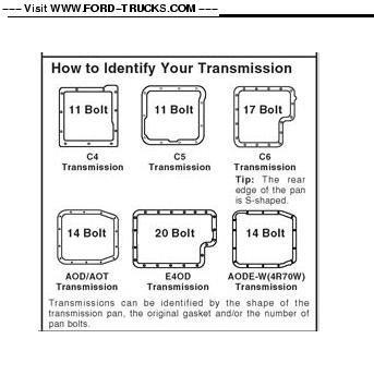

    This might help.
  11. squirrel
    Joined: Sep 23, 2004
    Posts: 59,236
    squirrel
    might help to have the older ones too
    chevyfordman, Jokester and jaracer like this.
