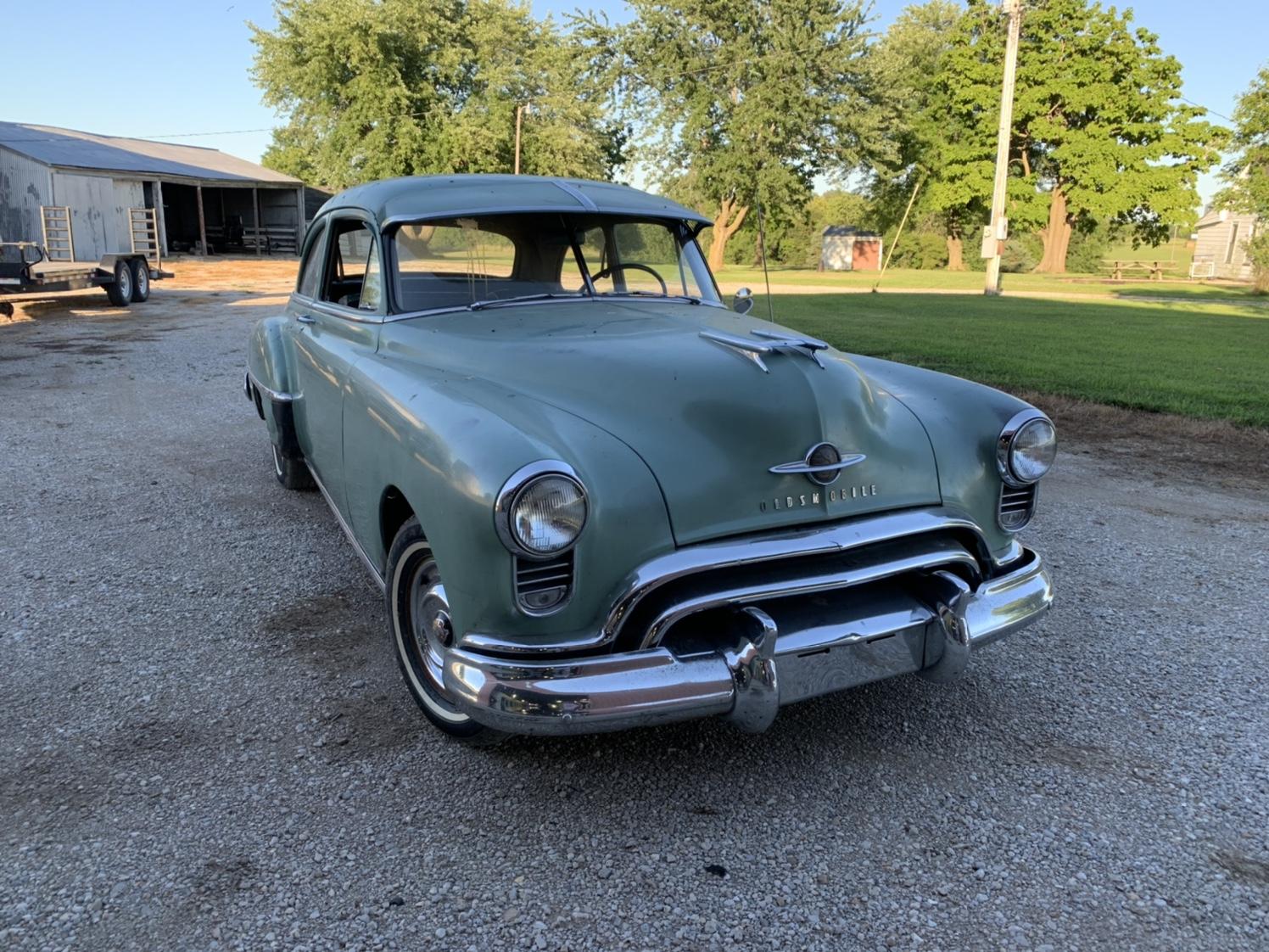

    Have a 50 Olds series 76 with a flathead six and a slush box automatic transmission. What type of transmission fluid will be compatible?[​IMG]

    Original spec was called Type A, which was superseded by Dexron. There has been several versions of Dexron over the years, but any Dexron III/Mercon labeled will work good as Type A replacement. You won't find any earlier Dexron versions than Dex III at the store. I would not use a higher version because then you start getting into synthetics and lower viscosity, which would likely increase your leaking.

    An early Hydro. ain't a slush box... ;)
    I ran mine on Dexron for a few years after I rebuilt it and then changed it out to Type F. Worked well with either one.
