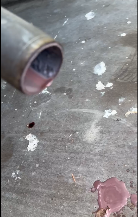

    Greetings,
    I have a 1961 Plymouth Wagon with a 318 v8 automatic. Recently it started smoking white smoke out the exhaust. I pressure tested the cooling system and found it holds pressure. The compression test indicated an average of 145 psi Wide open throttle plugs removed.
    The other day I started it and it was smoking really bad. I took it around the block and when I got back I noticed a puddle of Transmission Fluid on the garage floor.
    So.... I jacked up the car and checked out the transmission with no leaks to be found. But then I noticed Red fluid leaking out of the muffler. I started it back up and to my disbelief There is transmission dripping out of the tail pipe.
    I looked all over and I can not find anything connecting the transmission to the Engine. The only possible connection is the transmission cooler via the radiator. You would think the radiator would be a milkshake. Its a beautiful green.
    So I ask you. What is causing this strange phenomena?? 20250430_123246[2].jpg

    looks like rusty water to me.

    Bentrodder Well thats the first thing I thought of but then the bright red fluid leaking from the muffler and dripping red tailpipe all the way down the street. Its not water or anti-freeze.

  21. That's trans fluid emulsified with water. Possibly with a bit of aluminum but that's definitely trans fluid and water emulsified. Not carbonized. WTF if you find out please post here. I have never seen this before.

    It does look like ATF mixed with a bit of water. I can't picture any mechanical way that AFT is getting into the exhaust from that cast iron Torque flight transmission. The ATF has to be getting into the exhaust by means of a hole or an exhaust joint in the exhaust system caused by a leak from the transmission.
