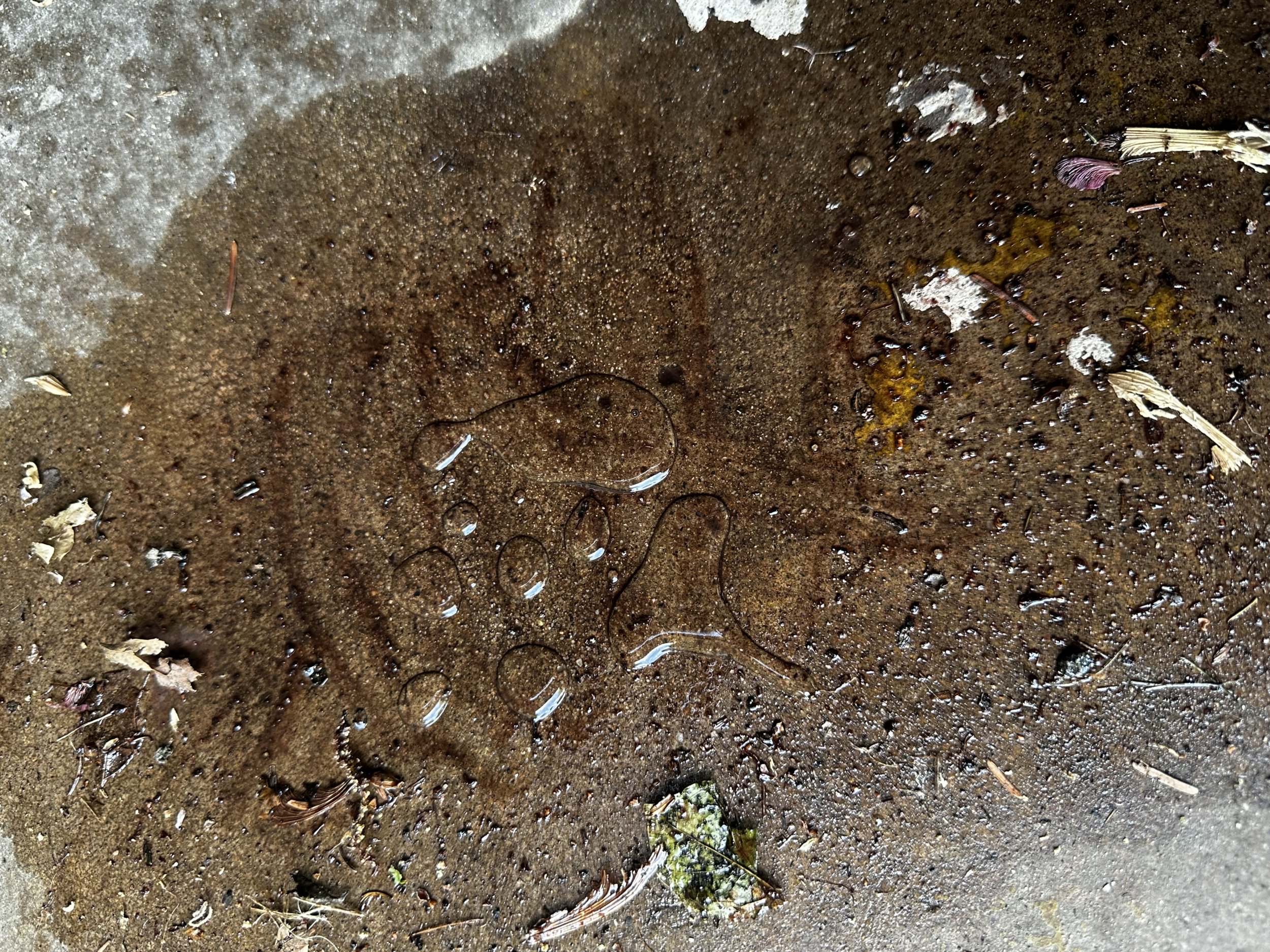

    yeah, it's red in color but have you felt it between your fingers to see if it's actually lubricant based(trans fluid) or just rusty water(condensation)?

    Anthony, an easy way to tell is get a sample of the fluid and drop it in water. If it blends and mixes, it is condensation and/or antifreeze based. If it floats, it's an oil or a petroleum-based fluid.
  3. Well the pain in the *** way but definitive is, start removing parts of the exhaust system from the back going forward. Check each part and see where the red residue is at. If you get all the way to the exhaust manifold / header and still find it, you will have to check the cyl head. If you make your way up the exhaust system and find where it is NOT then you have it narrowed down to well a close spot. Pain in the *** but either it is inside the engine or in the external exhaust system. Sounds like fun.

    Just to clarify a few things. Trans fluid is disappearing quickly and a red unburned oil comes out the tail pipe. Motor oil and coolant remain clean. I pulled the plugs yesterday and they looked good.
    I gave up and dropped it off with my transmission guy just now. It was not smoking when I left, I believe because the exhaust system was cool. a mile down the road it was billowing smoke. when I arrived at the shop it had burned off and was not smoking. 5 minutes later when he pulled it in it was smoking again. Even he seemed to think what its doing is impossible.

    I got the car back from my trans guy and it's running great again. No smoke or oil from the tail pipe. He did nothing but run it some. He thinks someone played a prank on me and filled the muffler with some red oil. I find it hard to believe. They would have had to get at it during the brief times it sat in my driveway and they would have needed a pump to get it to the muffler. A lot of smoke and oil came out so it was not a small amount. I'm going to keep it in the garage and take it to a few cruises and see what happens.
