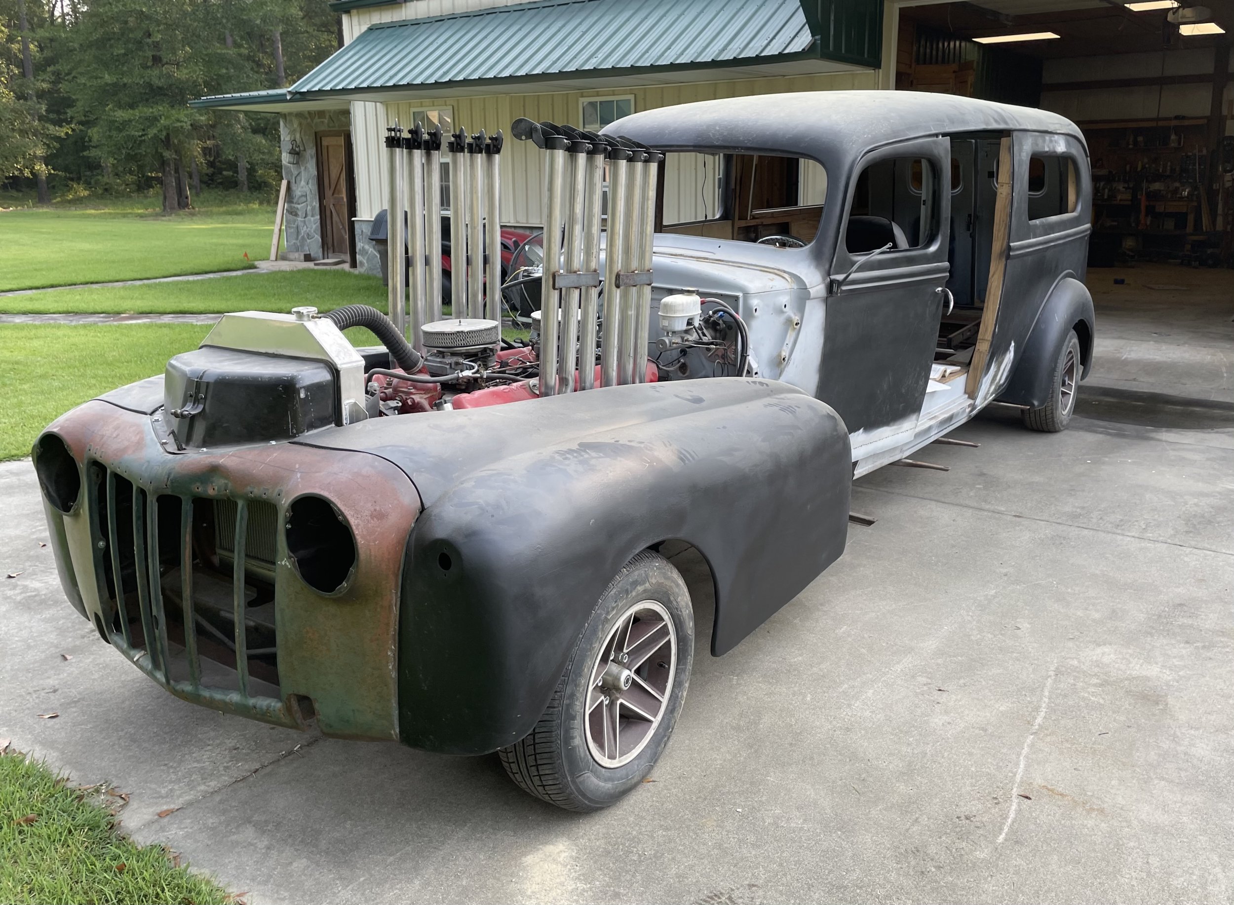

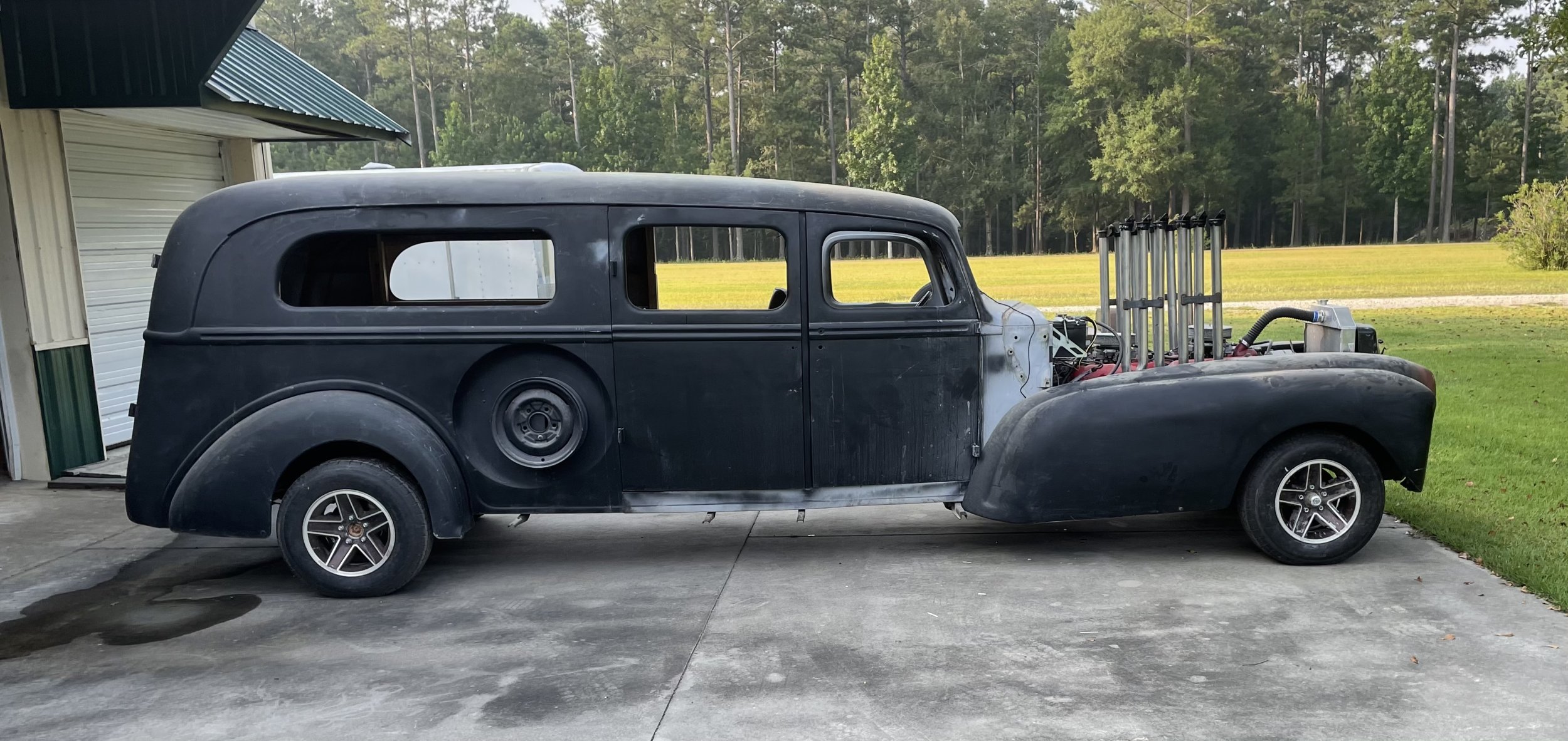

    I have a th400 trans that lost park and reverse while setting. This is a new rebuild. It is in my Frankenhe****. Any ideas of where I should look? Rather frustrating.
