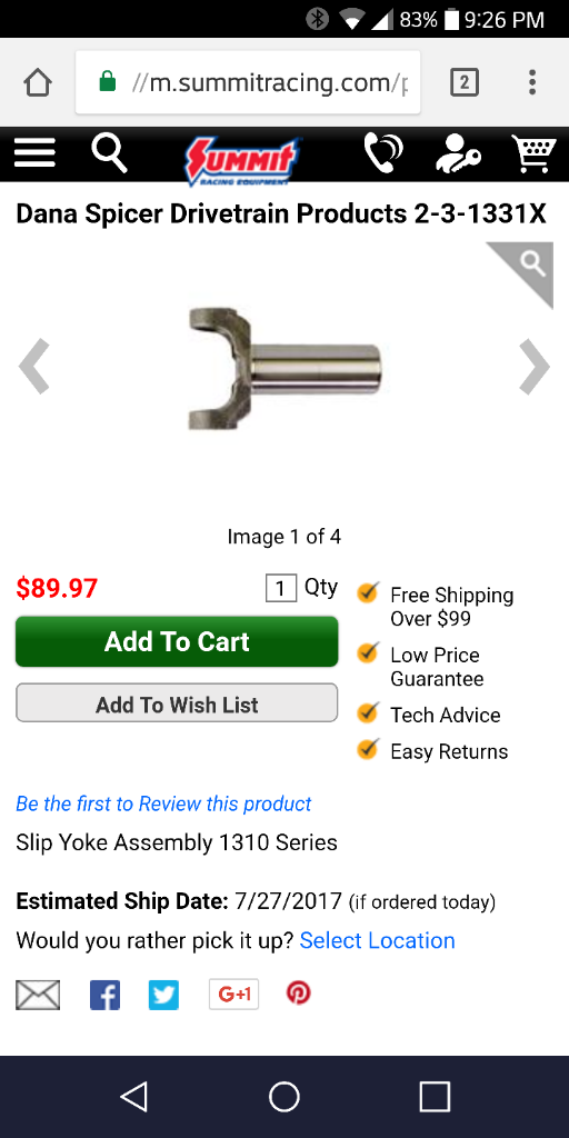

    I did order the 1331x yoke, but it measures the 1.502. So, I'm going to contact dana tomorrow and see if it is and oversight, or i need to have it turned down by a local shop. I still would like to know the id of the tail shaft bushing so as to know how far to turn it down to include oil clearance[​IMG]

    After contacting dana this morning, they said their spec for that part are 1.502 - 1.504. I didn't see that anywhere on their website, but oh well. I'm taking it to have it cut down today. How far down should i have it cut? Back to1.5 or to 1.498 like the old one?
