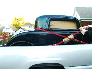

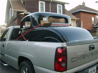

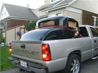

    Brookville 32 Roadster on its shipping pallet in the back of my 04 Silverado shortbed. No problems at all!

    That sure is a great sight. Thanks Sgt. Grumpy.

    as shown above they fit and look cool too, Chevy, with a skid
