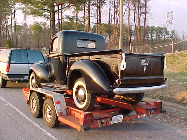

    Any questions?
    Also works for 1936 Ford cabriolets.;):D

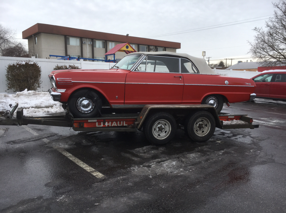

    Not a hot rod by a long shot but this little Nova followed me home from Spokane on a U-Haul trailer. Trailered like a charm. 7 hours, most at freeway speeds.

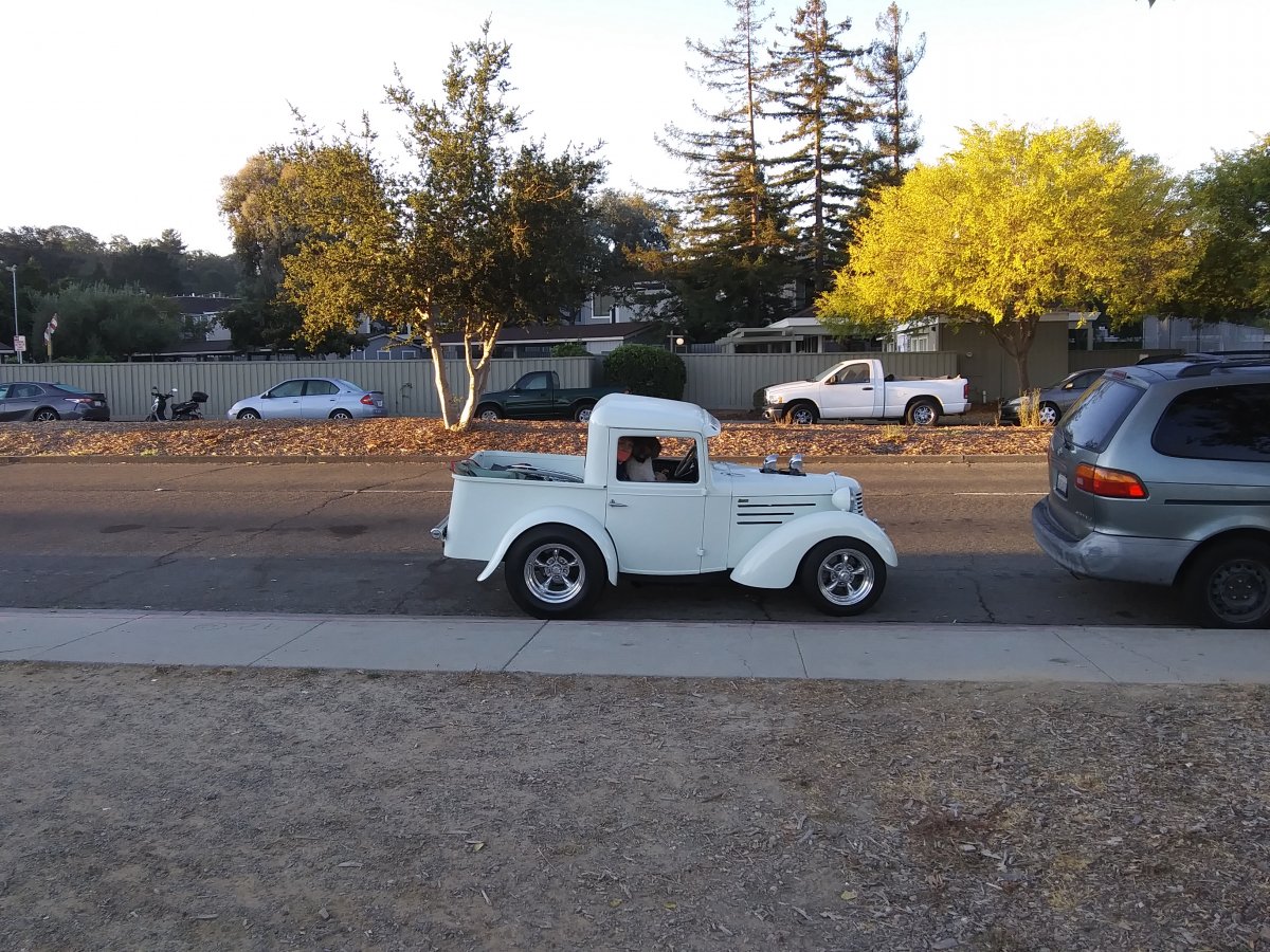

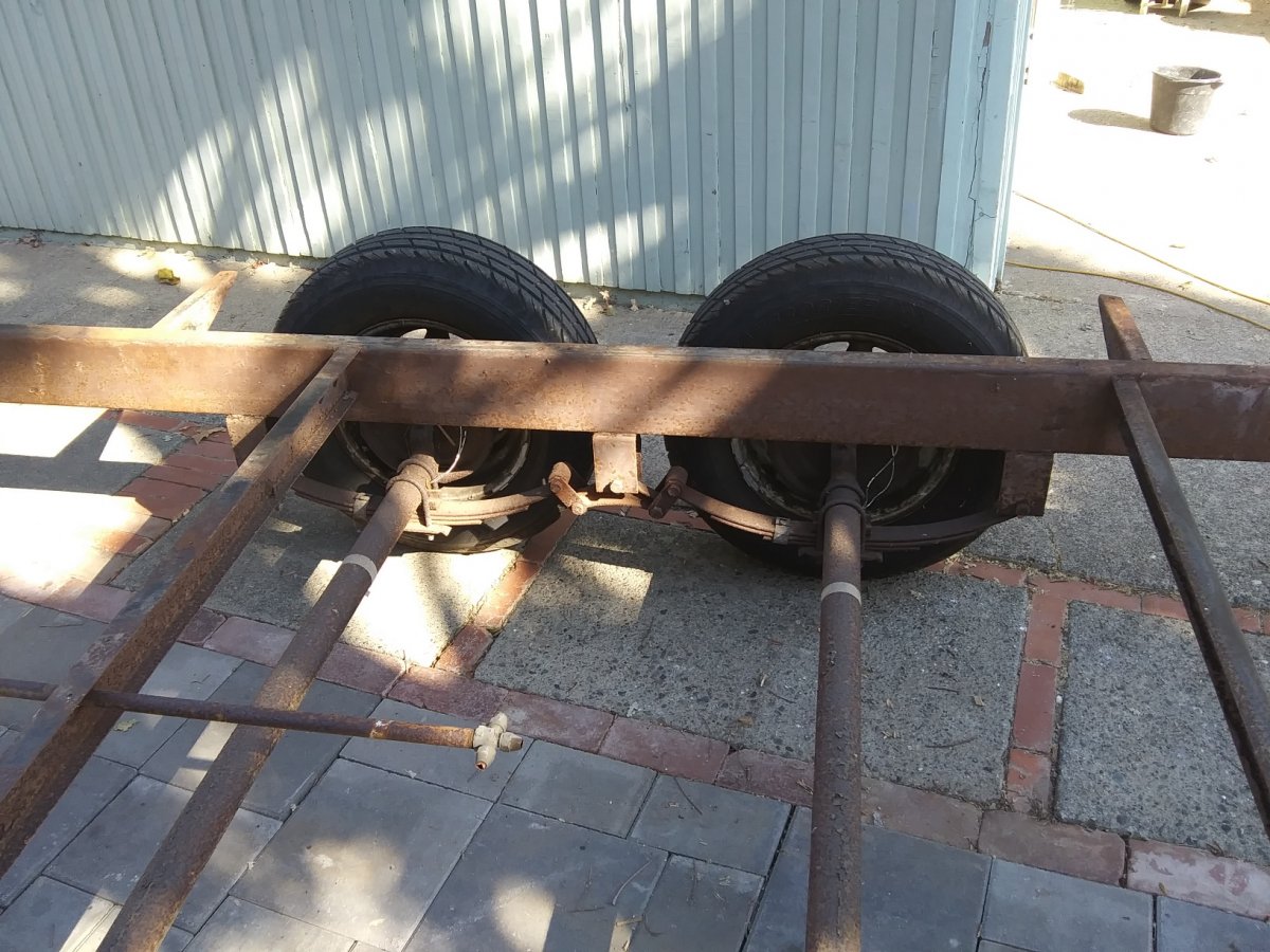

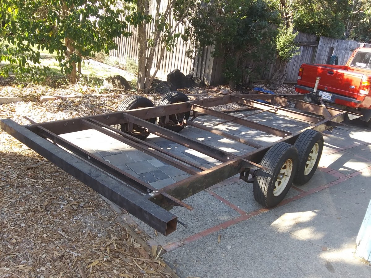

    Quick question while I have your trailer ears. I just bought this for $200 with new tires, registered, was a camper. I want to use it to tow my little Bantam if we take it somewhere distant. Want to lower it down. It looks like I could just drill new spring holes. Right now there's 4.5 inches between the U bolts and the frame. The leaf springs can go about 2 inches before they are dead flat. So you figure I could go up 2 inches on the holes? Figure 2,000lb. load with the Bantam, plywood and maybe a tool box.

    Personally I'd set the trailer up with everything first and then worry about ride height. If you lower the trailer too much, every time you pull into a servo (gas station), the rear of the trailer is going to catch on the kerb.
    Also, I guarantee you will eventually add more gear to the trailer and therefore more weight so it will naturally sit lower.

    Good point, thanks! Getting ahead of myself..
    If I do drill new holes I'll leave the brackets long.
