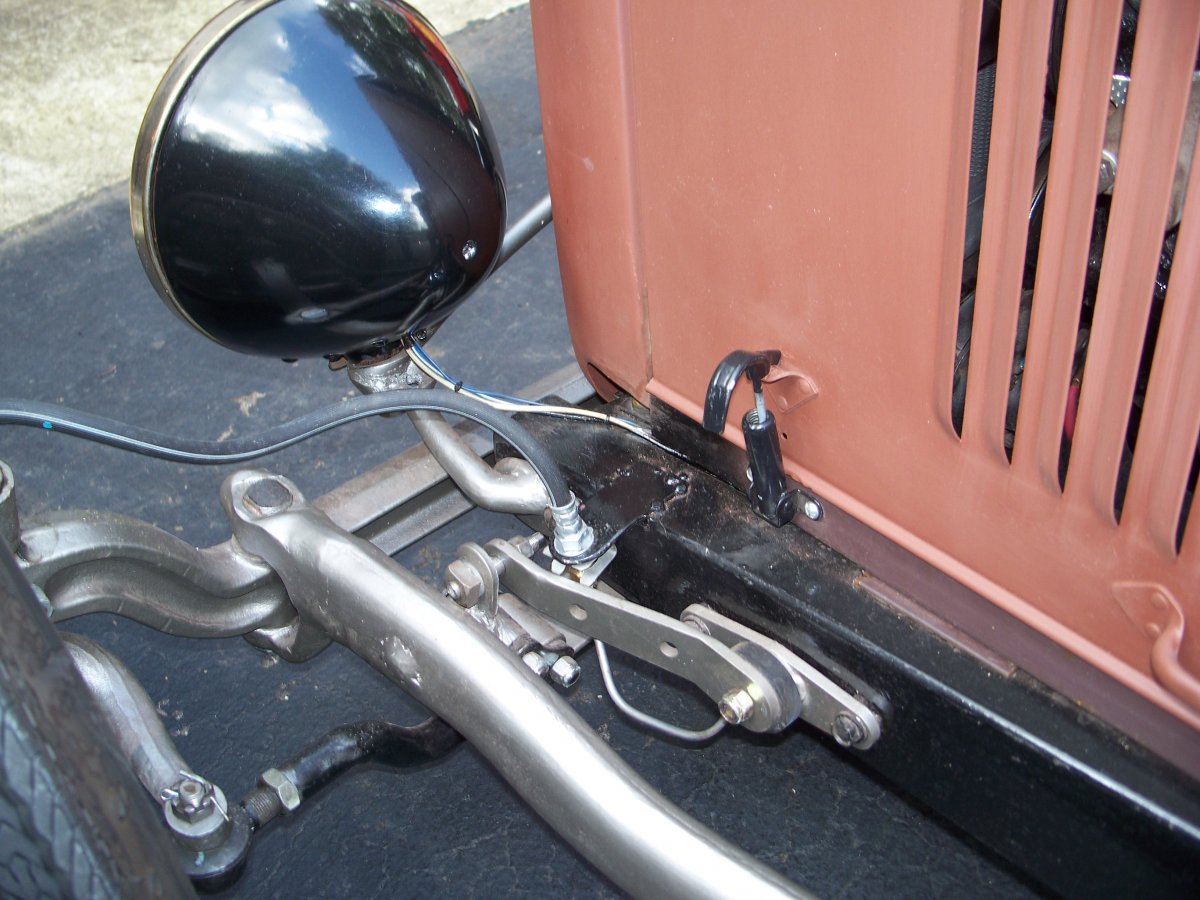

    Posts: 11,618

    'going low' would be a long way down...below wishbone and frame levels.
