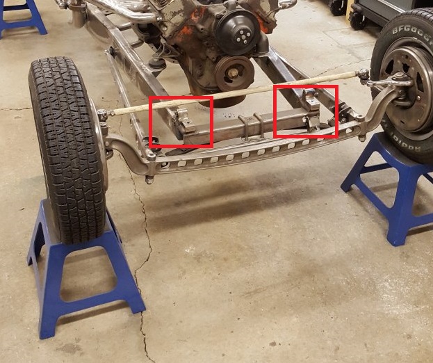

    ...and let us know how a bent tie rod makes it even remotely possible to set toe.
    You have the tie rod in the wrong place. It's time to admit it.

    I have built bent tie rods with a turnbuckle in the middle. He could do this, carefully, and not even really disturb the chrome.

    Of course it is possible. Probably just a whole lot more time consuming at worst. Everything on a hot rod is a compromise between practical and our own personal aesthetic.

    Use an adjusting sleeve from a late model like a '40, shorten and bore the end of the tie rod to 11/16", then turn down and weld in a short section of the threaded end from late drag link.
    On the other hand, if you can swing the bent tie rod; it is probably cleaner looking to adjust it as you described above.

    You've never aligned a front end by what you just said about turning the ends in the stationary rod. I thought about not saying anything in the first place, but a few viewers here think your front end is so cool looking. Why let them copy what you are doing? Maybe I should have? Oh, I'm not going back to look at the pics, but as I recall, your scrub radius is way off too. ;).
    This sure won't go over good, but I p***ed ASE certification in Front Ends and Brakes back in the 70s, so don't waste words saying you can adjust toe by dropping one end and giving one turn..."it don't work". Or, you don't have believe that...just go try it...and see. When you are adjusting toe properly, to true specs, you turn the original style rod setup just a few degrees of rotation as you get to final spec.
    Sure, I knew about sleeves...but, you guys are missing the main point. When you steer off the traditional course, or even the common sense course in building a beam car, you can end up with a messy looking setup. Who knows if that sleeve on one end is just enough fatter with it's band clamps or jamb nuts, to now hit the top of that painted framerail on hard turns when side-hilling? We don't know yet, do we?

    You have lost touch with physics. You are stubborn and unwilling to actually try setting toe with just screwing ONE rod end. You seem to be delusional in saying you can set toe because it's fine thread, and seem unaware that one thread at the length of a steering arm will move the toe a huge amount at the tread of the tires. GO TRY IT !
    I said your scrub RADIUS was off..not scrub LINE....see? you are just not aware of what's going on.
    Ok, tried and tested or proven? Look at the last pic above...their scrub radius is wrong as well, but if I recall your pics correctly, yours is off even more...but who cares, Right?... if the sheeple buy it as "tested" or "done all the time"?...
    You admitted in this last post that you copied somebody's else's work...that is why I bring this all up, as a couple of others here have been thinking yours is great and will try to copy your "copied mistakes".

    Well a solution to the tie rod situation has been resolved.
    I decided to look into @gimpyshotrods solution with the double adjuster for the center of my tie rod.
    While I could have set my toe in without it having it will make things much easier.
    Since I can’t get an 11/16” double adjuster, (they’re just not made) I ordered up one in 5/8-18 stainless (with stainless jam nuts) and ordered some Stainless 7/8 x .156 wall tie rod tubing.
    I also ordered a pair of polished stainless tie rod ends in 5/8-18 thread from So-Cal.

    So in the end I’ll have my offset tie rod and have easy toe in adjustment.
    I’ll also have clearance from the fan and room for the shroud I’ll fab too.

    ^^^Total nonsense, don't anyone listen to this foolishness or try to copy this "Kulture style"
    aka "rat rod" front end.
    Look at the never ending chain reaction of making changes due to not running the tie rod under the car where it belongs.
    He has no idea that with a scrub radius error, combined with excessive caster which is most likely at the sheeple setting of 7 or 8, that when he hits a pothole with one wheel, that "pre-bent" tie rod WILL flex. When you hit a pot hole, that wheel will get forced outwards due to the scrub radius error. Then that spindle arm tries to shove the tie rod to the other side, and if the caster is heavy, that other wheel resists turning more than at minimal caster...so, the tie rod (one that is bent), will definitely flex.
    And guess where the most of the flex will happen? ...at the middle of any tie rod, where that "Band-Aid" center adjuster is planned. You are building a complicated mess, just by insisting you have a "proven/or accepted design".
    As many of you hambers know, there is no one single thing that causes death wobble, as it is a combination of things not being correct, and this build is heading in that direction.
