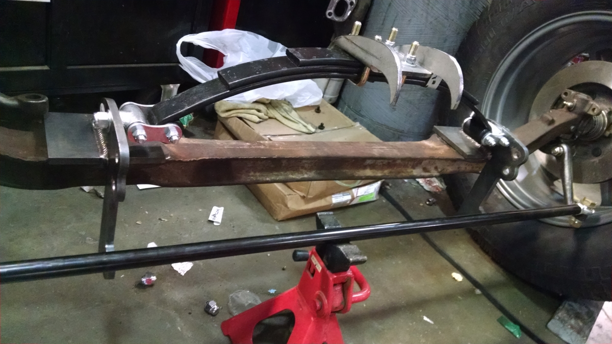

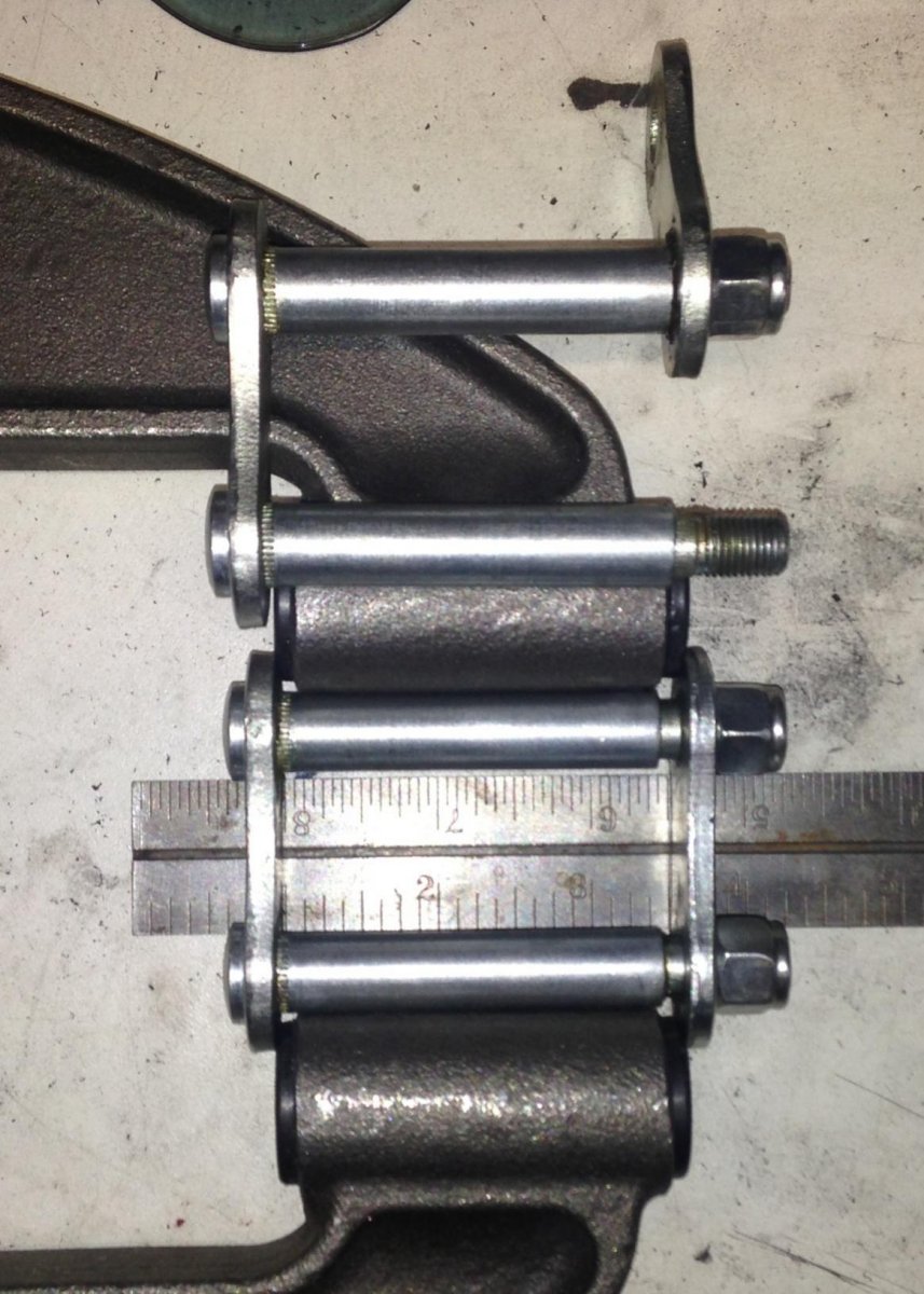

  19. weemark
    Joined: Sep 1, 2002
    Posts: 830
    weemark
    from scotland
    those bushes don't go with those shackles - those shackles should only be used with a tube type bush not the type you have in.

    Ned Ludd likes this.
  21. That stuff came right out the same package. Take it up with the manufacture and their tech Dept. Maybe you can educate them I could not. Their absolute best solution was to not tighten the nuts.
  22. Mike Colemire
    Joined: May 18, 2013
    Posts: 1,431
    Mike Colemire
    I don't see how the spring perch holds up when it's set up like the one in the upper pic. I also think that a trailer spring would jar your teeth loose. I've seen several spring brackets welded out front like that but it looks like over time it would develop stress cracks .

    weemark
    from scotland
    that doesn't surprise me they told you to do that, none of the shackles out there seem like they fit very well. I don't know how they can get something so simple so wrong...
  24. There are units that fit and work.
    That supplier est 194x can kiss my ***. I buy a lot of parts and refuse to spend a nickel on their stuff.

  26. alanp561
    Joined: Oct 1, 2017
    Posts: 5,543
    alanp561
    It appears as if you went down to your local Tractor Supply Company or someone else who sell trailer springs. IMO if you overload one side of the main spring, (rebound from a pothole, speed bump), there is a distinct possibility that the spring will bend where the squared off end of the second spring lays on top of the main. Also, there is little chance of adjusting the ride with those springs. There has to be a better solution that that.

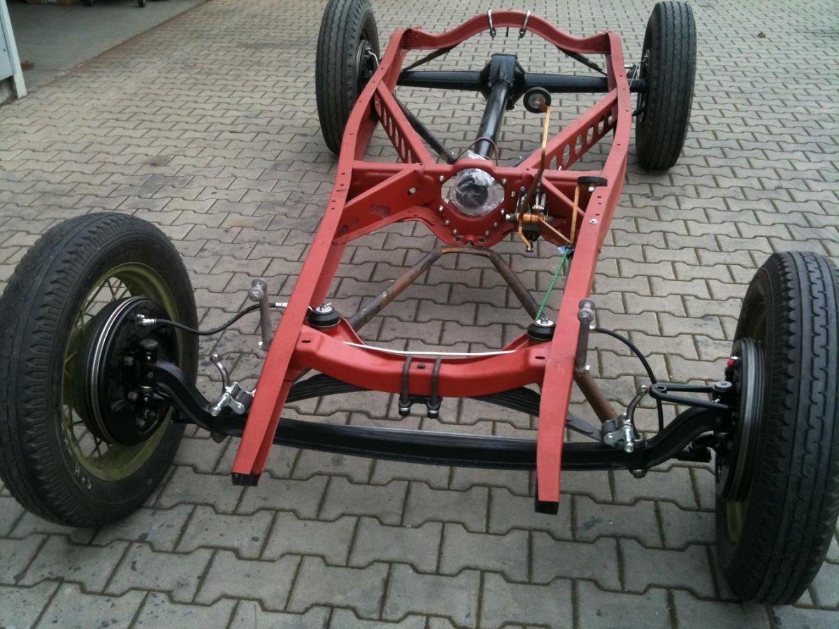

  28. fiftyv8
    Joined: Mar 11, 2007
    Posts: 5,401
    fiftyv8
    from CO & WA
    Here is generally what comes to mind when we think of a hot rod front transverse spring setup.
    I choose my words carefully as I acknowledge that there are other stock factory versions along the same lines.
    I am talking for now about stock configuration.
    I'm sure most would agree that the Model A Ford front cross member has been a popular choice for many years.
    Other styles can be posted later.
    Just an appetiser for now...

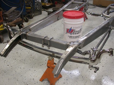

  30. fiftyv8
    Posts: 5,401
    fiftyv8
    from CO & WA
    Front1.jpg The next most recognisable front transverse spring mounting method is what I know as the suicide front end.
    The mount point sits forward of the improvised cross member which is usually made from substantial sized round tube/pipe and the attachment plate canter levers from the tube.
    Probably, more in the past, but I recall many attempts to make attractive covers to hide the U bolts by using cut down polished finned aluminum valve covers and similar.
    In the early days, this style attachment was likely to be found on T buckets.
