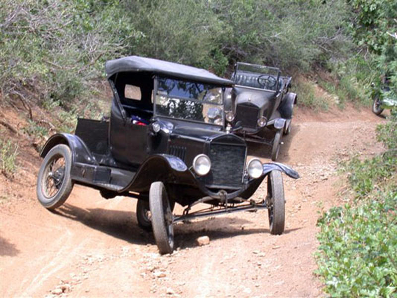

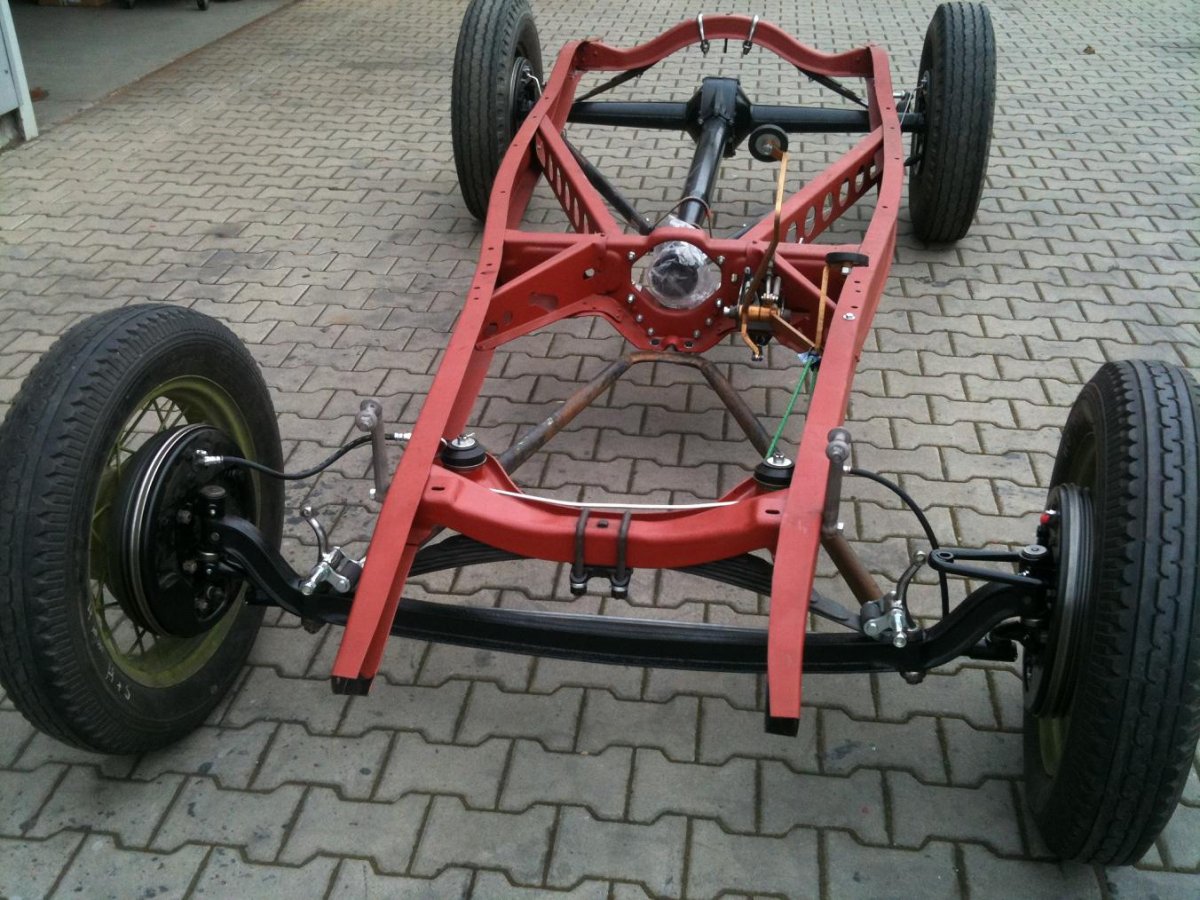

    A little something I found during some of my research, probably qualifies to be here.
    Just goes to show what a transverse spring can do when called upon.
    Boy, look at that front transverse spring working out...
    clem, Jet96, alanp561 and 1 other person like this.
  8. ago
    Joined: Oct 12, 2005
    Posts: 2,198
    ago
    from pgh. pa.
    Those old cars were made to twist and bend. You have seen the original Ford I beam axle twisted like a
    screw. Henry Ford use alloy steel in critical parts. Other OEMs not so much.
    31Vicky with a hemi likes this.
  9. Ned Ludd
    Joined: May 15, 2009
    Posts: 5,512
    Ned Ludd
    Yes: the spring deflections are quite visible in the pic. But there's less twisting and bending than you might think. Simple pivoting on the shackles probably allows for the first 3½° of roll displacement.

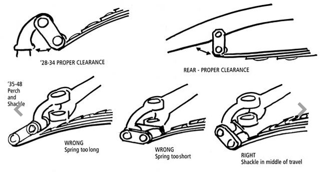

  11. This is a perfect visaual explation of the correct preload tension.
    Notice how the spring is actually pulling on the shackles into a nearly horizontal position. The weight of the ch***is alone is not enough to get the spring to move much.
    That is how Henry designed it
    This next one is an aftermarket spring and after market axle.
    It's pretty close to correct but the spring is just a touch too long- probably because of the revered eyes
    These are great examples of springs that are too long,
    Notice how the shackles are far away from horizontal
    Both aftermarket, both will ride too high, both will ride hard,
    Both will have the shackles crashing into the perches.
    Seeing this condition at either stage is a great place to stop the
    build and get the right spring.
    These two are great examples of exactly what you do not want.
    Be cautious about the bogus springs out there. The first clue is that you can install it without spreading or fighting it too much,,, there should be quite a bit of preload tension upon install
    fiftyv8 likes this.

    Here is a little something that has a place here.
    Although no explanation regarding status of what weight or preload is being applied as mentioned earlier by 31Vicky.
    Picture and diagrams always make things more interesting.
  18. The pictures I referenced are just ch***is weight, clearly.
    The drawings are correct at full weight of a completed vehicle
    It's confusing because the free arch height and loaded arch height are different, and as the arch height gets loaded with weight the spring length changes.
    That 45* shackle angle results only when all the following are correct.
    1 spring length
    2 spring rate and vehicle weight match
    3 preload tension is correct.
    Bonus points if the loaded arch height is giving you the ride height you want.
    If one of those 3 are off you'll not have the 45* angle.
    The angle isn't the target per see it's the result of getting it right.

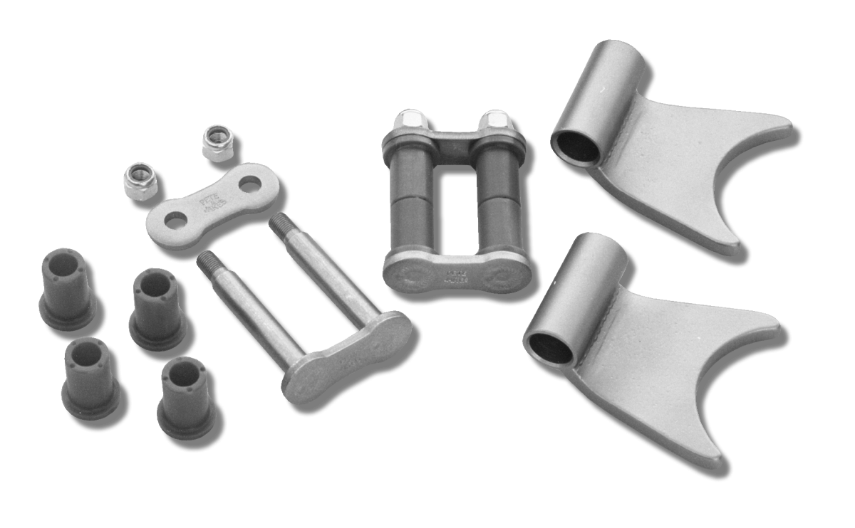

    Either way seems to work fine, but there is still a little science in it when it comes to attaching original radius rod or weld attachments to a non stock diff.
    Thought needs to be given to center to center spacing and matching the correct spring to that distance.
    Having the wrong spring out back can see a car running with either a too hard or too soft ride and without enough preload quite sloppy in the handling department.
