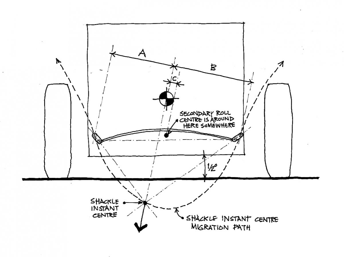

  7. Ned Ludd
    Joined: May 15, 2009
    Posts: 5,513
    Ned Ludd
    That geometric roll self-correction:
    An early Ford transverse leaf spring setup without a lateral locating device doesn't simply roll about a roll centre like a conventional suspension system. The shackles allow up to about 3½° of self-correcting geometric roll which is not resisted by the springs. This must have been very useful on some of the bad roads Fords might have seen when new, because it would allow almost 7° of angular misalignment between the front and rear axles without twisting the frame. That's equal to about 3" bumps at diagonally opposite wheels, or a 6" bump at one wheel. It made the very light T and A frames practical under such adverse conditions.
    That was all about going slowly in a straight line on very bad roads, not about going around corners fast. If anyone has done any ****ysis of what this means at the theoretical limit of lateral acceleration and written it down, I haven't seen it.
    The first principle in all this is that in order for this arrangement to be self-correcting, as it demonstrably is, the system has to reach equilibrium when the line of the resultant force acting at the centre of gravity p***es through the shackle instant centre. At rest that is straight down: so push a parked Model A over sideways, and it will rock back upright. But the force isn't straight down when cornering. In the diagram the car is shown cornering at about 0.2g, resulting in a geometric roll of ½° imparted by the shackles, before the spring is even a factor.
    You'll see that as the shackles move, the instant centre they describe moves as well, tracing a predictable path with an inverted bell shape. That means that the geometric roll angle at any given lateral acceleration is likewise predictable. (Obviously there are variables like CG height, amount of axle drop, etc.) Because the path rises higher than the axle at both ends there is a geometric roll angle even for the theoretical limit of lateral acceleration, i.e. the point where it's no good adding tyre adhesion because the car will fall over anyway. In the example that'll be around 1.6g: and that's ***uming there is enough clearance for the shackles to adopt the corresponding positions.
    We know that early Fords don't roll a mere 2.1° at 1.6g, and the diagram is consistent with a lot of elastic roll being added on top of the geometric roll. Because A<B, we can see that the spring is loaded asymmetrically, and that is going to result in a roll moment. In different terms, the resultant force acting at the CG is offset by distance C from the elastic roll centre, which is at the middle of the spring at the middle of the installed arch height. In practice, the spring resists most of the total roll motion, but not all of it.
    But here is the thing: the greater the roll stiffness, the smaller the roll angle at any given lateral acceleration, the smaller the component of total roll represented by elastic roll. So, while geometric roll isn't really a factor on a softly-sprung car which would roll alarmingly if it were capable of pulling more than 0.25g, it starts to become a factor once we get more ambitious.
    So what happens when we introduce a lateral locating device, like a Panhard bar? Now the car is constrained to roll about the roll centre as defined by the lateral locating device. The spring still wants to rotate about the shackle instant centre, and the only way the bind can be resolved is by flexing the spring. In other words, the geometric roll is converted into a certain amount of additional elastic roll, which is effectively resisted by the spring.
    In the case of a Panhard bar the roll centre will be slightly below the elastic roll centre defined by the spring, and a fair distance away from the shackle instant centre. But let's say we have a lateral locating device which places the roll centre at the shackle instant centre? That's possible with a Mumford linkage, for instance, at least initially (i.e. at 0° roll.) Then there would be no bind between the roll constrained by the roll centre and the geometric roll due to the shackles, and no geometric roll converted into elastic roll. So, if we want to make the most effective use of the spring in resisting roll, the distance between the roll centre and the shackle instant centre seems to be an important factor. And if we're putting our roll centre somewhere in the first 12" above the road, we'll want to put the shackle instant centre as far away from it as we can, like 12' below the road. And that corresponds to shackles nearer vertical than diagonal.
    Splitting hairs? Perhaps. Bottom line, I'd say, is that as soon as there is a lateral locating device the shackle angle is more to be determined by practicalities like eye-to-perch clearance than anything else.

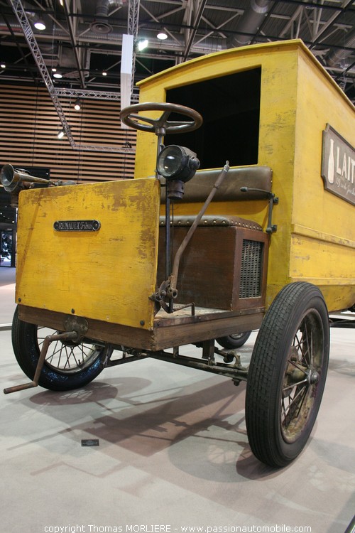

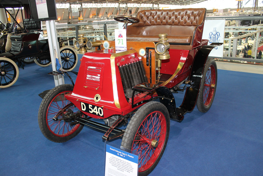

    I have no intention of making this thread my life's work, but in doing a little searching on the internet, I have discovered Renault seems to have had almost identical transverse spring suspension system used in their 1901 milk cart.
    there are limited pic's but using ones imagination it looks quite like a Model T transverse spring set up including axles.
    Ned Ludd likes this.

  15. RICH B
    Joined: Feb 7, 2007
    Posts: 5,958
    RICH B
    Don't think that 1901 truck is a real deal, as those are Model T Ford axles underneath it.
  16. fiftyv8
    Joined: Mar 11, 2007
    Posts: 5,401
    fiftyv8
    from CO & WA
    The Renault truck was made in 1901 yet Ford did not produce its first car until 1903, so this is why I was wondering if Ford had some how acquired copy right from some other maker to produce this kind of suspension.
    Maybe Ford was not the designer of this suspension style, but utilised it and made it famous and obviously improved on it over the years.
    I am starting think there must have been some kind of French connection there.
    Look at later years with the French flathead engine blocks.
    Just thinking out loud here...
    Maybe this is evidence of a connection that was offi******ed in later years but arrangements must have been in place much ealier.
    https://en.wikipedia.org/wiki/Ford_SAF

    Those wheels don't look right for 1901 to me. Perhaps Model T parts were used by way of approximation just to get the exhibit vehicle on wheels?

  21. RICH B
    Joined: Feb 7, 2007
    Posts: 5,958
    RICH B
    From what I could see it was a recreation that was displayed at a Renault light commercial vehicle exhibition in 2010.
    If you look at 1901 Renault vehicles, the underpinnings are more buggy like, as you would expect of that era.
  22. fiftyv8
    Posts: 5,401
    fiftyv8
    from CO & WA
    I'm certainly open any ideas or opinions that may help us get to the bottom of where and how these transverse spring can into existence.
    What you suggest RichB is quite plausible as I have a buddy building an even earlier Renault vehicle 1896 and he is cheating with parts that he can find rather than what was actually used.
    I guess I may have been ****ered by the fact that Ford was active over there, albeit slightly later.
    Good point also Ned, I missed that fact.

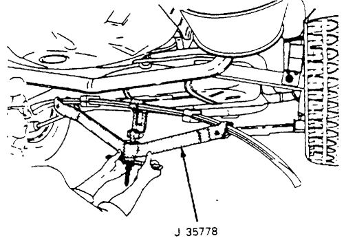

    Is the Ford style transverse spring as we know it, the only setup that has the preload characteristic???
  25. No, but they will be off topic and different but still requires preload on the spring.
    FSM illusionation using the spreader to preload the spring so installation is possible.
    The attachment is without shackles.
    It's a bear of a job to do.
