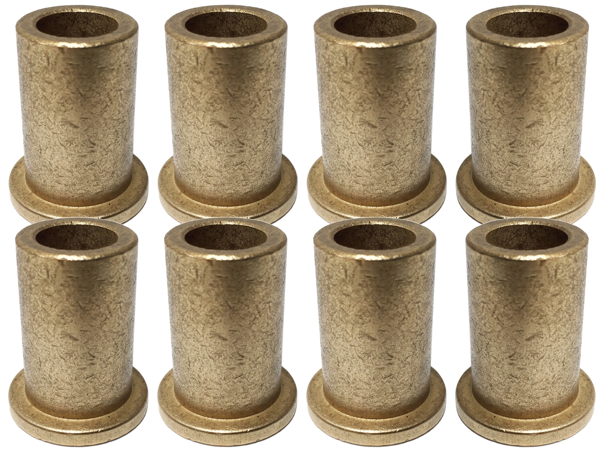

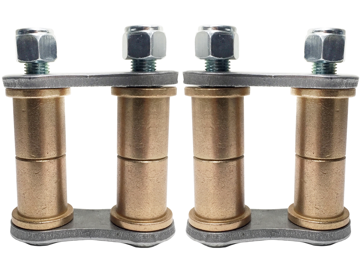

    I haven’t read every post in this thread yet and this may have been mentioned already.
    I don’t have anything really earth shattering to add just something I found and ordered for my Posies front spring for my RPU.
    When I got my shackles I realized that they were equipped with plastic poly bushings.
    I didn’t think that was the best way to go so I ordered up a set of Oilite bronze bushings from Limeworks.
    A better choice I thought.
    https://www.limeworksspeedshop.com/Oil-Lite-Bronze-Shackle-Bushings-p/olb1001.htm

    Good info blue one, I had made reference on a previous inquiry with reference to problematic bushings that the source you have provided would be a once & for all problem resolver. While on a different take will be in contact with Lime Works on an up graded bushing for the 4-bar suspensions as well. Thanks,Ron
