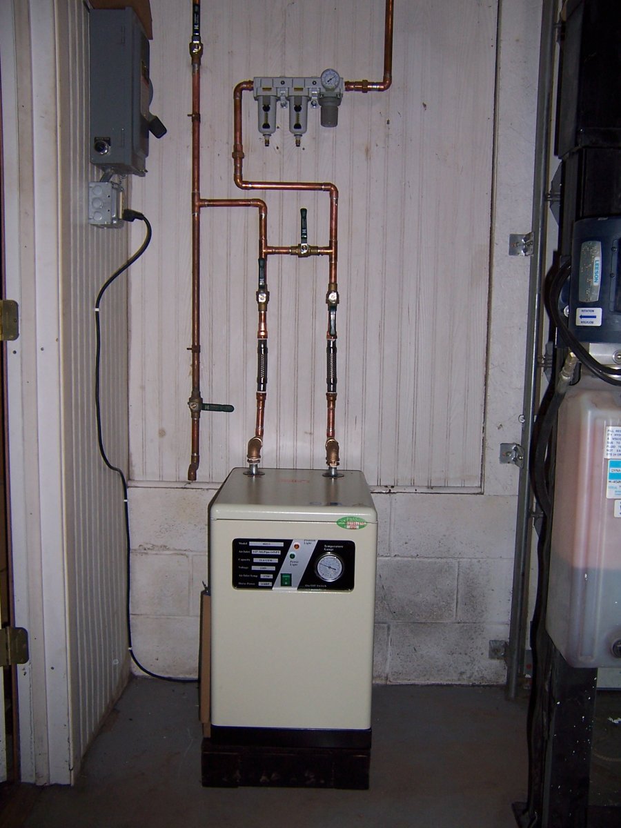

    Best thing I ever did to my air supply set-up was install a cheapie ( less than $425.00 shipped to my door) Harbor Freight electronic air dryer. Been 3 years and 100% trouble free and zero moisture in my system. Helps to have a best friend from High School who's a car guy and 100_2188.JPG master plumber also !
