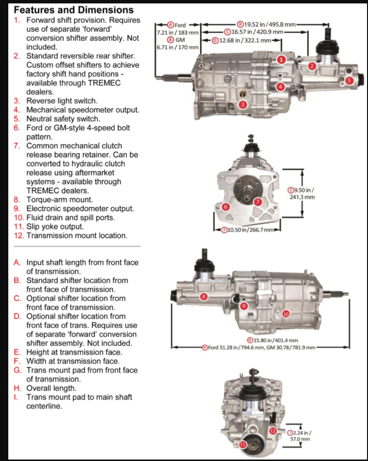

  13. Mr48chev
    Joined: Dec 28, 2007
    Posts: 36,043
    Mr48chev
    Screenshot (1867).png This info off the Tremec site. TKX 5-Speed Rear-Wheel Drive Manual Transmission (tremec.com)
    Feedback from the Chevelle and Pontiac lemans/gto sites are pretty positive. Reflecting what the guys who posted that they have installed one say.
    As far as cost, that is your and only your business. What one pays for a part should be no one else's concern unless the place they are buying it is just flat overpriced. Always shop the part number to see what legit vendor gives the best price overall including shipping.
    X-cpe, bobss396 and 57JoeFoMoPar like this.
