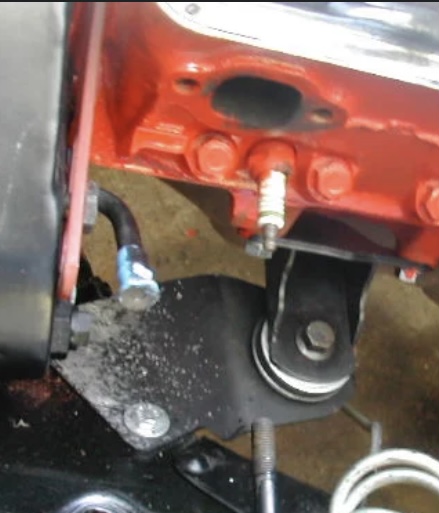

    I use to use side mounts that were standard 1958 and up type. But now I really like this set up from Ch***is Engineering. No longer does one have to drop the engine over then down into place. Also it stay’s in the way Tri-Fives sat on biscuits to begin with. IMG_2797.jpeg
    As for trans cross member. The one I’ve used is no longer out there. Many to be had, just google Tri-Five Chevy transmission cross member.

    I really like the idea of the biscuit mount, seems a little forgiving than the bolt through when you are figuring out where to mount them, also like the idea of dropping the engine straight down on the mount - thanks
