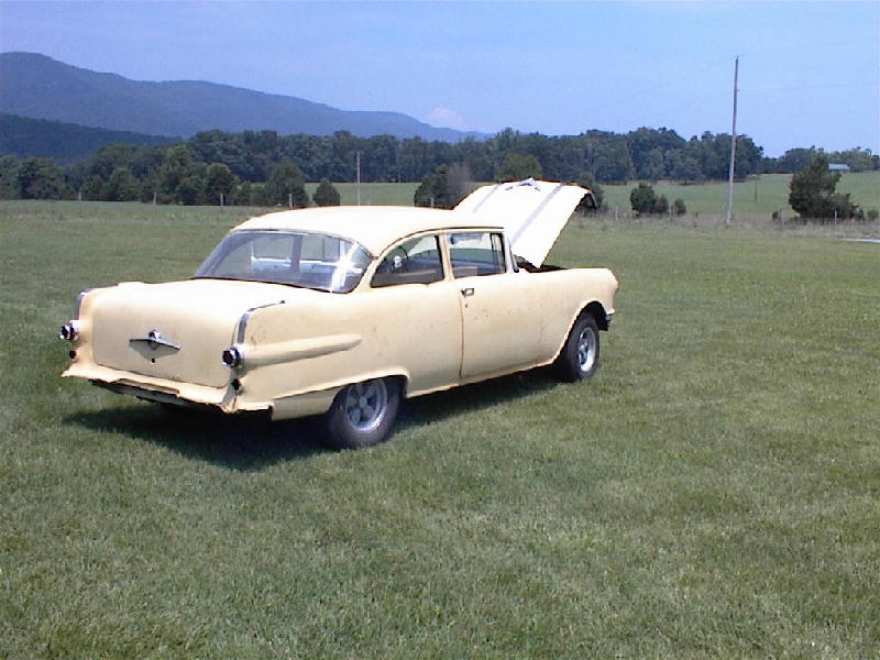

    I just picked up a 55 Pontiac 2dr. I really didn't look at it much before I bought. After it was delivered and unloaded, it was leaning towards the front passenger side. So the A-arm is rotted and the spring is inside the car. Would these A-arms be the same as other tri-5 G.M.'s? My dad suggested make my own spring pocket, if there's enough metal left. If, I go making my own pocket, I would be able to make new pockets for both sides and lower it at same time. Any
    suggestion?
