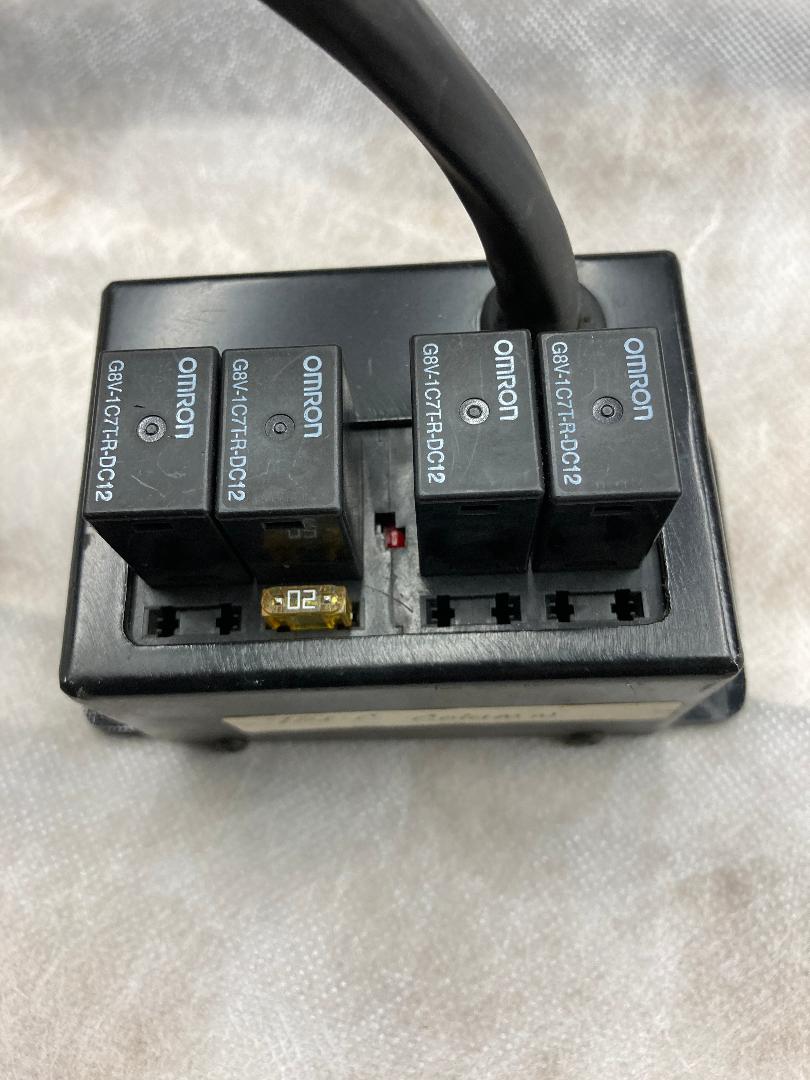

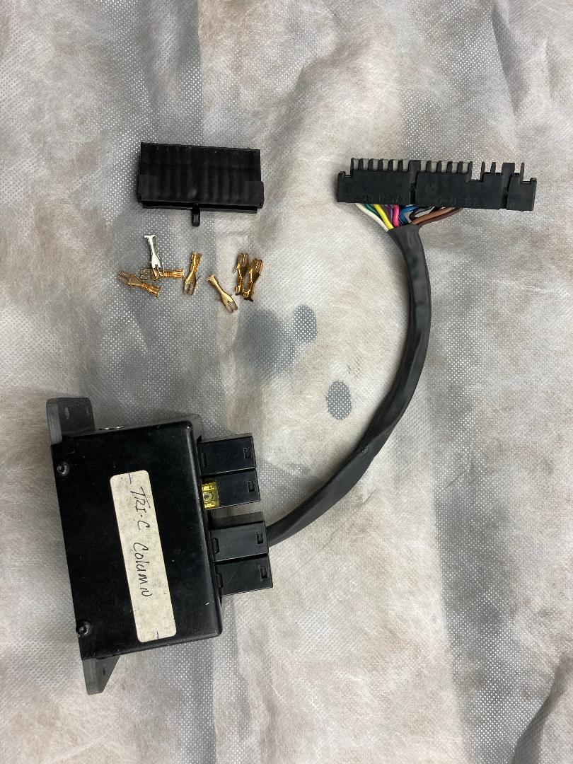

    All the info that came with my Tri-C column
    ColumnOrientation.jpg Instructions.jpg PinOut.jpg RelayBox.jpg RelayAndFuse.jpg relaywiring.jpg

  18. Well, the 'directions' are a bit less than useful.... Plug in the magic box this way and it all works. No mention of the 'magic'.... LOL
    Give me a few days and I'll generate a diagram explaining the 'magic' and options. Meanwhile, you can identify the four wires coming out of the column by checking for continuity. One should be the horn, the wire sticking out of the end of the shaft. The other three will be left, right, and power/common. Turn the switch to left and check for continuity; two wires should read. Turn it to right and check again, the one wire that's used for both sides is incoming power/common.
