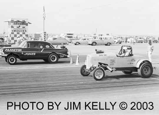

  11. Tri 5's have a great engine location as is. The front spark plug on small block is a good two inches behind the spindle centerline as is.
    You won't get that from any Nova , Camaro or Chevelle. My pop ran his '56 B/G with stock engine location and factory front suspension until '63-'64. He raised the stock upper A-arm mount up and used ball joint spacers for more front travel and made his own "Super Stock" leaf springs out back. This worked very well. Just remove the front pumper, raise the front a little and get the right wheels/tires and you got a great start. The photo here is March Meet '63 Panneton082803.jpg
